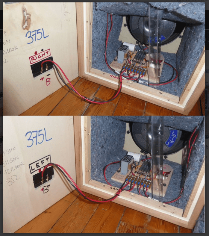

Tubenstein has said that he is considering using his stock 16 AWG cable between crossover and drivers.
I believe he is asking if the cable between the speaker enclosure binding posts and crossover requires to be thicker.
If that is the case, then the answer is "No".
He is probably thinking along the lines that the cable from the speaker binding posts has to carry the sum of the currents drawn by the individual drivers.

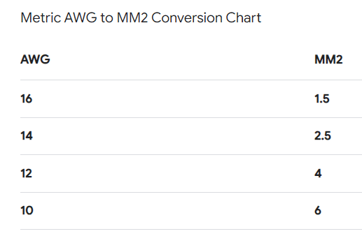

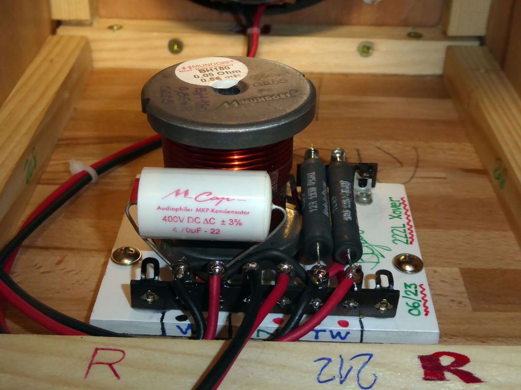

I personally use 2.5mm2 for Input, Woofer and Midrange, and 1.5mm2 for Tweeter, that is to say : 14 and 16AWG, according to the conversion table below...
I forgot to mention that indeed I use multi-strand cables... 😉
