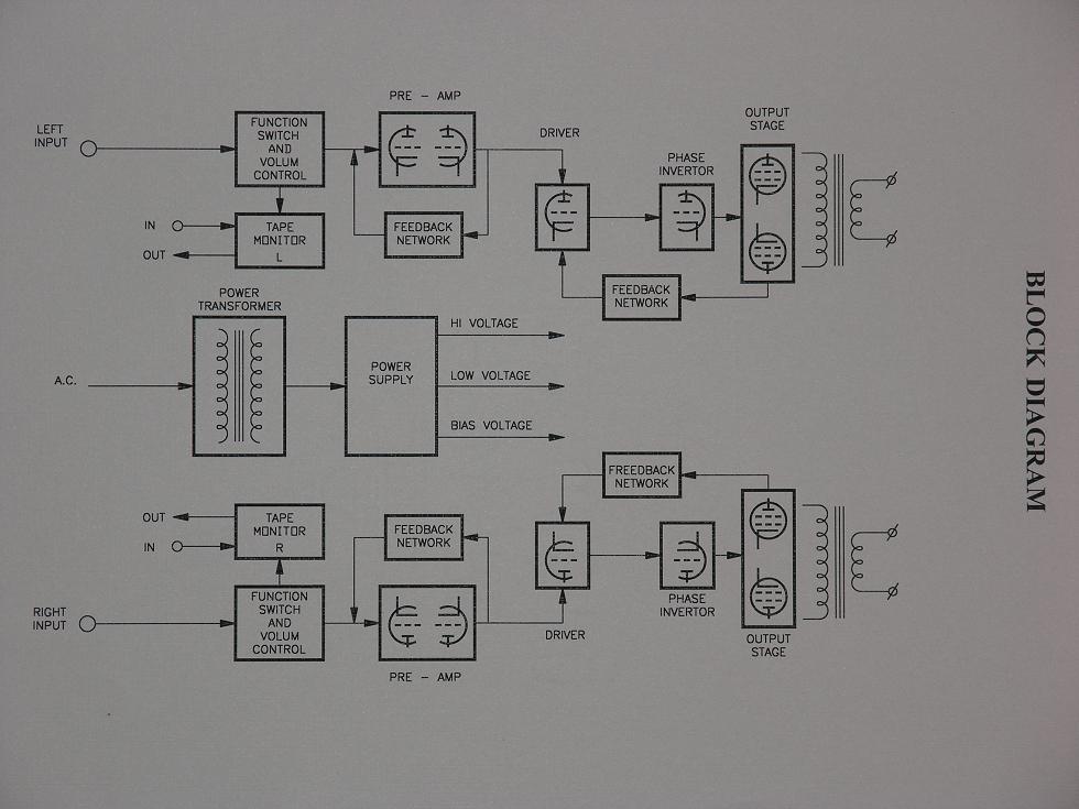

I do not have the schem to show, but I do have a block diagram that is attached.
Should I stop listening to that amp right now? It does not seem to affect the sound, except for the visual threat.
I would like to know more about what to do to fix the problem(s).
Ummm......that's thrown it... preamps is also on the same chassis as main amp. Problem could be in preamp section. I'm tempted to take all the tubes out of the preamp and switch amp on and see if instability is still present. An easy way ? Maybe See what other forum users mention.

I don't know much about electronic and don't feel comfortable poking around inside the amp. But I do have a friend who can help me if knowing what to measure or do. So, if you all can tell me what to do or how to do, we will try our best. Thanks.
You really need to find a circuit diagram. Without one, even an experienced engineer would find it hard going poking around inside.
Re-read your first mail....I was wrong about suspecting the preamp as you mentioned problem occurs with volume turned right down. As EC mentiones we need a schematic to go further.
