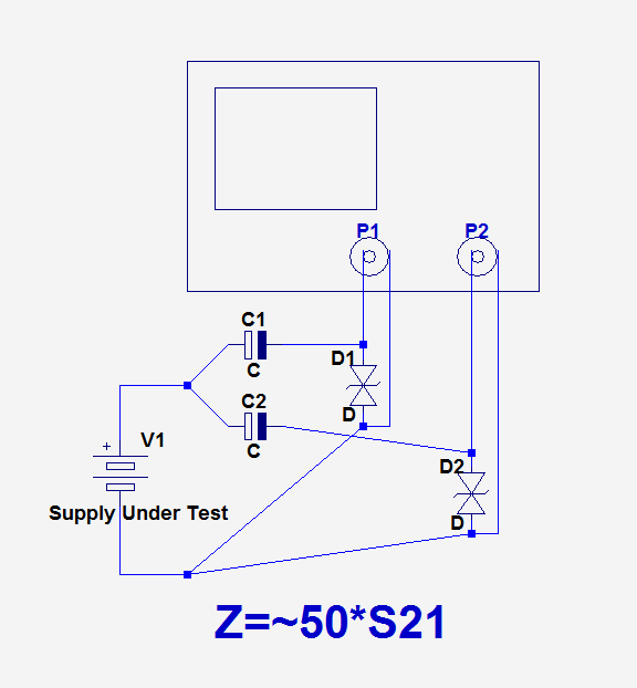

I don't think anything is insurmountable or even costly: take the PSRR, if you feed a floating supply from the ground side using a wideband buffer or amplifier, you can easily arrive at decent results provided the capacitance of the DC supply wrt. ambient is reasonable.

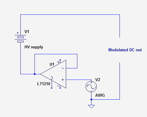

Here is an outline, the LT1210 only has a 66MHz GBW, but if you accept lower output currents (or if you shop around), wider bandwidths are possible

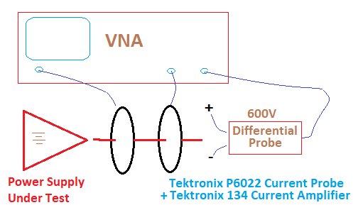

Here is the way I would do it. Modern VNA's have a usable range >100dB, meaning the setup will be able to resolve ~0.5mΩ.
If that's not sufficient, a wideband buffer followed by a 5Ω resistor could be inserted in port 1. This would better the floor by 20dB

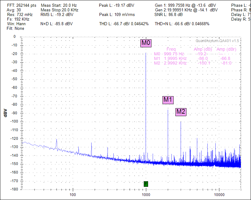

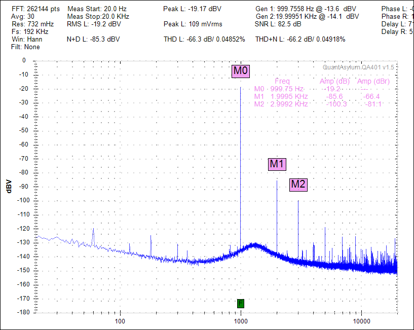

In the recent couple of years I have been using audio analyzers to see the influence a voltage regulator has.
There is one brand of regulator kit that does a particularly bad job. This is a linear regulator that uses an IXCP10M45 current source. This regulator creates a huge broad noise hump that centers near 3K Hz. The hump does not flatten out until there is better than 50VDC delta across the regulator.
To see instability and distortion past the traditional 20K Hz BW the recent crop of audio analyzers has much broader BW. The Keysight U8903B has a 1.5M BW option. The Audio Precision APx555 comes standard with 1M BW.

Memory failed me. The HV regulator that I mentioned having the noise hump centered at 3K was centered at 1,300hZ. The regulator name is PS-1, the performance is much improved with 50+ volts across the regulator.

This power supply / amplifier is looking a lot like a Do-It-Yourself version of a Kepco BOP kind of thing. If picotest made it, it would come with a shiny logo and a certified/tested data sheet. . I like it.
This looks a lot like the voltage controlled resistor kind of thing mentioned in a previous post. The feedback at the error op-amp non-inverting input gives a good head start towards a good PSRR. (This is negative feedback as the MOSFET is inverting.)
The 20ma max output at 330 ohms may be a little problematic.
