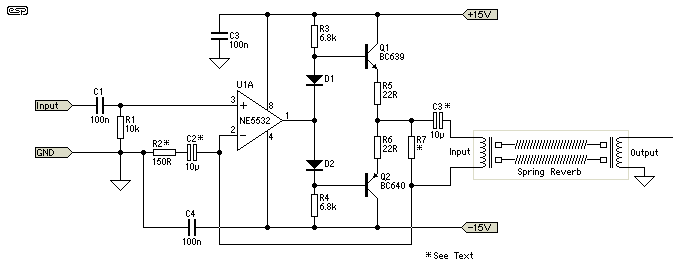

I have built this circuit. It is the driver for a spring rev. transducer. In my reading 'being a novice' i have discovered that a there are specific diodes for the signal path. currently D1 and 2 are 1n4001's should i use something different?
Anyway; heres the schematic.

1N4148's seem to be commonly used in that type of circuit. It may not make much of a difference,4001's should be okay.

oa91s are germanium types they would probably work but bear in mind the forward voltage is only approx 0.2V . this means in your circuit, as it stands, reduced output transistors' bias current.
in fact (too early in the morning here) your output transistors would be biassed practically off this would be running class b with significant crossover distortion. maybe not such a good idea?
I'm not saying you can't use them - just you'd need 6 or so in the same place as the two silicon ones you're replacing

I assume spring reverbs sound better with added crossover distortion? That is what the circuit will provide. The designer also seems unable to decide whether to use current or voltage drive, so he designs a crude voltage amp then uses negative feedback to raise its output resistance but then changes his mind and adds a resistor in parallel with the drive coil to lower it again.

interesting comment DF96, as a novice i didn't see that, its crude nature is ok for my purposes. However I would like to to have the circuit as clean as possible. The whole project is off the esp Spring Reverb site.

I'm surprised. ESP circuits are usually better than that. However, it seems he uses current drive, with R7 damping the HF resonance. I would use small signal diodes for output bias, not rectifiers.
