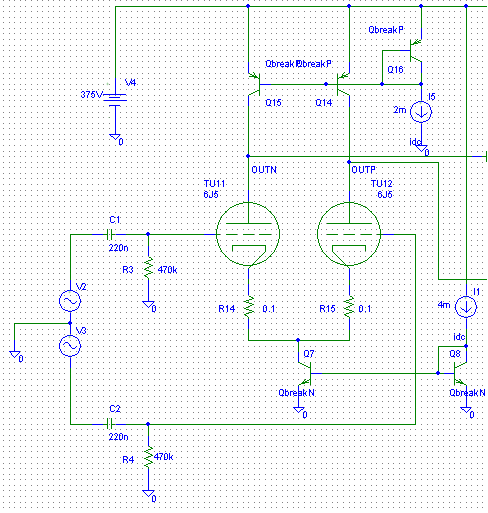

As you're mixing sand with your glass anyway, you could consider using a bipolar cascode as a telescopic cascode load for the tubes in the diff pair. That way you can get gains very close to the rated amplification factor (mu) of the input tubes. This also loads the triodes with something that's very close to an ideal current source so they should operate quite linearly.
6J5 will give you a gain of about 20. I think the ECC83 (12AX7) would give you a gain of about 100.
If you run a tail current of, say 10 mA, you set up the cascode as a current source delivering 5 mA. There's a blurb about BJT cascoded differential pairs in Morgan Jones' book.

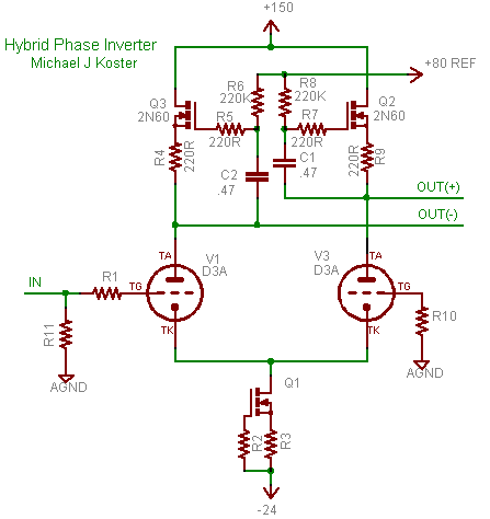

A pair of D3a in triode with choke or gyrator loads and a CCS tail will get you a voltage gain of 40x per side or 80X side-to-side when driven from one side (also maybe 12HG7 in triode)
There is an interesting hybrid inverter discussed in a recent thread
http://www.diyaudio.com/forums/tubes-valves/160776-phase-splitter-idea-2.html#post2077262
Michael

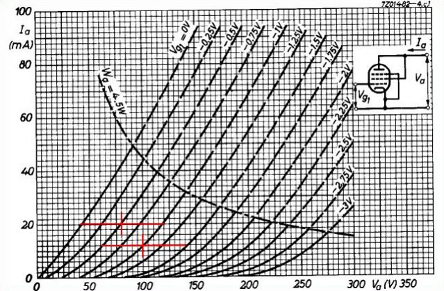

12AX7 : Yes, I LSPICEd it and I could see what spec curves shows : input voltage will be limited to less than 1V if high current is to be expected.

Many of the past's "giants" used pentodes at the amp's I/P. We are NOT smarter than Hegeman, Recklinghausen, Hafler, and other luminaries were. You are boxed into a corner by that 150 V. B+ rail limit. Differential gain blocks should be resistively loaded, with a constant current sink (CCS) in the tail. Even the previously mentioned 6922 cascode needs more Volts than you are willing to use. Remember, a voltage drop occurs across the load resistors. The EF86 is both highly linear and very good sounding. Quite a few triodes can't come close to the sonics the EF86 produces.
IMO, the EF86 is as close to perfect as you will get, for this particular job. It's in production, sounds good, works well at modest anode voltages, and draws a low IB.

Cascode with BJT : you know what? I tested it. But I can't understand if this is equivalent to load Tubes with current source or not. In fact, as load impedance is low, we are not in best case for distorsion
The anodes of the tubes "look into" a collector. So they should see a load resistance that's fairly high. However, if the diff pair is not loaded evenly by the subsequent circuit, the distortion will suffer.
If I only need one of the two outputs from the diff pair, I find that putting in a "dummy load" on the unused output will be beneficial to distortion performance. Usually I use 220 nF + 470 kOhm as coupling cap, grid leakage resistor on a following stage. All that's needed is a replica of the 220 nF + 470 kOhm to keep the diff pair evenly loaded.
In PSpice, I had to use actual BJT current sources as the ideal ones created a fairly unrealistic DC operating point. You may have to do the same in LT Spice.
~Tom

Please notice that Tom's setup uses a 375 V. B+ rail. Once the 150 V. B+ limit is established, the EF86 (IMO) sticks out like a sore thumb.
True. But the anode voltage on the 6J5's is only about 25 volts in my sim. This is obviously not a desired operating point. But by tweaking the ratio between the two current sources, you can move the operating point. At one point I was running with 60-ish volts on the anodes and distortion numbers on the order of 0.01 %. I don't see any issues with doing that on a 150 V rail. You only need a few volts across the cascode for it to be happy.
~Tom

I will take some time to consider EF86, the curves look nice.

I was considering a circuit of this kind. I suppose that the resistive part of the load is the connected circuit? Thus gain may change according to level no? I wonder how linear a high value load stay if connected circuit is active and bipolar. Did'nt investigate much up to now.
I will need both output of differential stage for the output buffer, so symetric loading will not be an issue.
I haven't heard a triode solution except D3A yet...
at 80V p-k you have enough headroom for a gyrator
I put in a CCS tail; you might do something different.
Also if the loads are symmetric you can replace the 2nd D3A with another MOSFET, properly biased of course.
Correct.
The gain of any amplifier will always depend on the load impedance (along with source, input, and output impedances). No news here. But with a light load (470 kOhm in my case) the load impedance will only have a small impact on the overall gain. The gain will not depend on signal level.
The issue is that the differential amp has very high output impedance. As the output impedance and load impedance form a voltage divider, a low load impedance will reduce the gain dramatically. There are different ways of addressing this. One is to use a cathode follower (or source/emitter follower). Morgan Jones does this in his Crystal Palace Amp. The cathode/source/emitter follower has very high input impedance so it doesn't present very much load on the preceding stage. At the same time, it offers low output impedance, hence, has a good capability for driving a heavy (low impedance) load.
