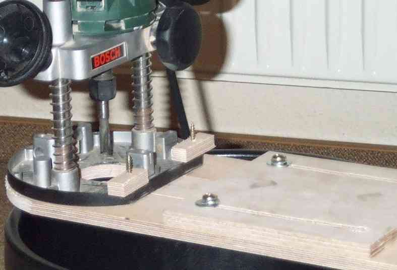

kvk said:
Does someone make something like a cheapo adjustable jig for routers?
I do have a router and bits already.
Last Wednesday I made a trammel for my router and cut two perfect circular holes with rebates in plywood without any splintering. All you need is a strip of something reasonably rigid (I used 1/4" SRBP, but you could use aluminium). You screw the router to it, and at the right distance from the cutter, you drill a hole for a bolt to go through the centre of the circle you want, drill a hole that size in your baffle. Then, with great trepidation you gently lower the bolt into the hole in the baffle, switch the router on, and cut a perfect circle.

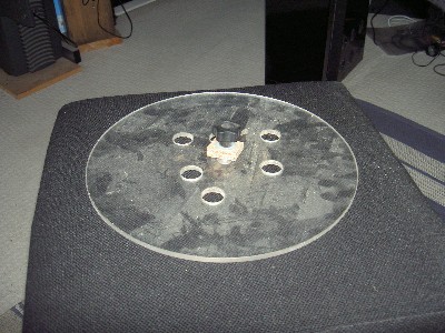

I've used this for the last 5 years with no problems at all. Pic shows the jig upside down. Its best used if the target piece is placed ontop of a piece of scrap so you can drill the centre of required hole thru both pieces.
for duplicating holes I find it much easier to cut a template with the jig tool and then just used the template.
Ed

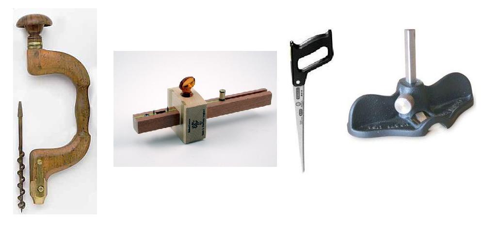

I use the following for great success!
Starting with my trusty brace and bit, I drill a hole big enough to start my keyhole saw. Once a nice neat hole is cut, I use a combination of marking gauge and router plane to cut the recess.
Piece of cake!
Piece of cake!
But John,
you've had years of practice at doing this and I wouldn't trust myself to saw a straight line without some sort of jig/brace/form to keep me in line.
A man's got to know his limitations (someone said that before I think). And I have lots of limitations but I just try to find a way around them instead of getting someone else to do the work.
Makes for slow progress, but I can say it's all my own work!
