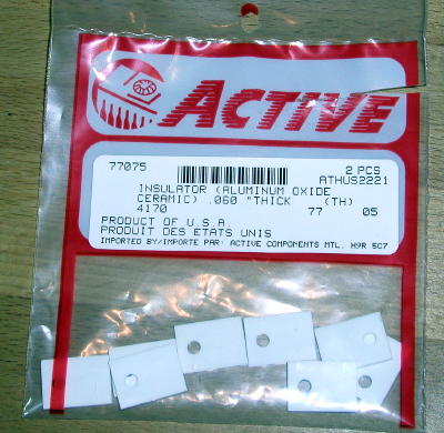

What are you guys using to isolate your wide TO-220 packages like the LM3875?
Checking stores, all I can find are the thin flexible TO-3 pads (wrong shape) or the thick aluminum oxide for narrow TO-220 (too narrow).
Is there something more specific out there which I can't find?

There are silpads available in larger formats (100x100mm) which you can cut into the desired format. Your local supplier must be able to provide them.
This for example: http://www.angliac.com/product_search/product_range/datasheet_search/cat_page.asp?cat_number=500

I'm using TO-220 aluminum oxide pads under LM1875. It works fine and sounds better than silpads (less damping, I guess, results in more airy sound).
Peter, do you mean just the regular narrow TO-220 pads? So you are experiencing no issues with having some of the LM3875 mounting surface not in contact with the pad? If so, I would love to hear it!

Peter was talking LM1875 which is in TO-220. LM3875 is in 11 pin MultiWatt which is small enough to fit on a TO-3P (not TO-3) pad. To use TO-220 pads under a LM3875 seems pointless since TO-3P are readily available. The MultiWatt size is hard to come by and the only place I've seen it is Schuro.
I got everything mixed up. I meant LM3875 and TO-247 pads pictured below. They measure 14 x 19.5mm and I think are sold indeed as TO-220, but fit TO 247 and are the same as TO-3 P (I guess). The sides of a chip are sticking out a bit, but I didn't have any problems because of that so far. I really like to use those aluminum oxide pads here, as I said before, they sound better and provide extra clearance between heatsink and pins for a feedback resistor.

Plastc screw is OK when not much pressure is required (diodes), but on ICs and transistors, I'm using metal screw (non magnetic) and a plastic washer (I buy from Supremetronic).
Are those plastic washer are just normal flat ones, I am concern about the shaft of the screw may make contact with the inside surface of the heat sink thru hole. May be I have to use heat shrink on the screw first?
Chris, like Peter said, those washers have extra-long "sleeves" that do precisely that: preventing the screw from touching the heatsink.
I have been using plastic tubing for that purpose as well.
