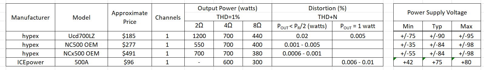

So I have narrowed down a list of amp modules that could possibly work with my power supplies. It looks any one of these would be well below the distortion threshold that my ears can hear.
The NCx500 is going to be out of my price range for this project. The Ucd700LZ looks like an older model and maybe not too far off from the NC500. The ICEpower is dirt cheap and if two modules could be bridged it could give some serious power (thinking maybe subwoofer duty).
Anyone have any thoughts?
