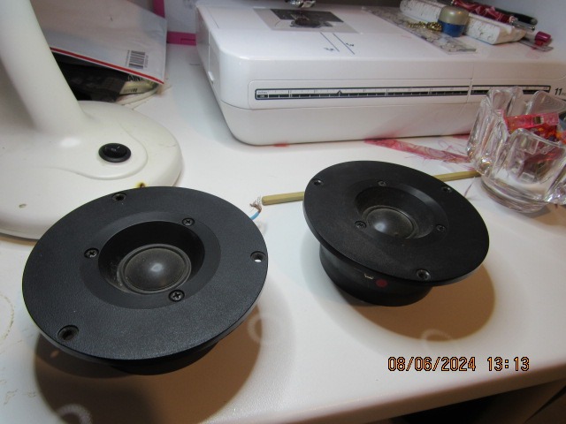

Tweeter has a very small wave guide. 50mm wide only This is an experiment in progress and I'm waiting for the Ferro fluid to arrive but without the FF the Fs is 670Hz and a 32mm voicecoil can handle a few more watts I assume.
Minimum second order and maybe third if needs be but I prefer the simple options

You might use a small coil, say 0.5 mH on the bass to correct the rising output. And a Vifa DX25 high output 4 ohm tweeter with a mere 10uF or so capacitor and a 15R shunt to tame the tweeter Fs a bit.
Impedance must go a bit low at the high end, but maybe that won't matter most times. I might use a higher order tweeter filter around 3kHz, but it's all just experimentation in the end.
Eminence would probably use 2mH and 10uF on the bass in an off-the-shelf filter.

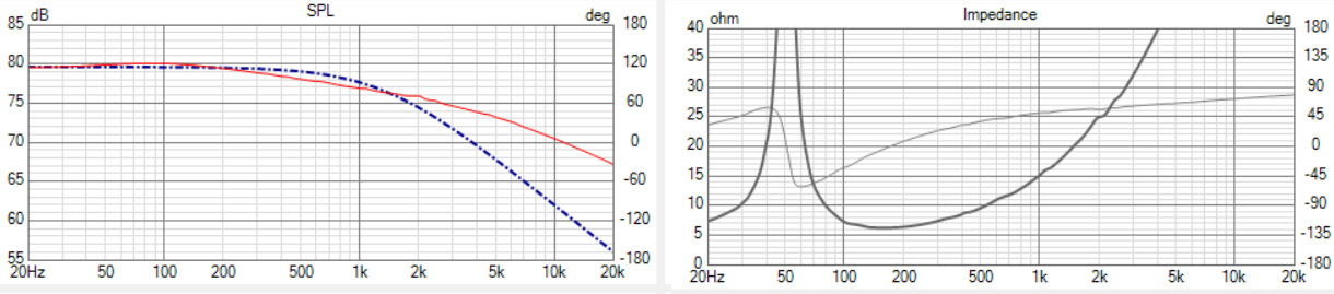

Something I've been thinking about a bit just recently. Most woofers have a rising response; if this is due to a rising impedance does using a conjugate such as a Zobel also stop the rising response?
Hence the common use of what Weems called a Strange Second Order network on woofers. I should have another go at one of those circuit programs

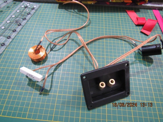

Steve the XO that came on this speaker was a 0.33mH aircoil, that 16R resistor across the tweeter along with a series 10uF
Tweeter being the Scanspeak made Peerless DX25TG-05-04

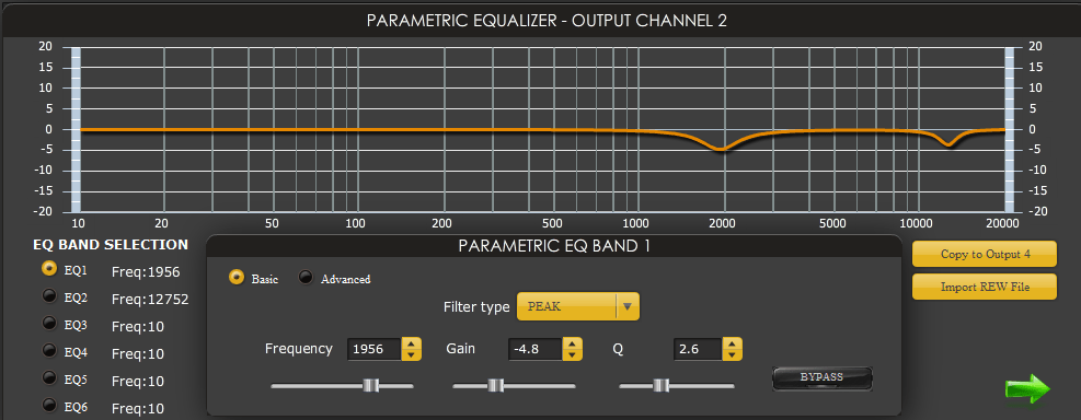

the dayton jbl pt clone with a d220ti works fine crossed lr2 1.3khz.
https://www.parts-express.com/Dayto...-12-Waveguide-1-3-8-18-TPI-270-318?quantity=1
only need a little eq around horn loading, the 12khz may not be needed.
