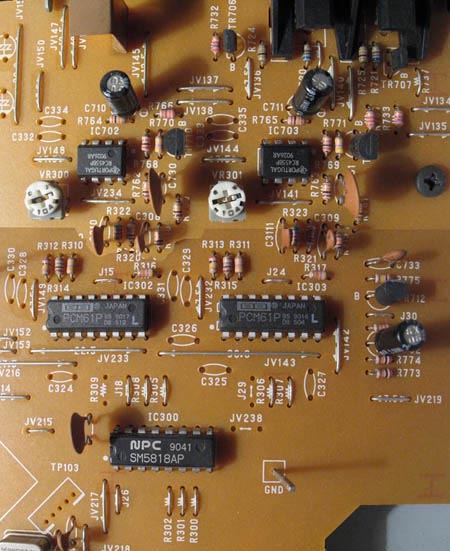

Well, my appetite grew up since I bought Sennheiser HD 595 headphones, 😀 so, I really need to change something with the sound of my cd player Denon DCD-560.
What should I do:
1) Put it away and buy something better (the least possible option)
2) Do modification of line out (changing OPA RC4558P to something decent)
3) Implement (somehow) digital out and build high quality DA converter.
Third option looks like best solution, but I can not find datasheet for SM5818AP, and do not know where I should steal digital signal from.
Well, here is photo attached of output stage of this CD player, so please take a look and give me some suggestions…

Is there really not a digital out coaxial or optical on that machine???😕
The OPA RC4558P can be replaced by NE5532AN/AP. If you want to try OPA2134 you should mount decoupling caps and other things may be needed to make it work at its best.
No, unfortunately there is not any kind of digital out on this CD player. 🙁
For the beginning I’ll try to change RC4558P to some Burr Brown OPA, but some friends will help me build high quality DAC (maybe dddac1543mk2), so in near future I'll need to find (anyhow) the way to extract digital signal from this machine, or I’ll have to change it to something else…

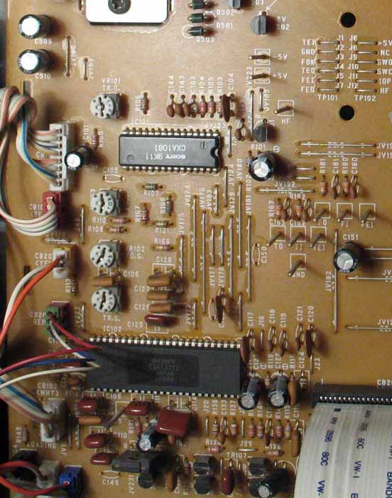

There are two Sony chips on the lower left side of the board:
CXA1372S and CXA1081 ,
here is a photo...
Can this help?
Hi Velicko,
why dont you read some of the threads on modding cd players.
This player uses BB PCM61 X 2. Highly sought after dacs in some circles.
Add a clock, new op amps and maybe a new transformer, power supplies and good caps will make this a pretty decent little cd.
seeya Arthur

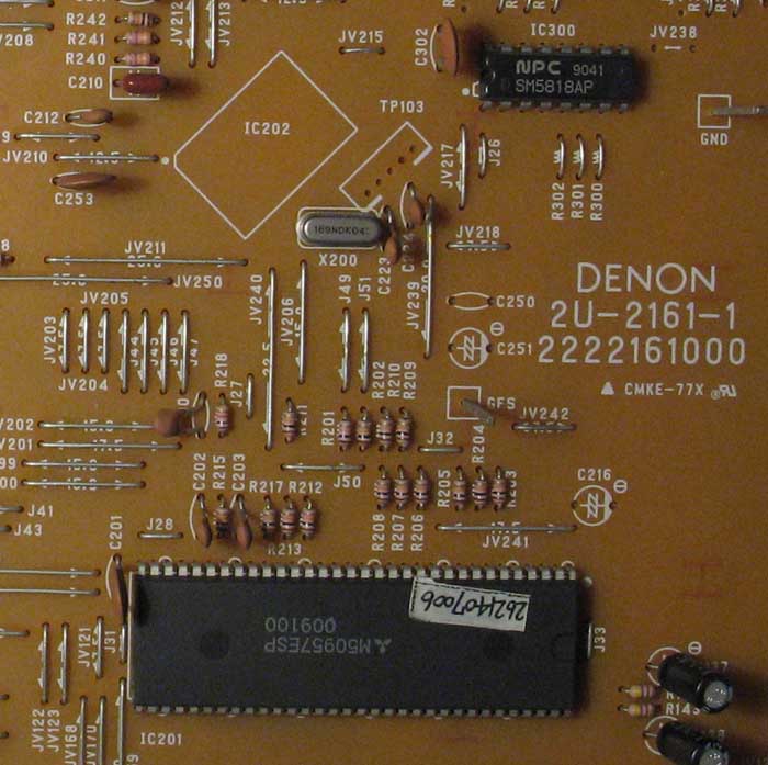

searching the DSP ...
Hi velicko , the M 50957 could be the decoder , but datasheet of these chips are not easily available . You would have to search it .
Otherwise , I see from the pic that there another chip soldered on the down side of the PCB , where the quartz is (the little metal piece)..This one could be .
Re: searching the DSP ...
I found it... link is:
M50957 Datasheet
Sorry, I can not upload it. It's about 1.3MB...
But, I still do not know what to read from datasheet...
allright , the m50 ... is the microcomputer , not the decoder (DSP) . So you would have to unscrew the PCB and turn it to see the ref of the CMS chip soldered on the other side ... except if you could find the service manual or shematics of that player .

OK, I decided not to do anything with this Denon... (I am modifying some newer Philips CD now), but not to let this thread unfinished,
I unscrewed the PCB...
The microchip is Sony CXD2500Q.
Maybe this will be of any help to anybody in the future...
