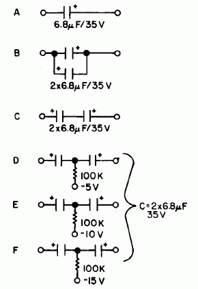

Hi, Carlos,
It is for input capacitor. You can look at the article from Walt Jung's website http://waltjung.org/Classic_Articles.html look for "Picking Capacitors" part 1 and 2.
I've tried it, it give more treble than non-polar elko or plastic capacitors. This method is also used by JBL K2 S5500 http://www.lansingheritage.org/html/jbl/specs/home-speakers/1993-k2-s5500.htm. They split a capacitor into 2 capacitors and bias the center connection, I guess because it give better sound.
Also you can try to arrange LPF/RC value at the input about 250khz.
