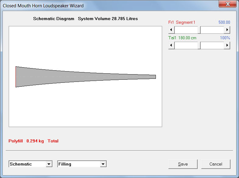

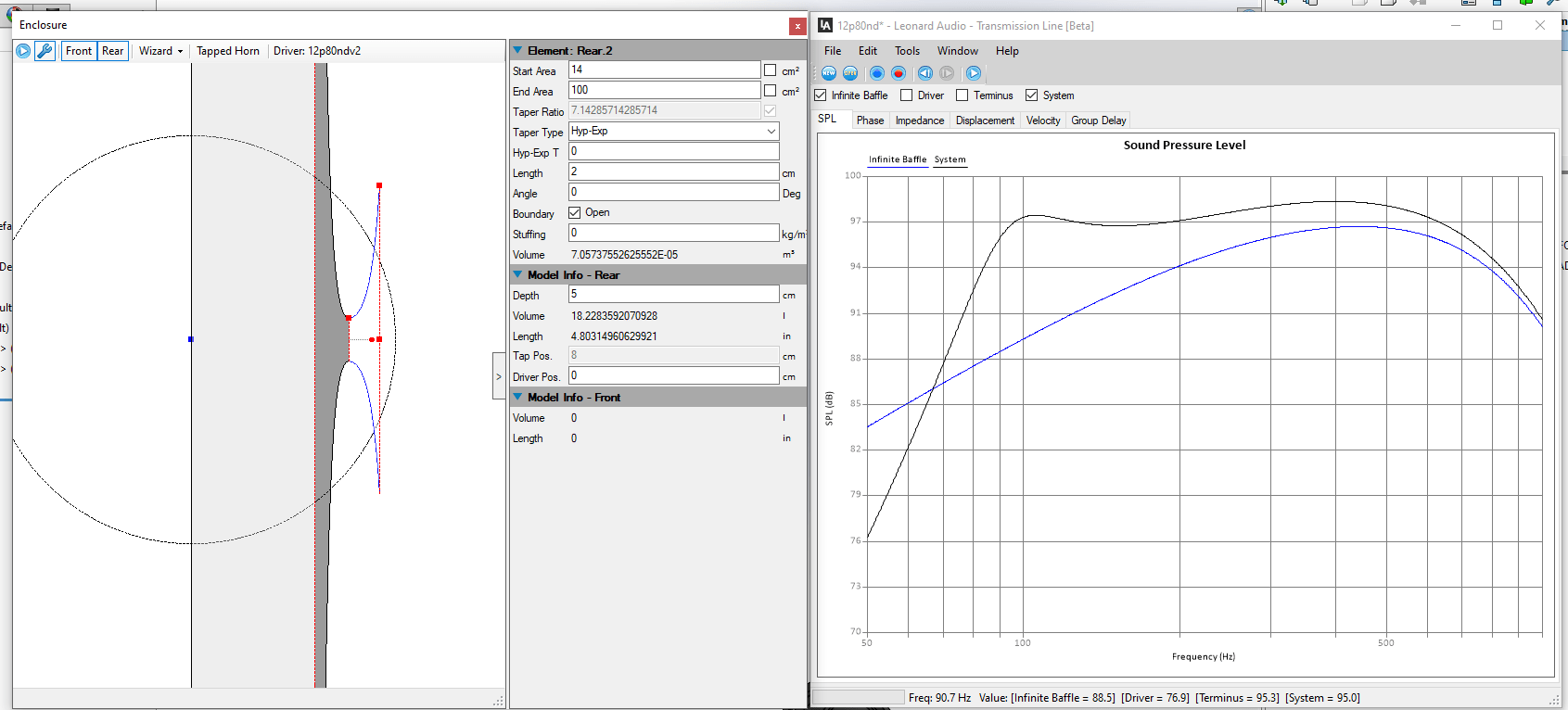

So how to best use the 12P80nd... well i was thinking a terminated transmission line - so will effectively get a infinite baffle response. I modelled a logarithmic spiral as a first pass, not the most efficient use of cabinet space. Am i right in assuming that as the driver will only be covering frequency's up to 1.5k smoothing out features smaller than a wave length wont add much. I have the CNC so can make what ever shape of transmission path i like.

Basic? math Q, assuming parallel sides it's a parabolic flare factor, so what would its flare frequency be based on the log spiral or is there none?
Not sure I understand the question, using a 1/2 wave transmission line to absorb the back wave. Was planning parallel sides. I haven’t worked out how to model it in MK’s spreadsheets yet. The big question I suppose is it going to improve the drivers properties. I may make a dagger shaped rear box to test the concept before investing time in doing the cabinets properly.

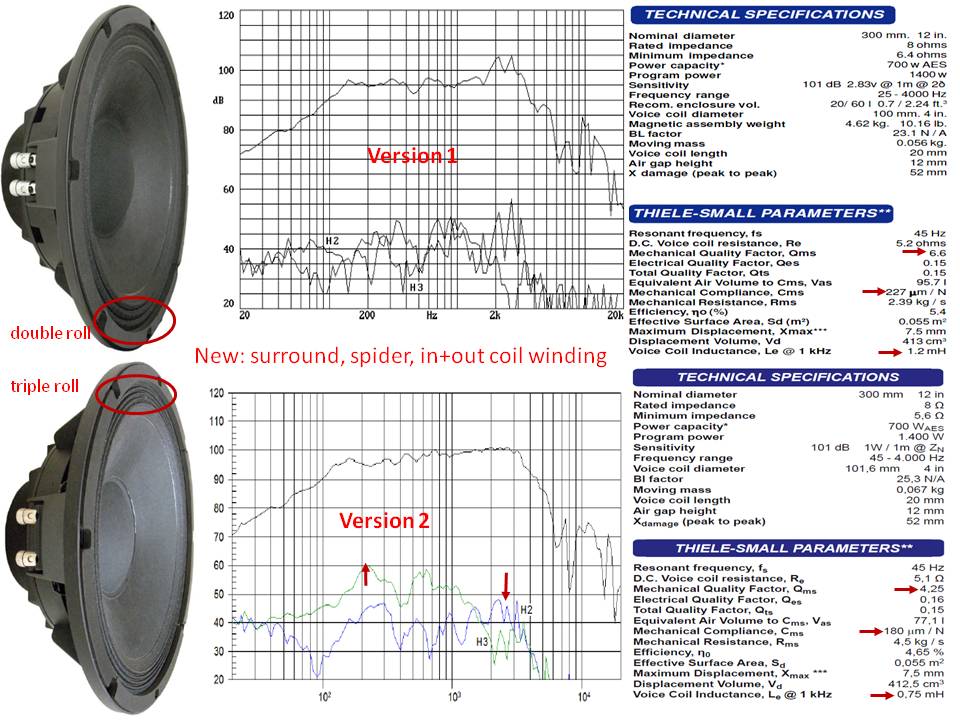

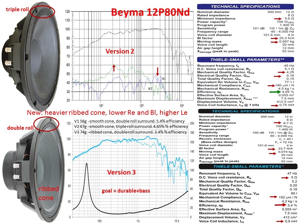

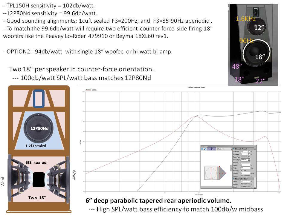

Is it the original 12p80nd you have? i seem to remember, and your picture linked kinda confirms its the V2.0.
Some links to different version/variations and discussions from here.
Terminated TL, Max flat impedance (open )TL, Closed box, Reflex,EBS, Aperiodic etc.
As for how to use it, a Large format midrange/voice range driver, with limited excursion/ IMD desireable.
Crosse over to large format woofers single 18, double 15 or similar.
As you can see from the plots in next post going much below 100hz is likely not desireable.

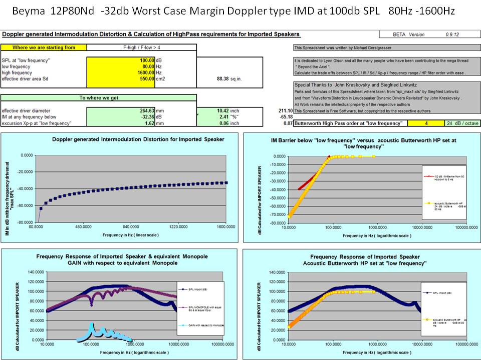

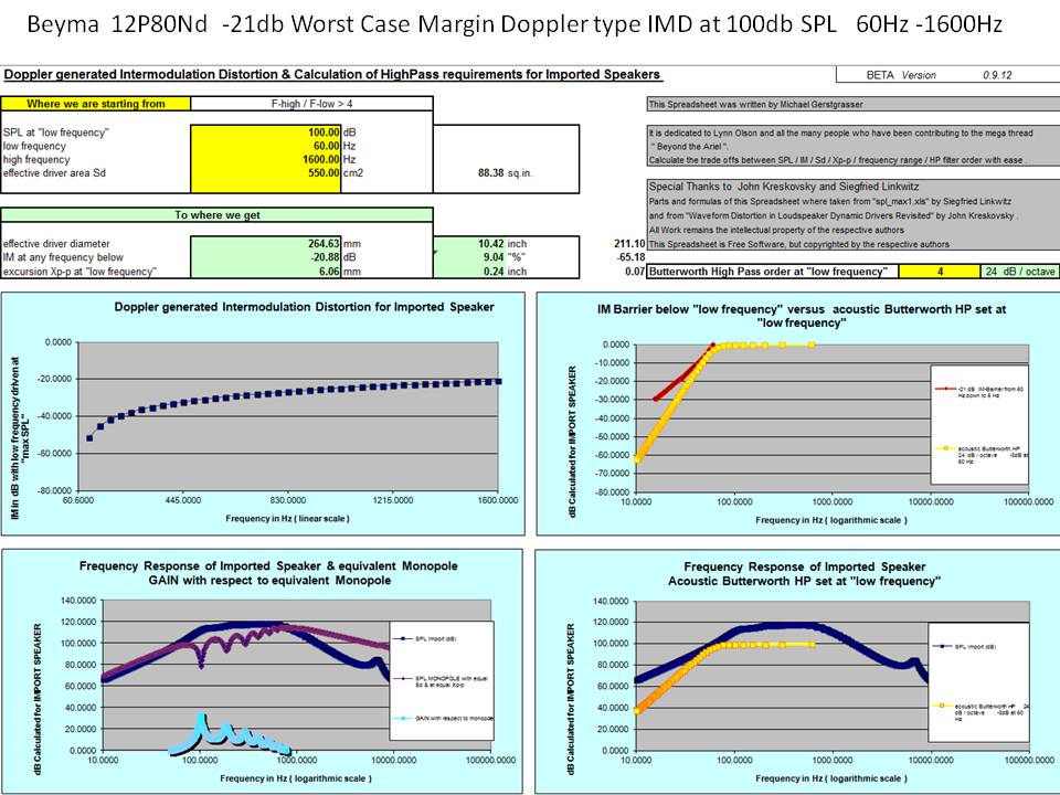

and some more, most of the images can be accredited to @LineSource

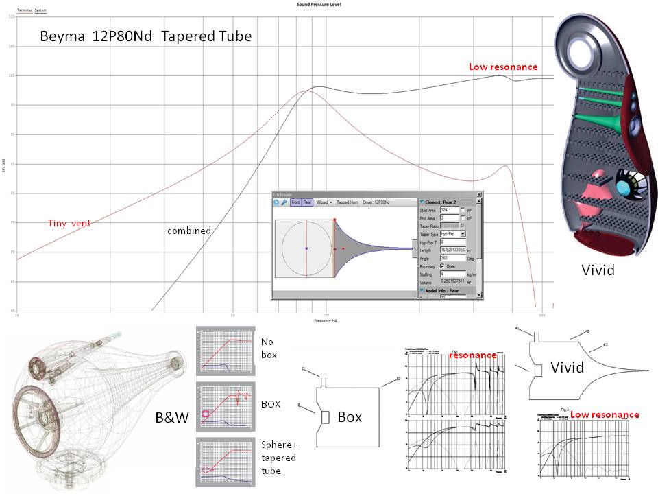

Thanks for the links to all the existing threads.... some are from when i originally was looking at using the Beyma drivers. Its interesting how the posts from Linesource suggest with a parabolic taper to absorb the backwave it doesnt need to be as long as i was assuming. I was assuming terminated at both ends the lenght would need to be 1/2 wave.

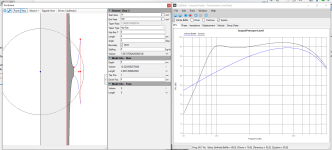

I have spent a few hours today getting frustrated with software i thought i had. My mathcad licence doesnt work with the softwares latest version, i had saved the MK worksheets off my old laptop before it died. The leonard audio software doesnt work either. Wish i had kept an old XP machine. So i tried modelling the lograthimc line in Hornresp - it looked horrendous, but dont see how to account for the stuffing.
Last time i downloaded Leonard Audio Transmission line program, i had to dig the file up, on archive.org to make it work. The publicly available one that pops up on google searches i had no luck with. Have not tried it on Win 11 though if that is what you have.

And yes tapering the line has a nice beneficial side effect, taper ratios of 10:1 or similar is popular due to that fact.

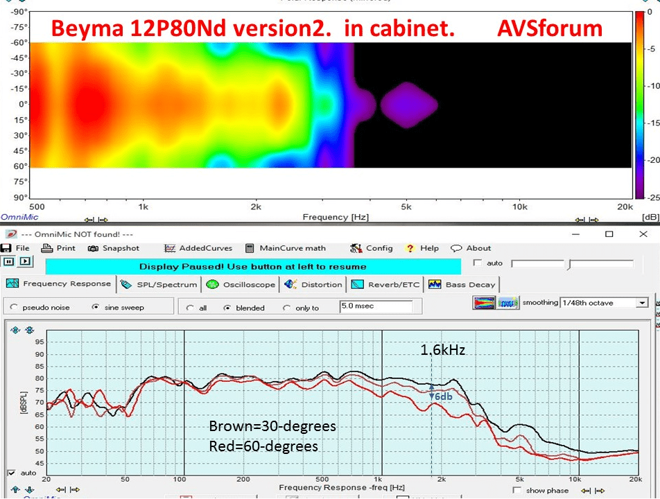

The 12p80s main issue partnered with the TPL from my POV , the horn forces it to cross over higher then ideal, if you wish to match directivity at xo.
So you suffer in coherency and vertical dispersion, pushing the xo upwards with a large CTC distance. Being large AMTs the vertical is already compromised by it's design.
There is also a objectionable resonance for some at 1,6k which is in the desired XO region.
IMO a TPL with backchamber modification, and possibly the lens that was posted here, attention to diaphragm etc.
Will let it play clean down to 1200, but that requires a new Horn/WG for a good directivity match to the cone below.
So a different beast altogether, and time consuming/expensive.
