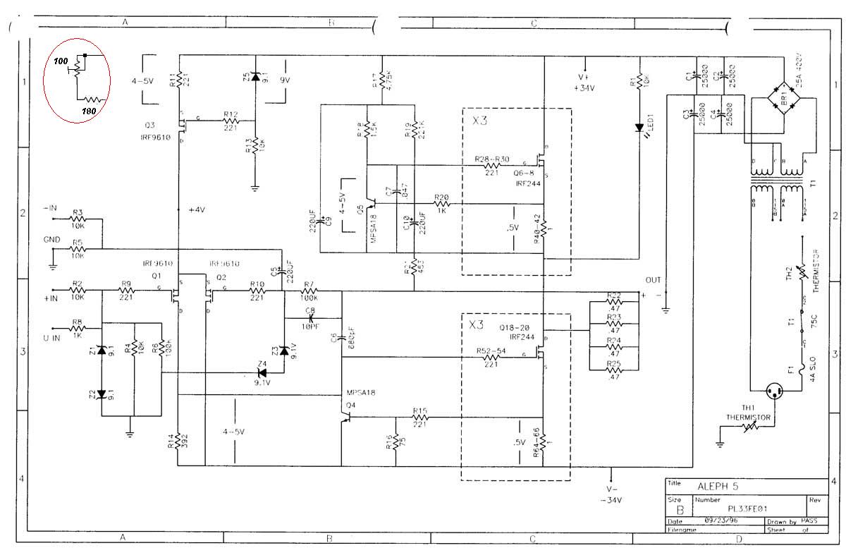

Greetings I did som Metalwork today.. So what amp to put in the the box ?
My rails will be +/- 30Vdc and i will be using 12x36000Uf caps
I don't ordinarily recommend Alephs for 4 ohms unless
they are biased extra high. Not enough control for many
of the 4 ohm loads, and usually more distortion than I
want.
As a rule I like to use push-pull followers for 4 ohms -
Class A of course.
