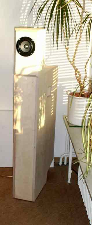

Hello,
to use the FE206E
i made a few solutions
SCHALMEI
TRUMPET
HORN as satellite horns
and
SAXOPHON and RDH20
as fullrange double horns
but if i see your wishes:
"Basically, I've two projects in mind, a smaller pair to replace my computer speakers, and a (possibly) larger pair for the living room. The living room is about 4x6 meters (13x19.5ft) in size, though part of it is a hallway, so there's a wall that extends half-way into the room. The "inner" part of the room is about 4x5 meters (13x16.5ft). The speakers will be along the longer of the walls, with a listening position of 3-3,5 meters (say, about 10 feet) away.
My musical preferences range from the extremes of metal (Anaal Nathrakh, Meshuggah), through progressive metal (Opeth) and rock (Focus) on to electronic styles such as techno, breakcore, minimalism. I also listen a lot to singer-songwriters, generally female (Regina Spektor) and have over the last year started to listen to fully orchestral music, works by minimalist composer John Adams in particular.
Since I live in an apartment, I never listen to anything exceptionally loud."
may be the KORNETT would be enough.
small, cheap, soundstage, bass, max. SPL95 dB

Hello Moset,
most the Kornett is enough,
the Posaune with FE166 +167 i heard in München
in a small room, seems the same as the other double horns,
but if the Kornett is not enough,
take Saxophone or the RDH20,
the Sax is more puristic, but
by the noth filter in the RDH
you can get a bit more SPL.

I'm actually leaning towards the Kornett. I'm intrigued by how low it can go and the build looks sufficiently easy. It's also "untested" on this forum (at least I've not seen another build of it), so hopefully I can rectify that. The extra €20 for the plans is, although unusual for this place, not that much and worth the chance. The TangBand/Monacor combo is cheap enough to make up for it. Chances are I'll be building a few other designs as well, before this decade is over. 🙂
A couple of questions to Horst:
What's included in the plans and what materials are used in the build? What thickness ply, etc. Oh, and does it play well with solid state amps?
