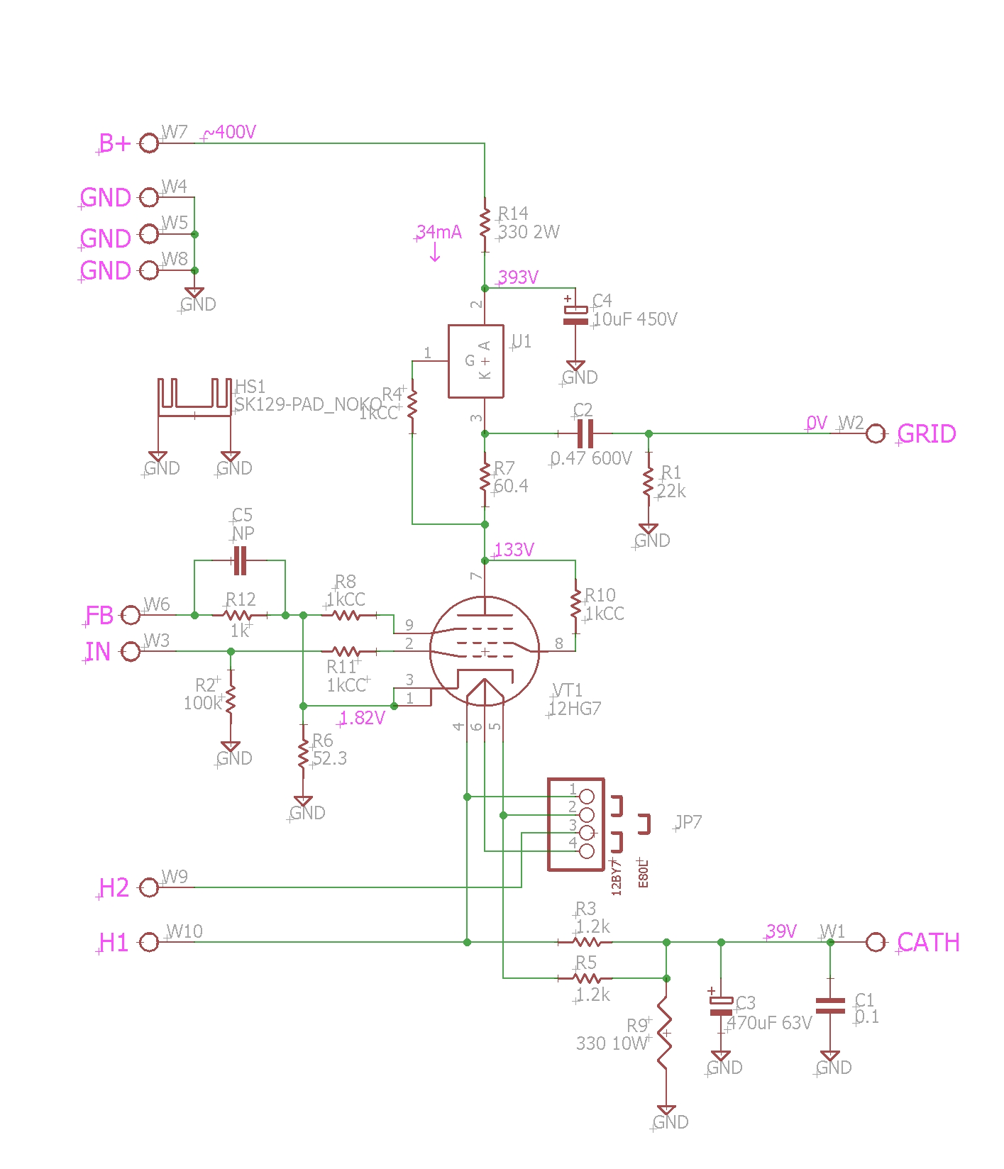

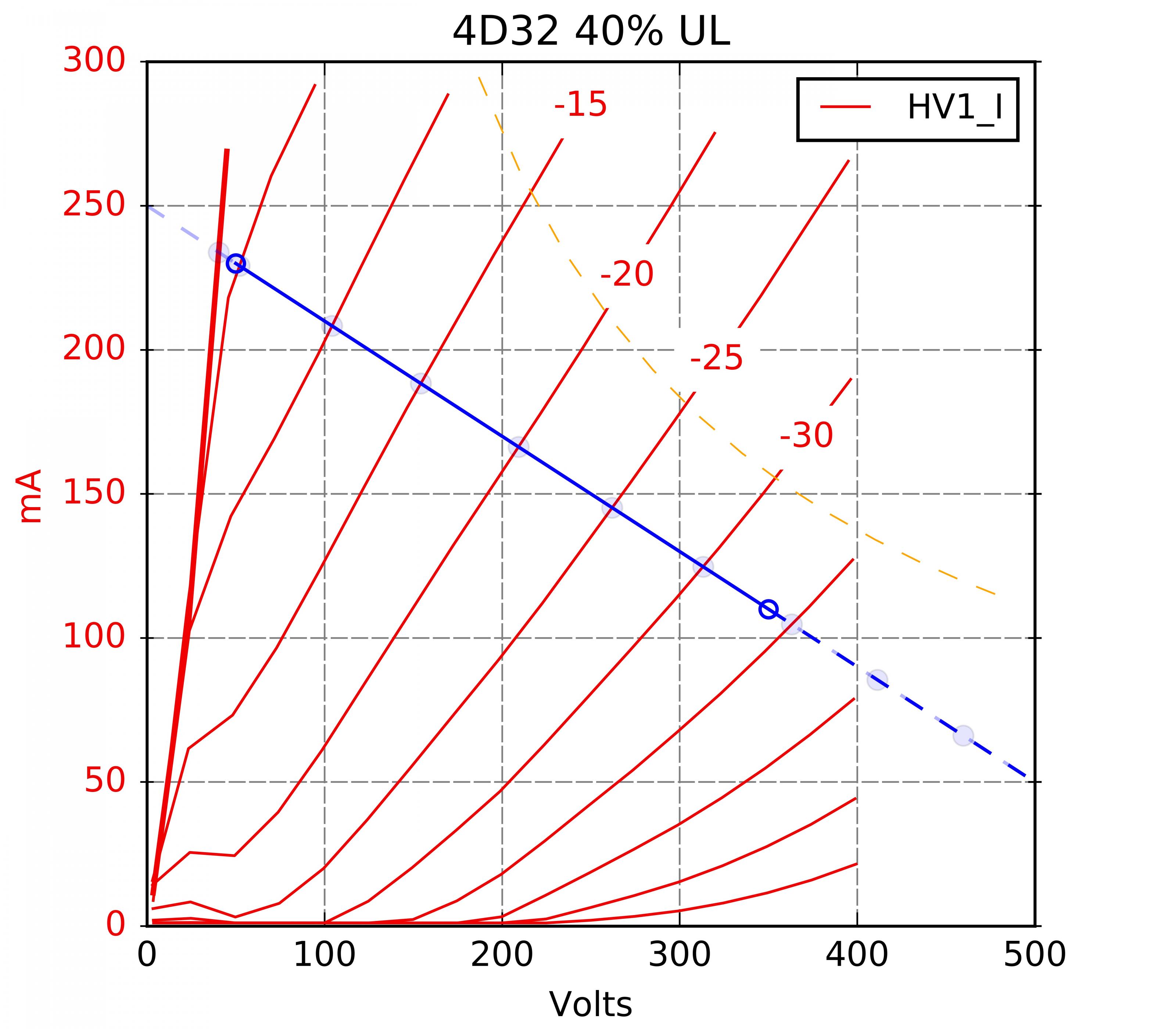

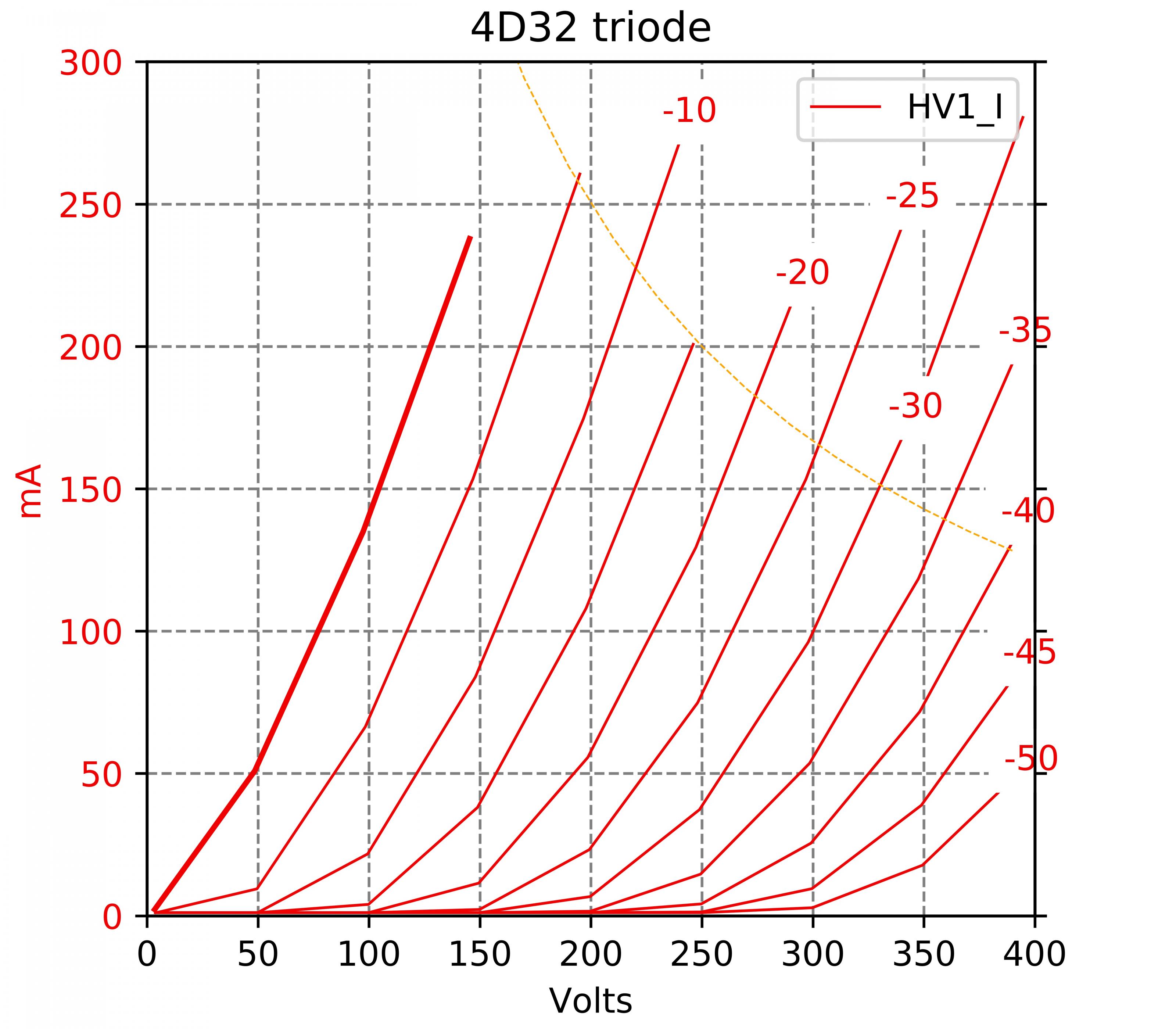

I have a 4D32 (https://frank.pocnet.net/sheets/201/4/4D32.pdf) ultralinear on the breadboard with that OPT right now. 16 watts @ 5% THD, 400V B+ (yes I know that is pushing the G2 rating a little). Or 10 watts in triode if I remember right.
Not real low distortion - maybe 0.8% @ 1W.
Using a single 12GH7 triode wired with a CCS load and a small amount of overall NFB.
Pete
Pete
