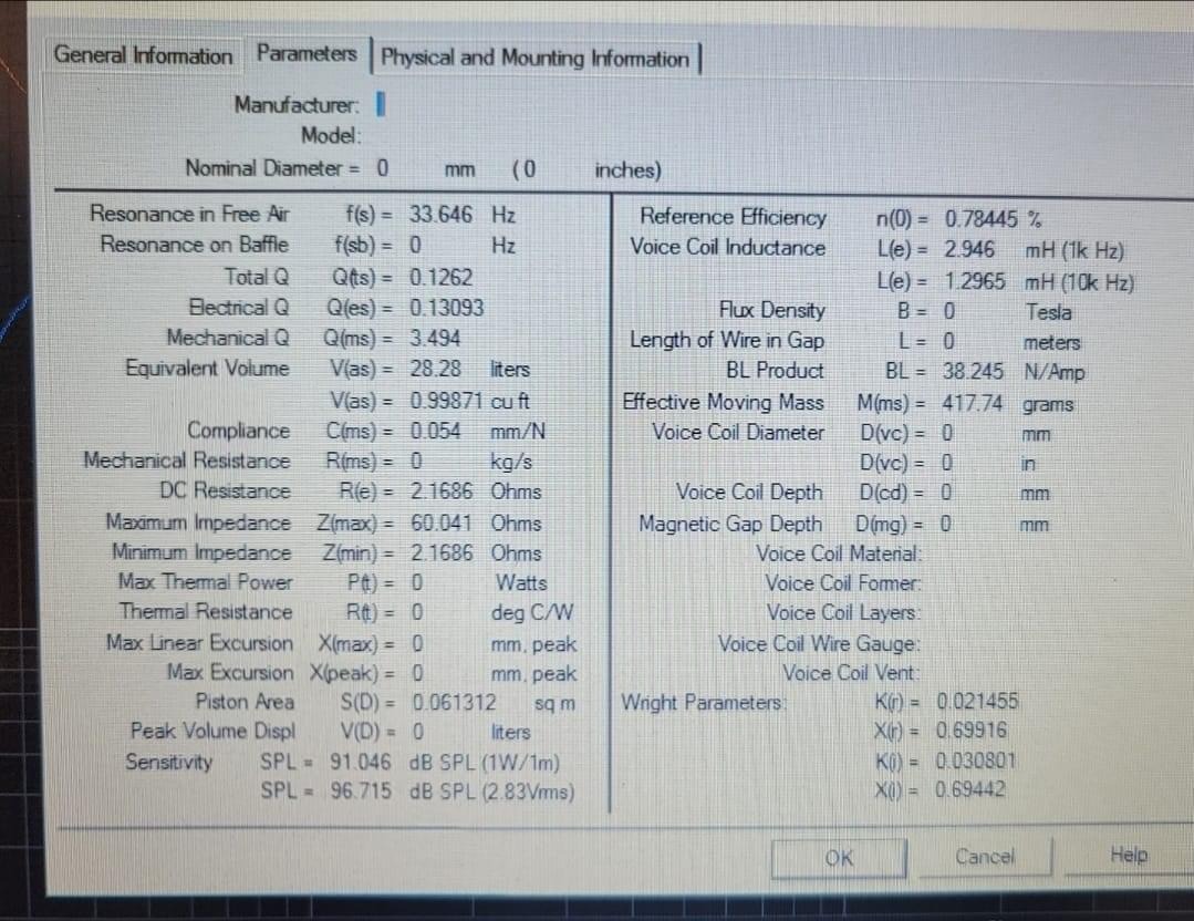

It´s lacking/hiding a TON of parameters, but I was instantly put off by the HUGE moving mass of 418 grams ... almost a pound!!! 😱
Is that a loudspeaker or an Industrial shaker?
Unless some seriously wrong values were put into that simulation software.
Well, Fs, Vas, Qts spec wise it's makes for one serious bass horn driver and with an 11" dia. Sd for a 12" frame can 'see' a massive, near zero stroke driver to handle the high CR required for a very wide BW.
He will build anything . Very seasoned cabinet builder?Well, Fs, Vas, Qts spec wise it's makes for one serious bass horn driver and with an 11" dia. Sd for a 12" frame can 'see' a massive, near zero stroke driver to handle the high CR required for a very wide BW.
Industrial shaker !!😆Don´t think so.
Not an Engineer, huh!Industrial shaker !!😆
Not much clue on Electromechanical devices either?
Here,learn a little on transducers which by themselves have around a pound (or more) moving mass.
Which is NONSENSE in a Loudspeaker.

But What does that have to do with modeling that driver to explore its possible areas of use ? Capt wiki😝
Unfortunately nobody cares about bass shakers unless their neighbor does and your forced to be ‘quiet’/polite or it’s for your kids gaming experience ?
please answer the question like GM always does even if he thinks it’s silly or outta the ‘norm’ ….
it’s heavy. It’s rediculous motor speced and it’s tight as my butthole @ Vas.. but stilll?
what can we stick it in? (and dont say my butthole 😆 please

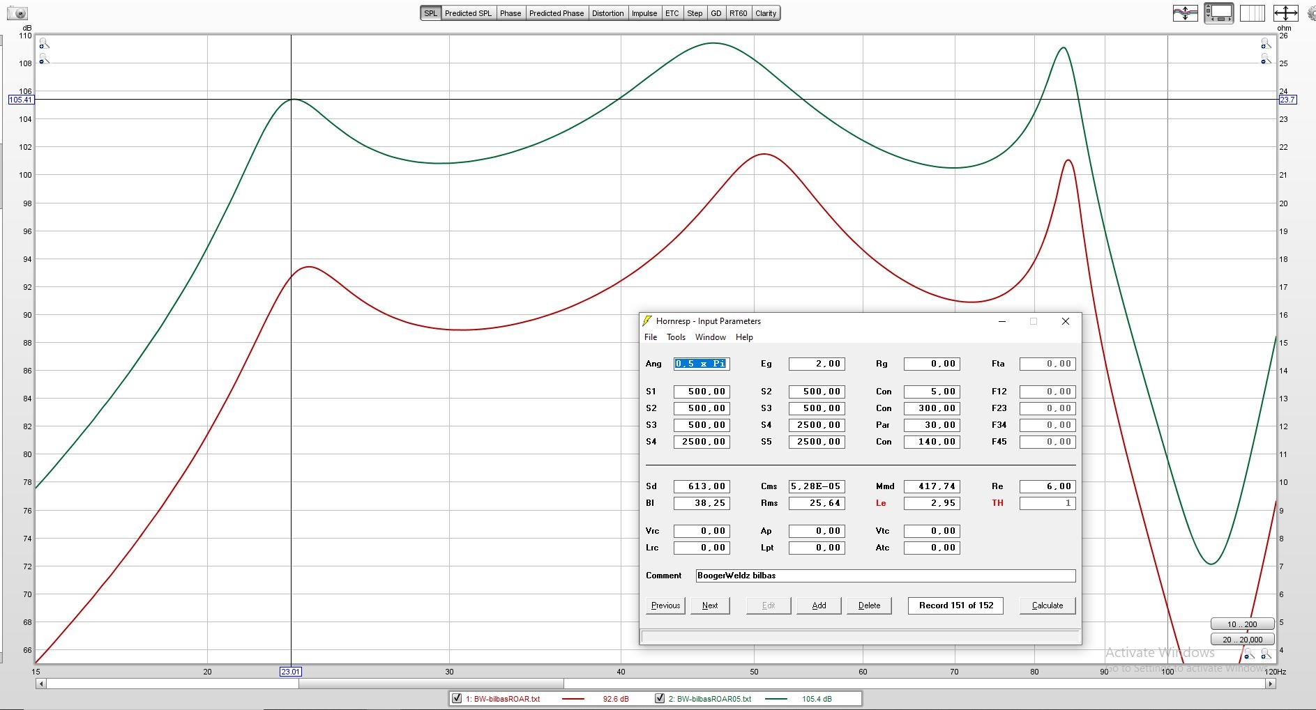

I would build a ROAR-like split path QW 8th order BP and use some (heavy) DSP to even out the response.
Green trace is 0.5 Pi and red trace is 2.0 Pi.
Not a hard sell, he’s seen my roar stuff👍🏼💚View attachment 1113254

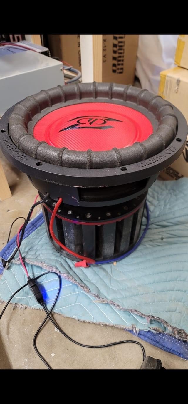

This kind of driver does something no other drivers can. They sound powerful, tactile and physically overwhelming in a way that must be experienced to be believed. And even more so when it is combined with a high order QW designs with lots of acoustic positive feedback. This is a near perfect home theater driver for anyone that does not have neighbors close by. It is the Caterpillar D11 of HT bass (where most people are used to a Toyota Prius in comparison).
Burb box sub.
Designed to do one thing.
Burb at 40 to 50 hz.
just put it in a sealed or ported box.
can DSP the living jango out of it to feel better.
just a comp burb, or a rumble generator for home theatre.
12" would go in the same old 2 cubic feet probably.
maybe 3. dont think it matters.
just gonna burb.
probably the usual 6 grand these thing go for
just gonna burb.
BW: Ask the "car people" or even fire-off a mail to CP Audio and see what they say (maybe they have some magic BP-type recipe). I think it's down to what your application might be and how big a box you want. Seems like you could wring-out an "auto-horn" outta HR if you could deal with all the delay actively. If a different kind of pipe is interesting, try a (enormous) front-loaded horn, maybe. FWIW.
