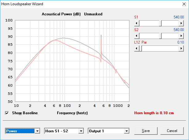

Take a look at my Overdrive 10 project. I have not been left wanting, and I had dual 12" subs prior.
"Overdrive 10" a PR-bandpass sub...

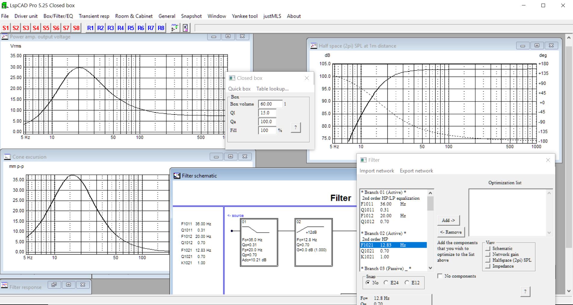

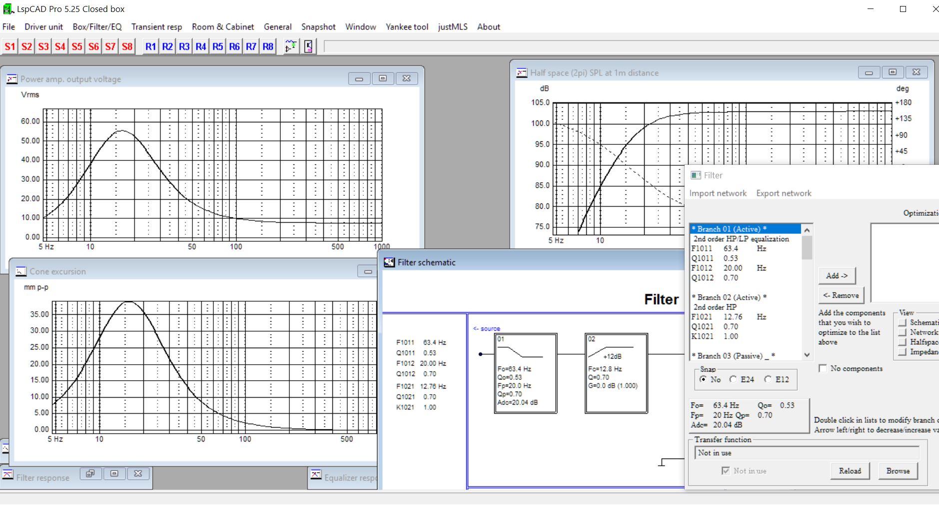

I'm actually going to second what has already been said in that the Alpine sub is already a bit of a beast and if you're having trouble with it then it's most certainly down to your box design, amplifier power or room placement.
I have attached two images that show simulations with the alpine driver. One is sealed, the other is vented.
Sealed the driver needs a very small box, no surprises there. This is ideally how it should be used in a car. A small sealed box plus cabin gain = decent bass extension without any necessary EQ.
In a home environment this is going to need a Linkwitz Transform circuit to equalise the bass to give you decent extension. A high pass, subsonic, filter is needed to protect the driver from excessive excursion at very low frequencies and to protect the amplifier from trying to put out loads of power at frequencies you cannot hear.
As you can see this requires a LOT of amplifier power. This is a dual 4 ohm voice coil driver and I have it configured as being driven by TWO amplifiers, one channel per voice coil. I did this because if you got a Behringer Inuke power amplifier you'd get two channels and that's how I'd recommend you use it so that the amplifier sees a 4 ohm load.
At the peak of the EQ curve and staying within the drivers linear excursion (peak to peak is how LspCAD displays it) the amplifiers are called upon to deliver 55VRMS. This is a lot. In terms of watts.
(55*55)/4 = 750 watts PER VOICE COIL. So 1500 watts in total to get you there. This driver is power hungry. 1500 watts into a 12" driver in a 10 litre box with 100% stuffing = a dead driver as there's no way you'll get the heat out of it.
Still to make this work you'd need a Behringer Inuke 3000 series for that kind of power. Luckily these aren't that expensive. You'll also need EQ. A miniDSP will do this for you, or the Inukes with DSP are supposed to be able to do this too. The filter parameters are shown in the simulation.
You'll get about 98dB at 20Hz. Not a lot, but not bad, with the sub placed in a corner, or at least along a wall it'll be quite nice.

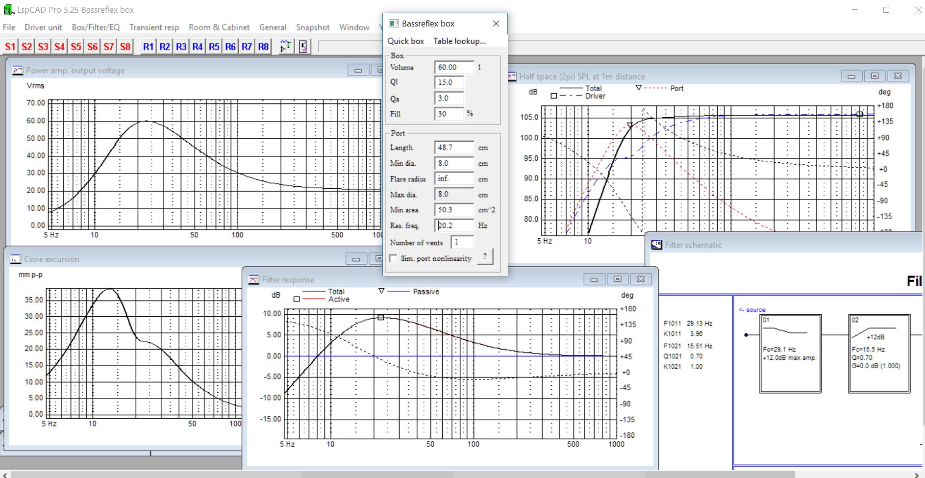

Next is the ported version. This is a much better option in my opinion for many reasons.
The only down side is it needs a 60 litre box, which is quite a bit bigger, but nothing huge considering you have a decent sized room to put it in. 30% stuffing. Port tuned to 20Hz. The issue here is the port diameter vs port length. With an 8cm diameter port we're looking at a port that's 50cm long. Ideally you'd really want two of them but then they'd both be 1 meter long. Design your cabinet to suit. Maybe a slotted port would help here but don't design it incorrectly. Plastic ports/drain pipe will be a lot easier to build and modify to get the tuning frequency correct.
The upside is the bigger box with a port will have a very effective way of getting rid of the heat. I strongly recommend going ported.
This is an EBS alignment, or extended bass shelf. This means that the sub does NOT have a flat output down to 20Hz, or even 30Hz if you tune that low. It is, again, designed for in car use where the cabin will provide the bass boost that's needed for it to sound good.
Look at the amplifier power curves for both the sealed and ported designs. They are actually quite similar in shape. Both need similar amounts of EQ and both need a sub-sonic high pass filter to protect the driver and amplifier against really low stuff, otherwise it'll explode. The similarity in shape shows good driver design from the Alpine team as both the ported and sealed alignments will tune to flat inside a car.
The ported box needs a shelving filter of some sort to EQ the bass up. Again put it in a corner. Again it needs tons of power to reach the drivers limits, 1800 watts total this time. The 3000 inuke is perfectly suited to this. Use one channel per voice coil.
The ported box will give you about 103dB at 20Hz. In room this is a very respectable figure and will make explosions in movies boom like they should.
As you can see, not only is the Sony not up to the job of driving the Alpine, the Alpine (which is a good a very good sub driver if its specs are actually true) doesn't work well, sealed or ported, without EQ. Give it what it needs to work properly and it'll do fine.
So grab yourself an inuke + miniDSP. Or an Inuke with the inbuilt DSP, build a new box and have fun.

I've added a 60 litre sealed design for the alpine. As you can see you still hit the drivers xmax limit at around 98dB, but this time it takes only 30VRMS to get there. This is 225 watts into each coil, or 450 in total. If you want to go sealed and have the space then this is what I would do. The driver will be able to cope with this amount of power and heat a lot more easily, the amplifier will also be happier and you'll get much less power compression.
The response of the Alpine-based subwoofer isn't going to look much like that as the model you used does not include the impact of the semi-inductance parameters.
Attached is what the response (in red) of the Alpine 12D2 driver (the 2 ohms per coil version of the 12D4) in a sealed 35 liter box would look like, when the semi-inductance parameters are taken into consideration.
