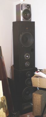

My room is of similar size 10.5' X 18.5' rectangular and I am running four 12's and four 10's on a large amp,Ashley FTX2000.
Although they are not subwoofers and are just plain ole run of the mill fair quality stereo speakers.it gets quite thunderous in here at about 118db or so.
If I were using true subwoofers they would beat this system to the ground for sure.
I am using a mixture of JVS,Technics and I think Fisher cabinets.
Someday soon I will be building a new system but I a sure you that I will be using no less than 4 to 8 drivers per side.
Even as it sits it holds it's own outside very well,Just to give you some kind of an idea.
Because of the length of my room my lowest usable response is around 30Hz or so.
But when get some material the a good bass content it feels like it is just flowing right through my body like the wind does through the trees !!!
If this is the kind of thundering bass you want then I would go with no less than four 12's or six 10's in each corner due to the width restraints.
There are lots of configurations you can choose as this is only one and what I am using and it works very good for me right now.
FWIW
cheers
jer 🙂
P.S. Here are three pictures of my current system the amp pictured is a BGW and is not the one that I am currently using but is in my arsenal,Sorry it was a bit messy at the time I took the photo, Enjoy !!
