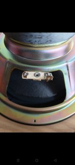

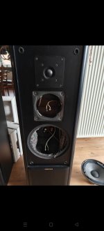

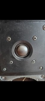

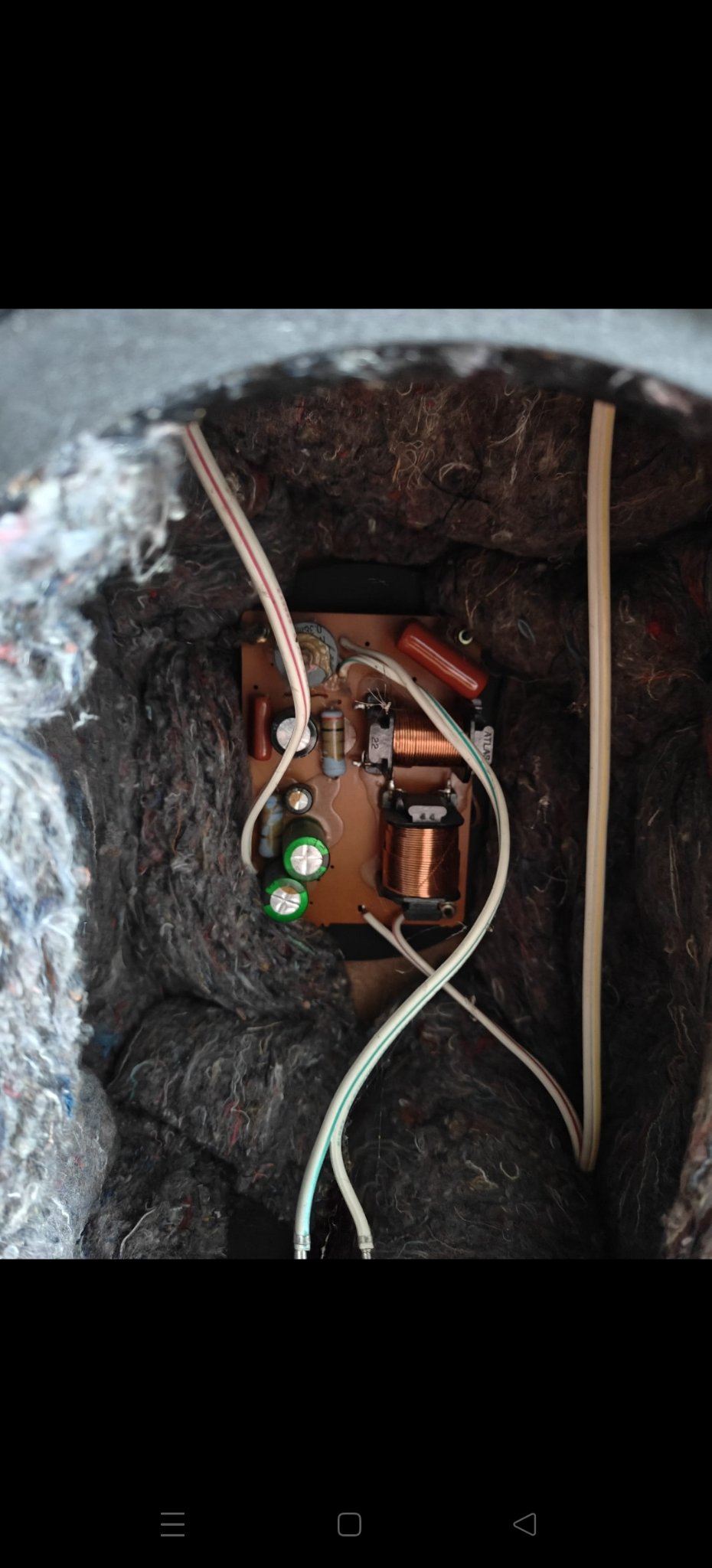

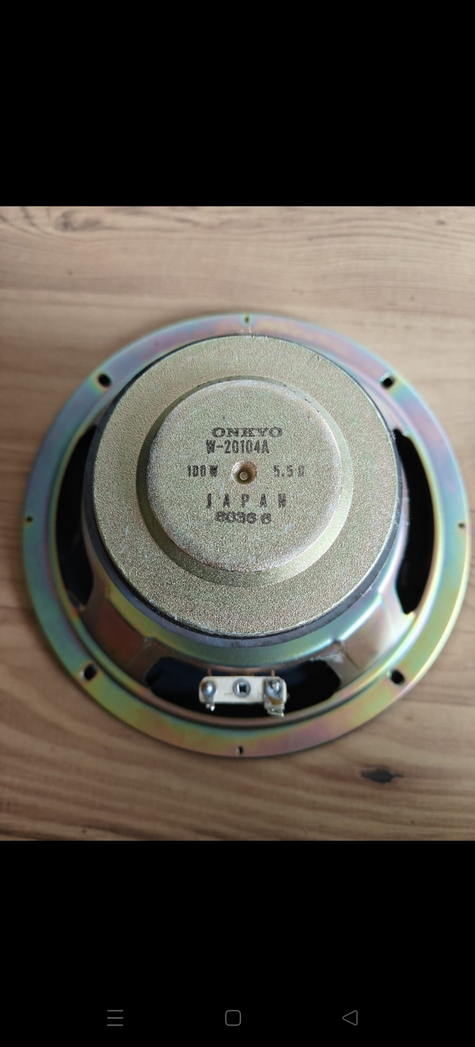

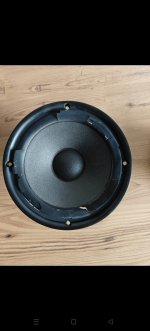

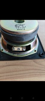

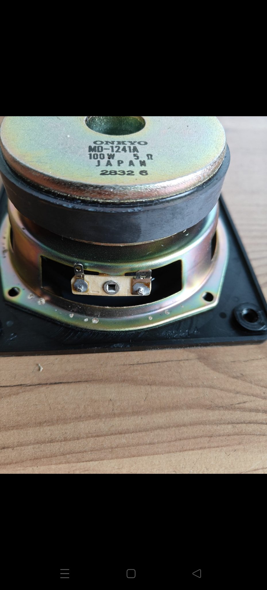

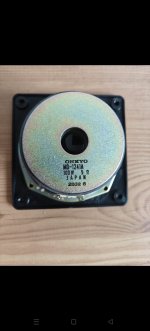

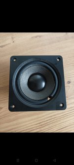

I just recently got my hands on a pair of Onkyo SC-670 floor speakers. I got them for free since the woofer and the midrange speakers are broken. I've looked at a few replacement speaker for the woofers and midrange speakers but I'm not sure if they're the right ones for this enclosure. For the woofers I've chosen the Dayton Audio RS-225 4 Ohm and for the mid range I've chosen the Dayton Audio CF-120 4 Ohm. The tweeters still look fine to me so I don't think I have to replace them. I haven't ordered them yet since I'm not sure if they would be the right replacement for the original speakers since I don't really know much about all of this. I've provided some pictures of the original speakers below.
