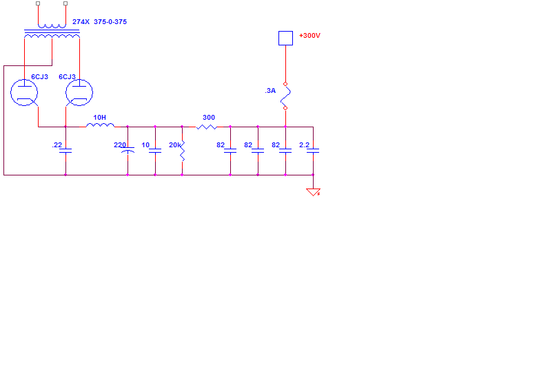

Hi Zigzagflux,
I would suspect the high source impedance of 60K from the pentode based driver stage in conjunction with the miller capacitance of the 2A3 probably completely accounts for the rolloff. According to a quick calculation the -3dB point is around 45kHz, and it would be ~0.8dB down at 15kHz if the transformer was absolutely perfect.. (Assuming Cstrays + Cmiller of 60pF for the 2A3.)
The Schematic, particularly the PS, Lokks very familiar... I would call my version all my own :xeye:
FYI, the rectumfriers are TV dampers, the lower value .22 filter input causes more L input filter action hence lower Vout but better reg, the choke is a Hammond (I beleive it was 81-82 ohm spec'ed), The 220uF is a 550V Jenson and the 10uF an RXF Mundorf, also a 50W Mills bleeder, the 82uFs are Solen PP, I draw about 87mA. Amazingly similar PS 😉
