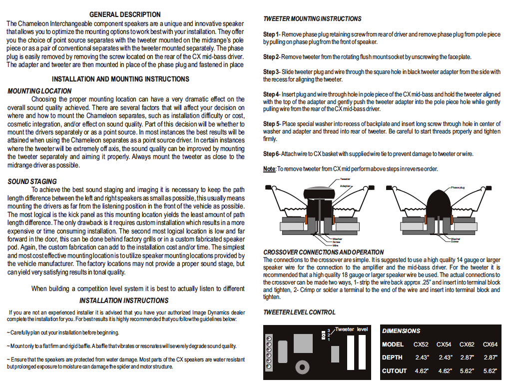

Here is all the information I could dig up and the product document is attached.
Image Dynamics 6.5" CXS 64 component set.
I will be mounting the tweeters at the center of the mid as recommended by the manufacturer in the product document.
Specifications as follows:
Speaker Size 6-1/2"
Design 2-way Component System
Tweeter Design Dome
Tweeter Composition Silk
Woofer Composition Carbon Fiber
Woofer Surround Nitrile Butadiene Rubber (NBR)
Peak Power Handling 250 watts
RMS Power Handling 125 watts
Sensitivity 90 dB
Frequency Response 55 - 25,000 Hz
Impedance (Per Voice Coil) 4 ohms
Shallow Mount Installation No
Top-Mount Depth 3"
Bottom-Mount Depth 3-1/8"
Cutout Dimensions 5-5/8" x 5-5/8"
Thank you

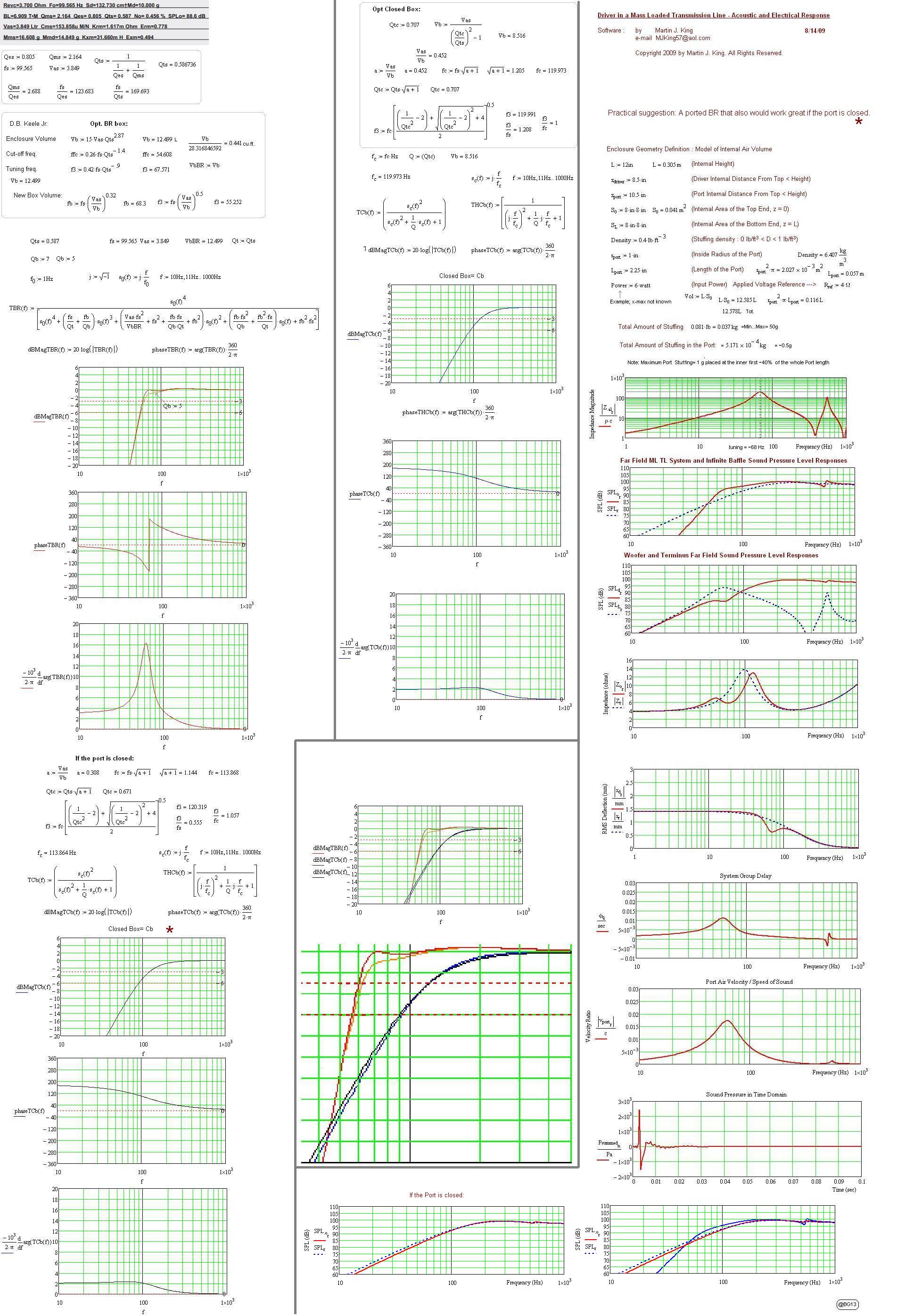

We will need a series of woofer specifications called the T/S parameters.
With these series of numbers we will be able to determine if the chosen driver will function best in a ported enclosure or a sealed enclosure. Once that is determined we can calculate the interior volume of both sealed & ported types. Further we can determine what length of a port tube for the ported style (Diameter of a six & a half should be appx. 2- 3") From there we can calculate a host of performance expectations as derived from some serious math formulas.

A car is not a house. The room matters so don't assume what works in a car works in a house. Now, I prefer low Q sealed boxes so I agree, but you need to do the modeling to see if they will provide the performance in your house you are looking for.
You need to do some reading. We will help you, not do all your work for you. You know, the "Y" in DIY? Go download one of the many free box design packages. I use WinISD. Everything you need is on the bottom of that chart. For a sealed box, basically Qts and Fs is close enough. Ported you need a few more numbers from the chart.
They are car speakers with a high Fs, low Vas and highish Qts.
Sealed and well stuffed 7L to 10L is a about as big as it is worthwhile
doing, but they'll also have no real bass and will need a subwoofer.
Also the x/o's are not designed for small boxes, they are designed
for flush mounting in cars , so you'll have no BSC, which will make
the very restricted bass sound even thinner.
