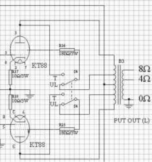

thank you so much mate. i have set them all at 0.55 but when i go into tr mode i can only get a reading from 3 not 4 the v4 will not read in tr mode. is there any reason for this. one more thing i have a pre amp xiang sheng 728a. witch i want to use on my yaqin 100b. what is the best way to set them both up together for a better sound around cheers lee
I cannot see how you lose all valve current just by switching into Triode mode, even if the switch was defective I would expect something to be shown on your multimeter. However, you obviously have a problem with the switching which is as attached. If the amplifier is new, it may be worth contacting the seller. I have no experience of using a pre-amp as I find the output of all my ancillary equipments are adequate to drive the amplifier direct.
