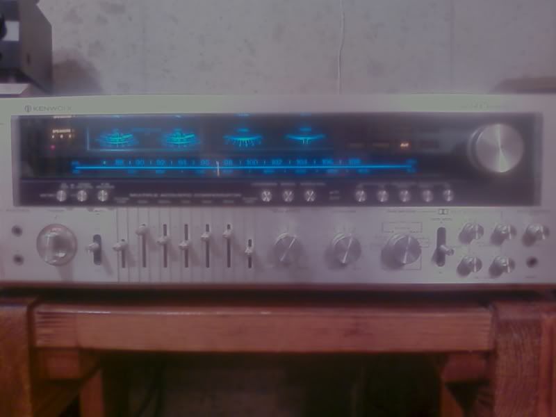

I inherited this late 70's receiver from my father, it's a Kenwood Eleven GX
Anyways, being rather new to the hifi scene I have yet to acquire any gear except for my old vintage stuff that I really don't consider hifi (I've always collected vintage gear, ranging from PA and recording gear, to relics of the "bigger is better" period of the 70's and 80's). Now, considering the fact that I'm only 22 years old, I'm going to guess that a couple of you may actually know more about this amp than me, but recently I discovered while pulling it out of storage that it has two sets of RCAs on the back. One says AMP IN, and the other says PREAMP OUT. It has always had a jumper going between them, and I had never really thought about it, but I decided that there could be a possibility that the amp would be on a whole different circuit on a whole other board within the receiver (remember I come from a generation where everything is mashed together, you know, save money and space and put it on a single board!). Needless to say within the case I found a complete and separate stereo amplifier!
So, here is my dilemma. I've always cared for the sound of the particular amp, even though it is solid state I would say it has a warm quality. However it has always been noisy, at least by the standards of modern and even vintage hifi. As I started playing with it I discovered it was the preamp circuit that was the cause of over 95% of this noise!
I did this by running the PREAMP OUT into another amp of mine, but I also discovered by doing this that a lot of the warm quality I described followed. So I decided to run straight out of my laptops USB D/A into the AMP IN, and control the volume using my laptop. What I found was a very quite amp, not nearly as warm, but much more detailed, and very likable! However I also found two problems...
First is that low frequency response seems to have suffered, not in quality, but in quantity. The built in preamp has a little 5 band graphic equalizer, and I've always noticed that I've had to crank the low and high frequencies to get it to sound flat (yes I know what flat should sound like, I'm new to hifi, but I have degree in music and recording tech. hehe, I'm just saying I'm not your typical teen looking for piercing highs and thumping lows...)
So I decided to plug the preamp back in but turn off the eq, and what I found was a very muddy sounding amp. My theory is the preamp sounds muddy so they give you an eq to fix it. Without the preamp I find no attenuation of high frequencies, and in fact they are very clear and focused, but the low end tends to roll off a tad early. This isn't a huge factor for me, the low end frequencies are there, and actually much improved over the use of the preamp. It's just they are a little quieter than I'd like.
The second, problem is that it seems that one of the channels is slightly louder than the other, I only seem to notice it at low levels. This is something I never noticed when running it as a complete unit, with the preamp plugged into the amp with the jumpers. I don't know what could be causing this issue, but that's what I have you guys for!

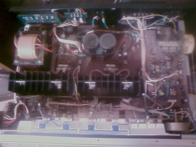

First thing i'd do without question - replace the main power supply capacitors - the two big ones in the middle. This should improve things overall a lot.

jaycee said:First thing i'd do without question - replace the main power supply capacitors - the two big ones in the middle. This should improve things overall a lot.
Ok, so a dumb question, is there any "upgrade" for these? Or should I just replace them with ones of the same values and type?
Either way if I decide to restore the amp circuit all electrolytic capacitors will be replaced, and those in the signal path will be upgraded. Hopefully this would help the low frequencies out. Otherwise I may have to find a schematic for a diy adjustable low shelf filter or something.

Hello despot, Sorry it took a few days to get back to you, I got distracted.
So here's a thought for the main power supply filter caps. Replace them with a similar value, making sure that the voltage rating is as high or higher than the original caps. Then bypass these with some polypropylene and ceramic caps.
The other thing you may want to do that is relatively cheap that will cleanup the sound is to look at the schematic and find the coupling caps between the amplifications stages. Chances are they are electrolytics, so they should be replaced anyway. Replace these with some polypropylene caps, if there is enough space to fit the poly caps. They tend to be larger than the same value electrolytic.
If you do go the route of removing the power amp section and using it by itself, I would suggest that you document all of the connections,etc. Then if you decide to put the power amp section back into the receiver, it will be much easier. Personally, if the receiver is working, I would keep it together. I would only recommend gutting it if it isn't working.

Alright, so I took your advice Dave and left it together. I put the behemoth into my system in place of my Yamaha receiver which I've always thought sounded cold. Well, before I could even replace any caps or anything I've started having issues with either one or both of the channels dropping out. I'll have to troubleshoot it to see if its the amp or the preamp, but if it's the preamp section I may just go back to the original idea of gutting it out.
Does anyone know where I could find a schematic for this unit?
-Justin
Hello Justin, Have you tried using contact cleaner on the pots and input connectors. With equipment of that age, it's quite possible that they are dirty. This can cause dropout on channels. It is also possible that something else, more major, is wrong.
I did a quick google search and wasn't able to find the manual for this for free, but I did find companies that advertised manuals for sale, perhaps they can help. It's also possible that some other kind soul here on diyaudio has this schematic.

So far it seems to act like there is a loose connection somewhere internally, where it is located I have yet to find. I'll probably start seriously looking over the weekend. I'm not too distraught, and if the problem is in the preamp section I probably won't bother as there is alot going on there with the equalizer, RIAA phono pre, tuner, and other tape outs and level controls. If it is in the amplifier section I have no doubt I can fix it, but I am curious what I can do to help the bass response. If I had a schematic this whole thing would be a tad easier I suppose.
