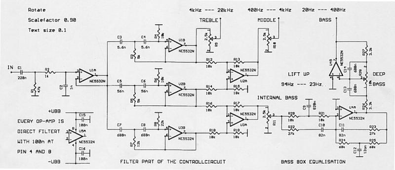

i have just finished a 3-way active filter based on this circuit,
3 Way filter
But when i connect it to my LM4780 amplifier, the sound output was quite low even at full volume 😕
Can anyone please suggest how to raise the sound level,
( do i have to add a gain before or after the 3-way filter so that LM4780 chip gets enough input level signal).

If I bypass the 3-way filter circuit, i am getting the normal sound reproduction as it should be. I am using a My PC sound card output as source.
I have made the 3-way filter exactly as in the article(using opa4134 opamp), now i am facing this reduced output problem. All the filters in that article are at unity gain, so dues a gain stage is required at output or input).

here is the filter schematic
and the link for filter design - 3-way crossover
and i am using DANITY 6" 8ohm woofers, 3" mid and tweeter with it, these are runningexcellent with LM4780 with out the filter, BUT with filter the sound level is decreasing.

Yes, its exactly as per the published circuit diagram of filter..
but any answers to my query??

Well from you tell us, it sounds like the problem is in the filter. And a possibility is that you have made a mistake somewhere and are filtering too much of the signal, or the wrong frequencies.
So check that out first. I know from experience it is very easy to make a mistake with filter circuits.
