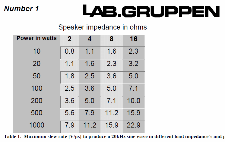

The minimum slew rate you need depends on the wattage of the amp, and the impedance of the speaker. More watts needs higher slew rate, and the same with impedance. Higher requires higher slew rate. The article at the link below provides a good explanation. The good news is that most amps have more than enough -- sometimes by a factor of 10.
Slew Rate - Technical Note
It would seem to make sense to have a slew rate that is high enough, but not so high that stability is an issue.

Yes JCX, I am aware of those calculations that you show. However, I don't think designing an amp that just meets the minimum slew rate is necessarily right. After all, a 10 horesepower car is ample to get you from A to B . . .
In an amp it depends what you compromise to get the higher than needed slew rate. If nothing, then no harm done. Most things in life are a compromise where the best choice lies in the middle somewhere, not at the extremes.
