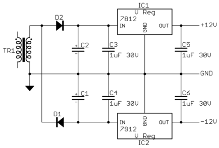

All the suggestions for amps with single rail supply are all good, but...why single rail supply?
You can easily make symetrical supply from single secondary. It takes more caps to filter, but it works just fine.
