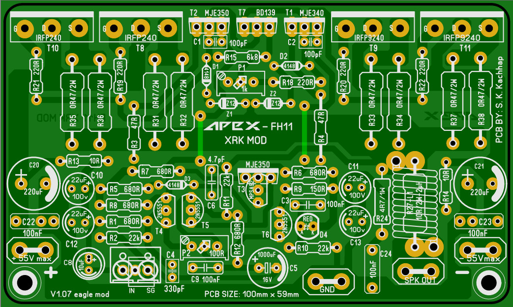

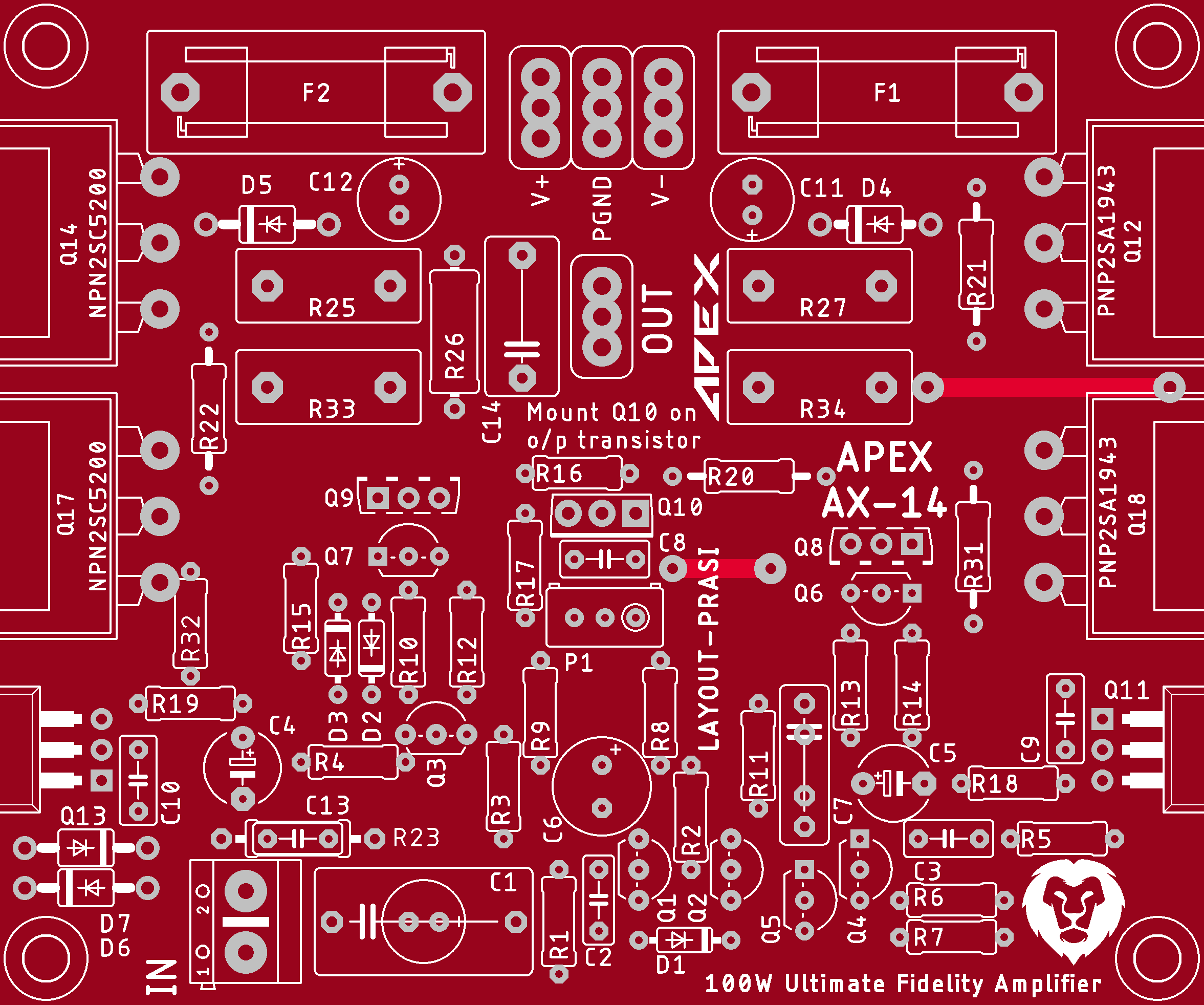

I would check out this thread, suggesting AX14 (2pr. 2SC5200/1943) or the one I built, FH11 (2pr. IRFP240/9240) - both have gerbers available and you can order from China in about 2 weeks start to finish. I think parts are ~$30/channel.
FH11 - green board pic
AX14 - red board pic - google "AX14 APEX" and you will find links to everything you need.
