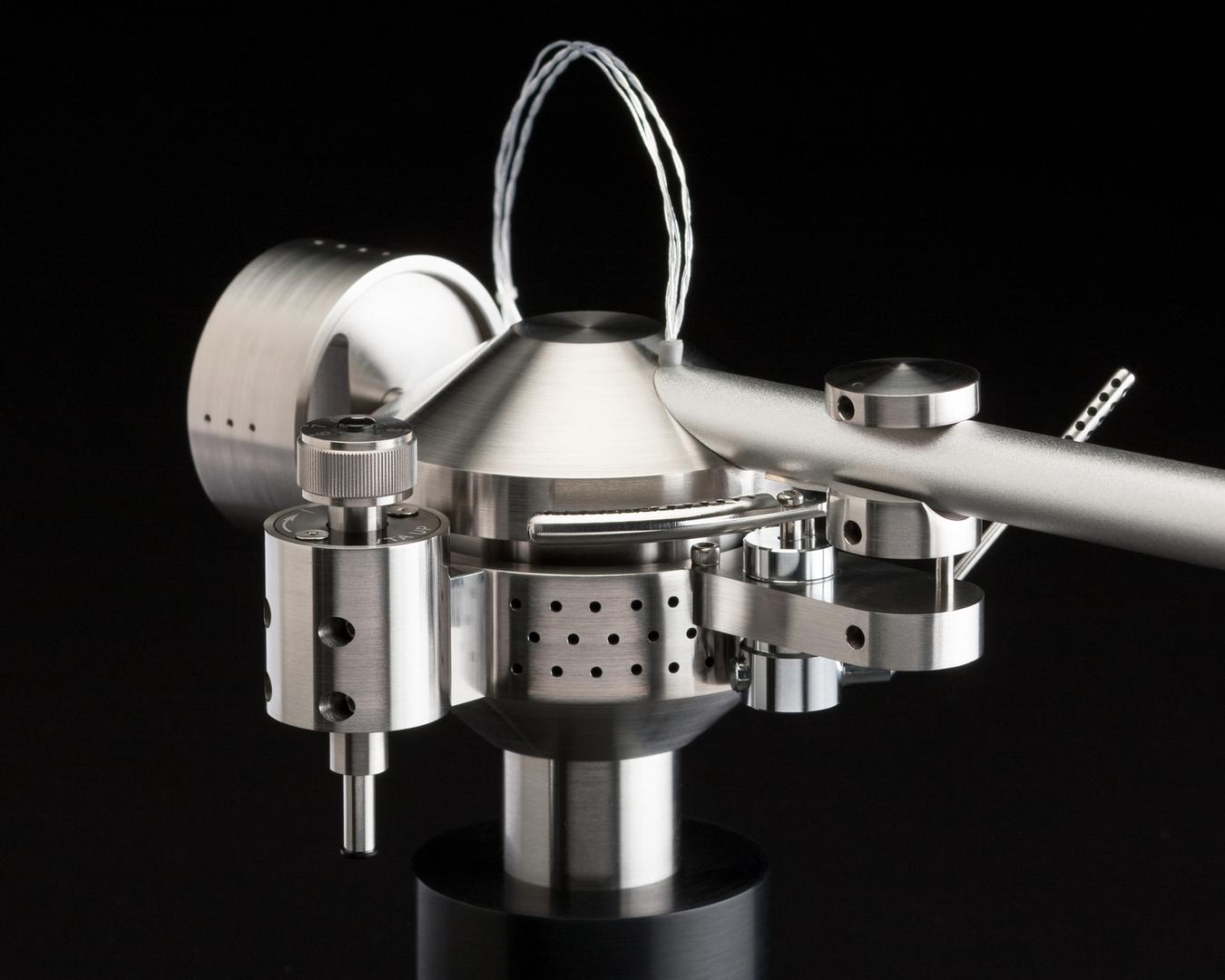

AVWERK said:dual separate signal wiring
Hello AVWERK,
Counting the wires in the "loop", I see two twisted pairs and a ground wire.
How is that different from what everybody else is doing? I must be missing something.
Sincerely,
Ralf
