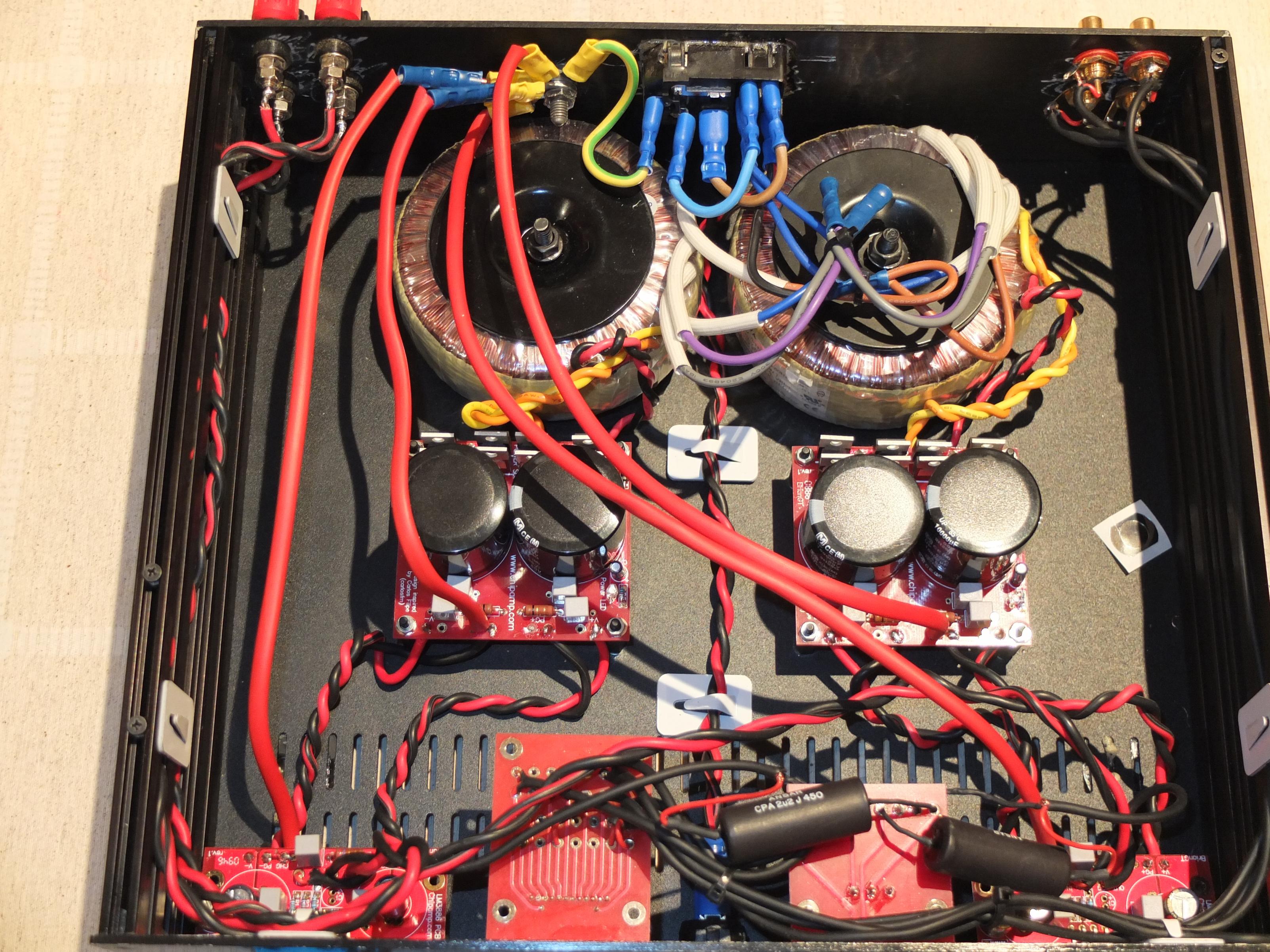

Hi, here's a pic of internals on my amp, as you can see I've only earthed the IEC socket at the moment, but having read almost every post on grounding, for safety issues, I know that I need to ground PSU and amp board at least.
I consulted an electronics engineer who said that my voltages are 'floating' which may explain how I've got 80mv, and 120mv dc offset at outputs (see my earlier thread that died from no further input)
It has been said here somewhere, that dual mono's suffer more from earth loops so I'm worried about that when I come to grounding (star?), or should I just do it and see if I get a hum?
Also, what to ground?
The speaker and RCA's are both isolated from the case, as are the PSU boards, as they're on nylon standoffs.
If I do have to build 1 or 2? Isolation circuits, I know about the 35A bridge rectifier, but at what voltage?
I read (I think) from the very knowledgeable AndrewT, that it need be no more than 50v, but at Farnell the 100v units are cheaper than the 50v ones, so will this do?
I'm buying from Farnell as they're the only people that do the Mentor dials that I want and have to build up to minimum £20 order.
Many thanks to all, especially AndrewT, and by the way, I HAVE read hundreds of posts to try to get here.

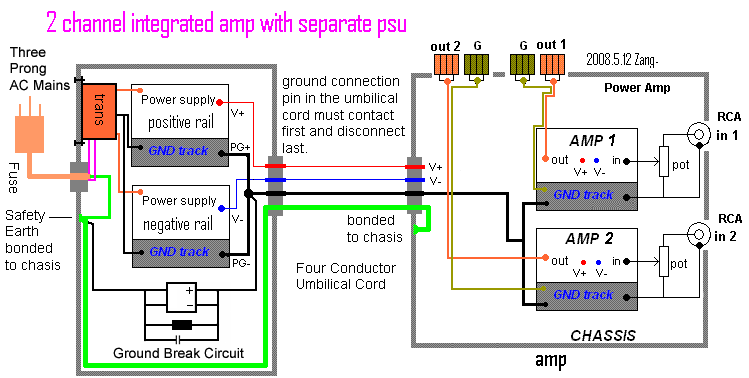

Here's what I unearthed, and I know it's not quite the same, using two cases, but I'm thinking the principal's the same.

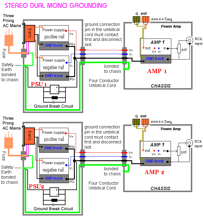

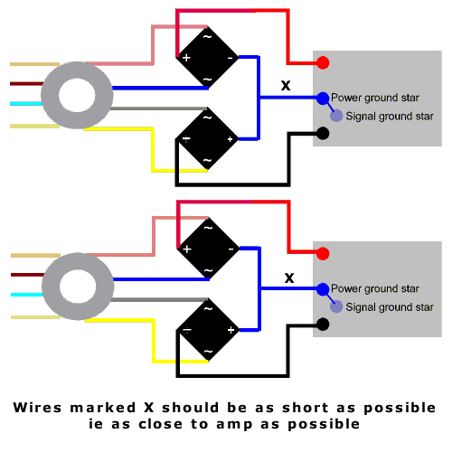

I also found these, again it all looks relevant, but I'm not sure.. second diagram courtesy Decibel Dungeon (another excellent source of info)
Using a bridge rectifier as part of a ground-loop breaker (you must have the RC circuit in parallel with the bridge) is not necessarily legal, but if you do it, the voltage of the bridge doesn't matter because it will never be reverse-biased. It's either off (less than 1.4V between power and safety grounds, only the RC are conducting), or it's conducting and clamping to about 1.4V.
That second diagram you post is the wiring diagram for the supply rectifiers, which has nothing to do with grounding. The first diagram showing a bridge at the bottom left; that's a third (fifth?) and completely separate bridge.
The point of the bridge in the ground-break circuit is to clamp fault currents to ground so that if a wire escapes and touches the chassis, the current all goes to earth and a fuse or RCD/ELD trips. Without the bridge there, a dangerous voltage would develop across the RC. The bridge must therefore have a very high current rating: no less than 35A, preferably 50A or 100A. The most important thing is that it must absolutely have a significantly larger I2T rating than your house breaker or you are introducing an electrocution hazard.
Without the RC, the ground breaker won't conduct at small (<1.4V) voltages and won't conduct RF.

Thanks laplace, with regard to what I should ground, the reason I'm puzzled is that the amp works the way I've wired it, and I don't understand what the zero volt line is shown on that second diagram (this is one of the ones that I read I should ground).
BTW, the toroidal trafos, which actually are 160va, say ClassII (class B) does this mean they're double insulated? Does this also affect grounding?

The transformers are double-insulated and must be so because you don't have physical access in order to ground their cores. If you used a non-toroidal (E-core) transformer, you would need to ground the core for safety, usually by bolting it to the grounded chassis.
Yes your amp will work fine while it works but if it fails it can be a hazard because the audio ground is not attached to safety ground. Consider the following scenario:
- loud music, transformer overheats
- insulation melts between primary and secondary coils
- primary/secondary short to each other at a single point
- you have mains voltage on one of the speaker leads
- the amplifier is still operating and sounds fine
Which is quite hazardous, I'm sure you will agree.
The simplest and almost-certainly sufficient solution is to tie your power ground to safety ground. Run a separate wire from each of the 0V lines (transformer center-taps) back to the frame ground point. It will then be much safer and will probably have no audible issues from grounding. If it sounds good at that point, leave it alone.
You only need a ground-break circuit if attaching the ground point causes hum from a ground loop, eg between your amplifier, a source, their interconnects and their separate mains cables. If such a thing occurs, the better option is not to interfere with the safety ground but to have a non-zero impedance (10R?) in series with the input ground line, ie isolate the RCA outer conductor from (frame) ground and put a resistor between the RCA outer and the input ground on the amp board.
Edit: the 0V (fat black) line on that first diagram is all four of your black wires coming out of the bridge+filter PCBs.
PS: you should use different colors for +V and -V, and (assuming that central pair is switched mains), only brown+blue for mains.

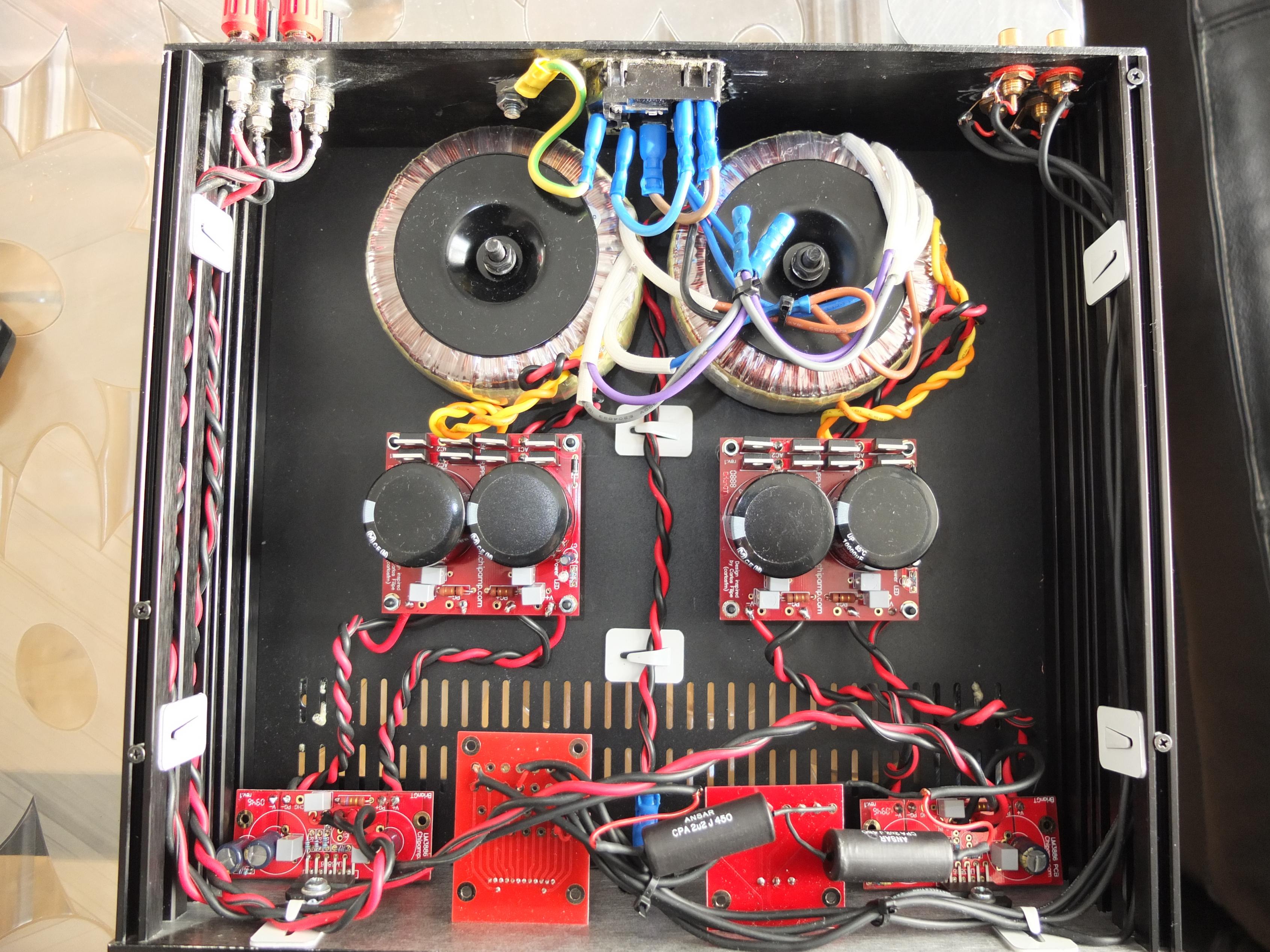

Here's a pic once I grounded the power lines (0V on PSU boards and CHG on amp boards) why anyone would want to ground any of the speaker posts or RCA posts is beyond me, for safety's sake this is all I can see needs grounding as you said.
Well I fired it up and no hum at all.
I was actually quite disappointed that there wasn't any, as I'd worked myself up into thinking I'd definitely get some.
Maybe because I kept all the signal wires away from the power lines.

Hah, you've got even more grounds there than you need now. You don't need to ground both ends of the PSU->amp cables! Just one will do. The only drawback is possible hum and if you have none, then just leave it be.
Indeed, your signal and power cables are very nicely separated and that has a lot to do with why your amp is quiet.
