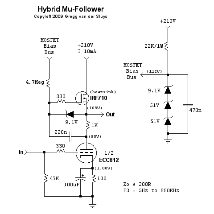

Hi all
Struth, I did write that the Current amp was made with Mosfets, no valves.
A triode valve is used as a V amp, and as I wrote the Mosfet I am looking for is to be used as a buffer. No gain. It is a 'Mosfet Mu Follower' design, which feeds a home designed mosfet amp buffer.
I don't want to start a discussion about the whole design, it works wonderfully and shows sqaure waves up to better than 100 khz with no distortion.
I just want to upgrade my IRF buffer stage between V and I amps with a better To.
The current which flows through the valve is 20 mA and the the Mosfet buffer does not need more than one amp current potential.
I did try some low power high volt Mosfet but the square signal gets worse so until now the IRF 740 is the best I ve tried.

Your mosfet is only conducting the current of the tube, which you say is 10mA. If the mosfet drops 100V then it dissipates 1W and might be a bit hot to the touch.
The IRF710 has pretty low gate capacitance as TO-220s go. It's gate charge is also low as a result.
You say the square wave performance is good and other aspects are good. You won't really "improve" the sound by changing this element in this circuit.
What do you deem an improvement to be sonically? Mu-followrs, SRPPs et al are not known for their warm tube tone - quite the contrary actually. The purpose of such designs is to extract very linear low-THD performance from the tubes, and this may not be exactly what you want, or at least it may not be what turns you on musically.
Larger mosfets will have higher gate capacitance and may slow the response. You can mimic that aspect simply by tacking in a cap across G and S. The same larger mosfet will have higher transconductance which might reduce output impedance and/or improve linearity.

Hi Struth
In fact you are just right ...
I was just imagining the IRF was not the best in class, there sometimes is a hearing difference between two devices that have the right and almost same capacitance parameters...
No, I don't want to modify the sound, I have been used to valve sound and have worked quite a bit with them, even making a very special double power triode amp in A class.
You are also right the IRF heats a little bit, I have put it on a heatsink.
If some here are interested I could find a way to post the schematics of that hybrid.
I had to design mine because I had made 4 of the Pass A Class Zen amps and found them rather disappointing and complex. Lots of heating for no reason. In my opinion rather poor result after lots of trouble.
I went the simplest way: the best for V amplification: one only valve in a Mu follower configuration. in goes about 2 V, out comes 40 Volts easily. With this schematic you can adjust separately all the valve parameters and that is a very good thing. It makes it just easy to have the best results.
Then, a buffer (to help the V amp output impedance to match the Mosfet grid one) on the Current amp which uses the double N and P Mosfets an the same chip. Found them cheap and avaiable at Farnells. They are perfectly tuned and need no extra gimmicks. Specially designed for Hi FI stuff.

Billy, it sounds like you have the performance you need. Time to go to another project.
