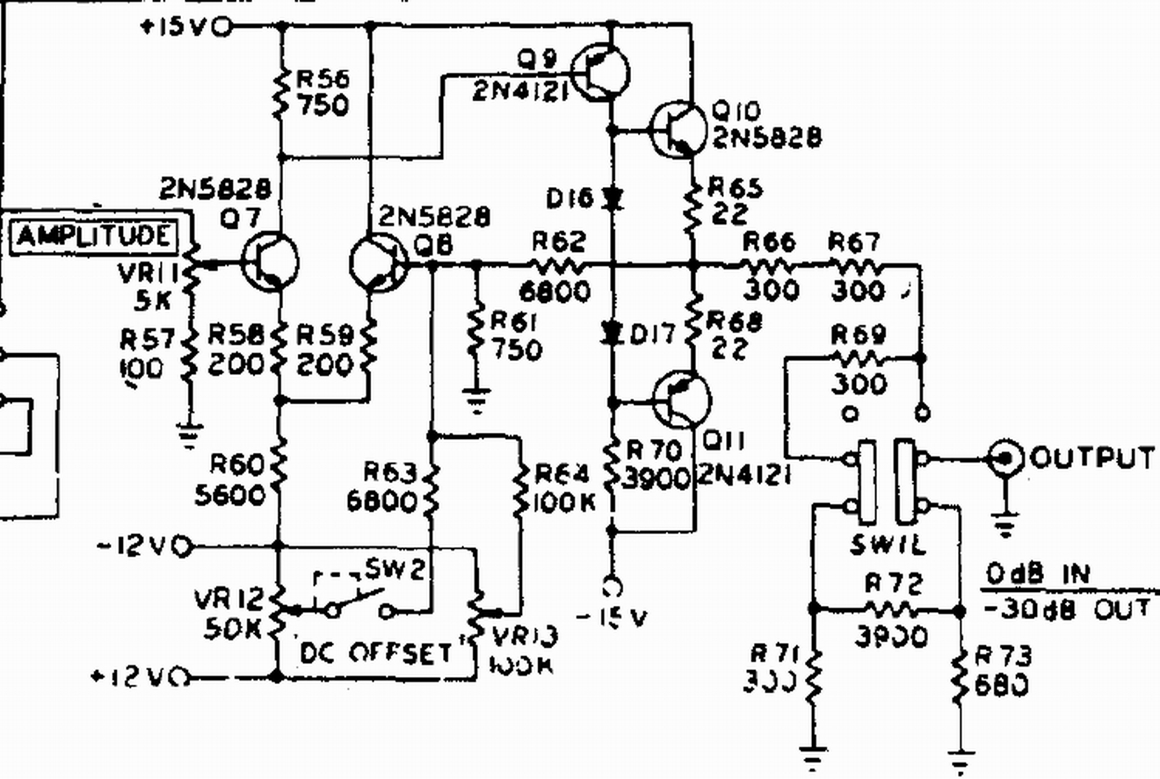

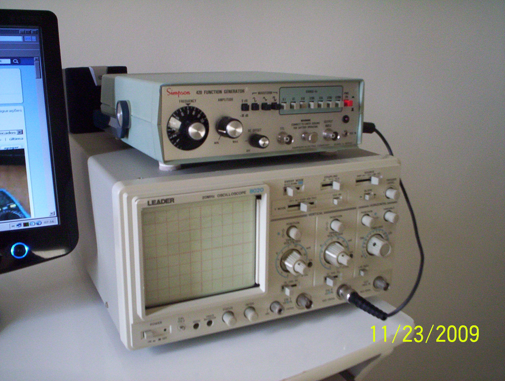

What makes me believe that discrete is better
My belief is based into observation about "what others do".
Many factories decided to discrete into some critical functions... you see this function generator, not so old to use discrete because old..in the same circuit you see TL022 and some other chips, and those are not that bad.
Why they decided to use discrete into the main amplifier, the one amplifies the tones generated, sending them to the output connector...in other words, a very important stage and using discrete when they could use operational amplifiers.
Not only this application, where you need low distortion into the waveform, but some others you can see industries, professionals, selecting discrete components to produce critical, important circuits.
Observe the simple three stages, a differential, a very standard circuit, a voltage amplifier and the simetrical output, all them class AB ... it is very interesting, as crossover distortions are not good to appear into a waveform generator output.
If professionals, using the same voltage to the supply, having nice operational amplifiers, if they prefere discrete.... of course this is a clue that reinforce my belief that discrete is better.
There are technicall reasons that makes discrete better, bigger physical distance (space) between input to output, not needing too much neutralization against oscilations.... less interactions between parts because heat and magnetic fields..and some others too.
Do you think the opposite?... can you please explain your ideas to uncle Charlie..i will be very happy to read you and to learn some new things...please, destroy my belief!, this will turn myself more wise..each belief dell down to ground will drive me more wise.... increasing my distance from the disgusting ignorance.
No.
The output must be capable of withstanding a short-circuit at the max amplitude, and at 2MHz. In this case, the output impedance is a mere 600ohm, unlike the usual 50ohm, but even that would have been too much for "normal" op amps of the time
A function generator has a pretty high distortion figure anyway, typically 1%, 0.3% for very good ones (I'm not talking about "modern", synthetised F.G's, or AWG's).
An AD797 would easily outclass this output stage on every aspect, and even an humble NE5534 could do a good job too... but not a TL022, or a µA741, LM301, etc.
Note that I am not myself an IC "pusher": if you look into the circuits I have proposed, you will see little or no opamps: I am perfectly capable of designing without them, but can also recognize their true value.
One last point: function generators are not designed to be listened to. Or maybe I am missing a point in some new audiophile trend...

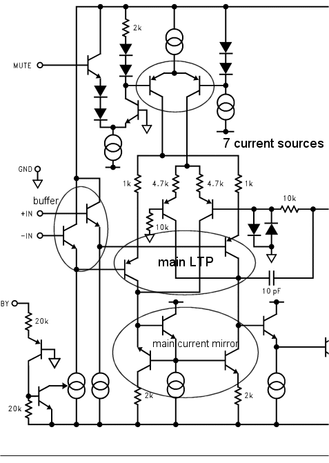

By DX -Ostripper said makes sense too, one more reason to use discrete
That may make sense , but there are other reasons why each (IC vs. discrete)has it 'place".
If you look at a popular IC driver ... (LME49810 - for example)
It's VAS is nothing special -
Just a current sourced one with a self type 2 driver stage. Where we get different is the input stage (attached). Here we have 7 CCS's, mute circuit, 3 current mirrors , and baker clamps (only in the 49810).
They do this for 2 reasons :
1 .The consumer offerings will be using cheap power supplies (IC has super PSRR).
2. They don't want any failures , even if abused by the end user (idiotproof - almost 😀 )
They can do this because having 200 transistors on 1 piece of sand is easy.
As far as the sound , seeing the wide variety of outputs one can drive with these (BJT , darlington , mosfet) , one can not modify the base circuit to give the optimum sound for each type. One COULD do this with a full discrete. Not to say these IC's COULD NOT sound good , but they are made for general high power amplification (OEM) when mated with the right output stage.
