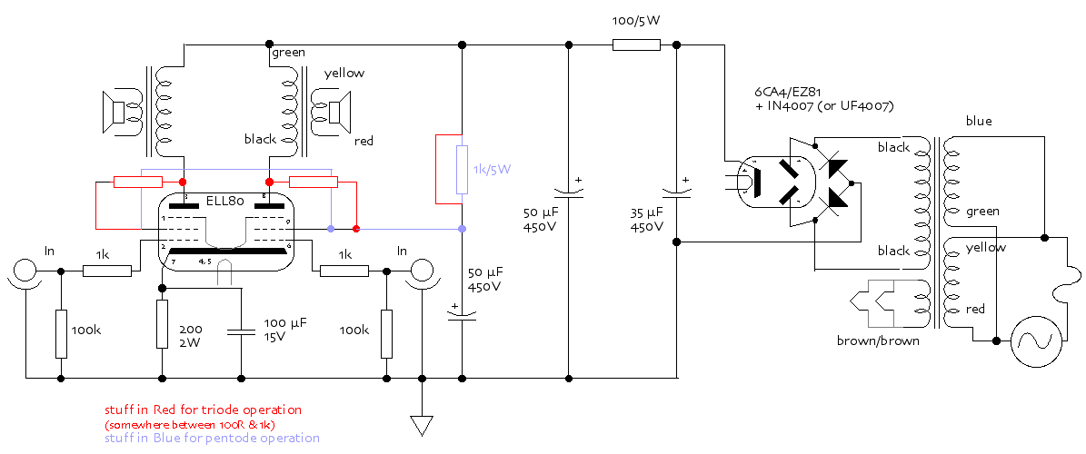

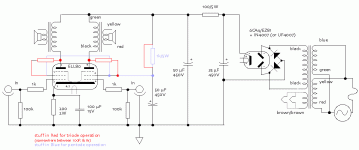

You could use ELL80 or 6360 (=QQV03-10). But why?

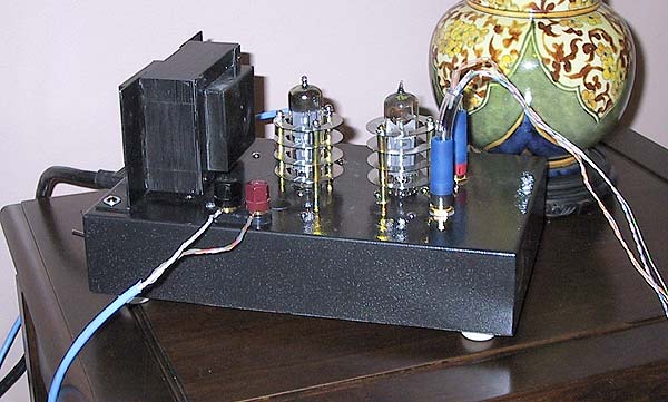

ELL80 makes a cute little amplifier... not much power (~3/4 w in triode)

Two 6LU8, 6EM7, 6BM8 etc will make a complete stereo amp. I think I saw something somewhere where someone made a stereo amp out of a dual power tube using input transformers for some voltage gain to drive them. Sorry I don't remember which output tube or where I saw it.
