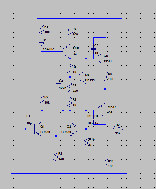

What kind of VAS is this
Greetings!
About a year ago a fellow here helped me to make this crapy amplifier, which works suprisingly well.
I dug up the schematic the other day and i keep on wondering what kind of VAS is this?
I do not understang this configuration, or how it functions so i will kindly ask if someone has some spare time,
to explain to me what the hell is this config. I read Bob Cordel s book but its not in there.
Im still thinkin about it tho. How would you aproximately calcualte the voltage gain and the input, output resistance of this VAS?
I know how to do that for one transistor VAS Rc/2*(re + RE), but i havent the slightest idea of how to proceed here.
I know it isnt worthwile analyzing this circuit because its fairly crappy and nothing special, but nontheles i am interested as i am learning about amplifiers
and am very curious🙂
