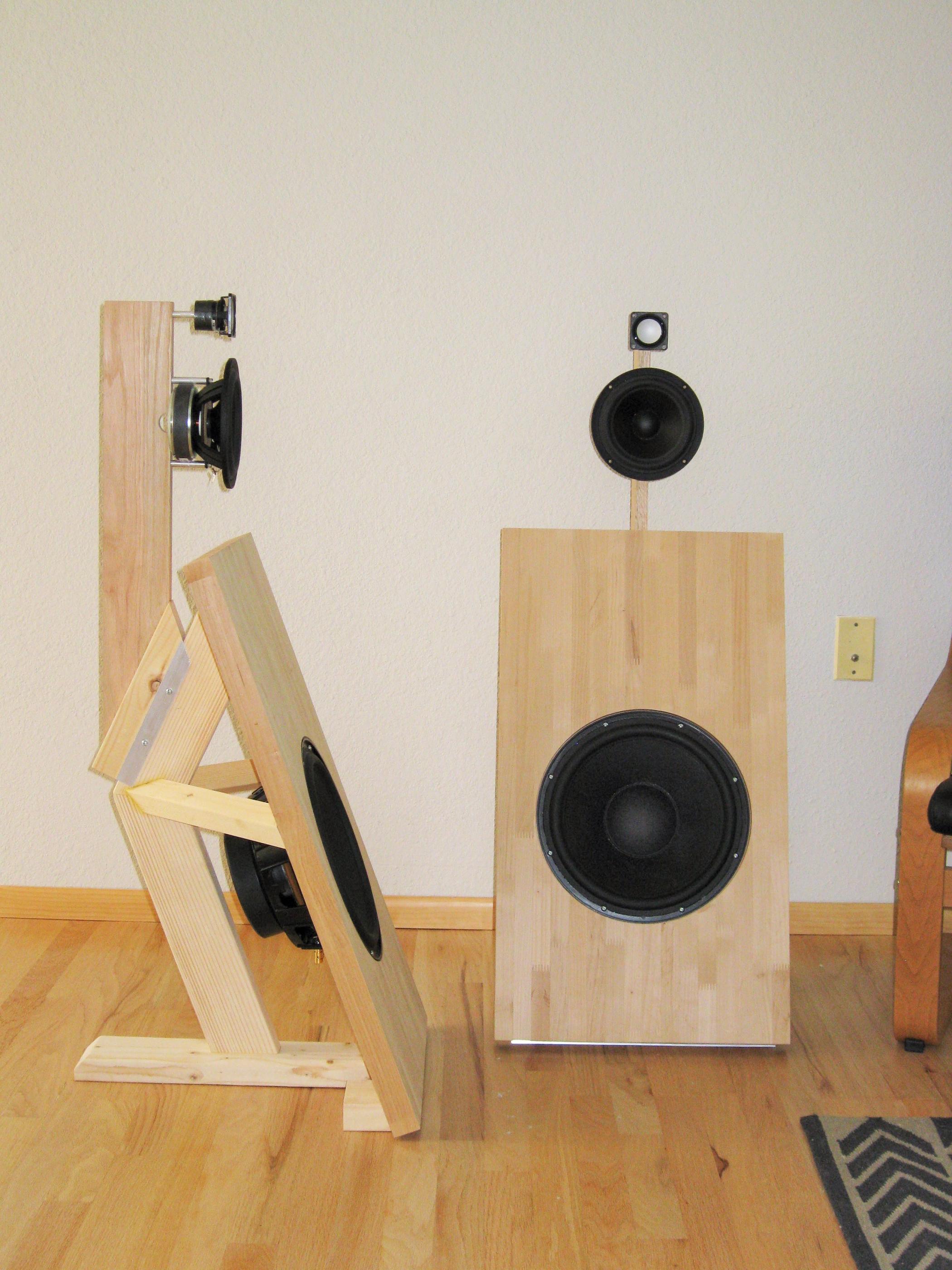

It's no problem that you disagree, however, I think you are using a bit of a broad brush and misconstruing what I had in mind. I should have provided an example, so I will do that now.

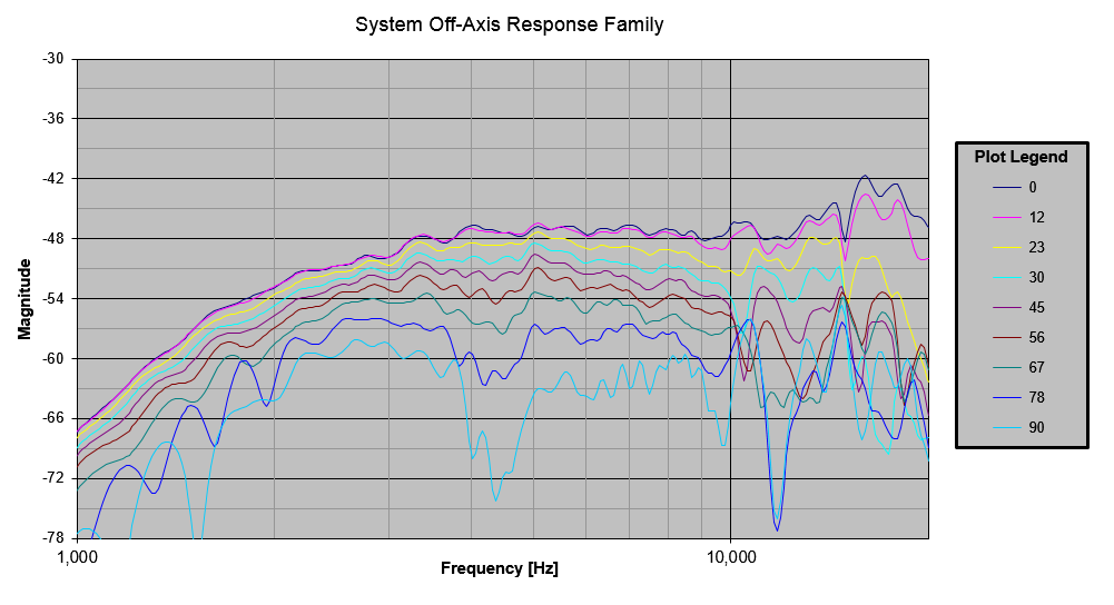

One such driver that I am using in a 3-way, 80Hz-20kHz, open-baffle nude system (I have attached a pic for reference) is the Tang-Band W2-800SL:
Tang Band W2-800SL 2" Aluminum/Mg Full Range Speaker Driver
This driver has very good off-axis response up to about 15kHz and extension is to 20kHz or so, depending on how you want to look at the FR curves. This is because the radiating surface is really only about 1.5 inches wide, making more a member of the "tweeter" class than the typical "full range" driver. It's a unique driver in that SPL is relatively high (86-87dB/W) and distortion is relatively low. I cross over to it around 2kHz or so. This is about where it's own baffle peak is located. Once I use EQ to flatten the frequency response curve the result looks like the attached plot. Very, very nice.

With regard to rear response not being the same as the front, I'm not a dipole purist. I just want freedom from the box. There is rear radiation, but as you mention is it not exactly the same as the front. I don't find this to be a problem.
