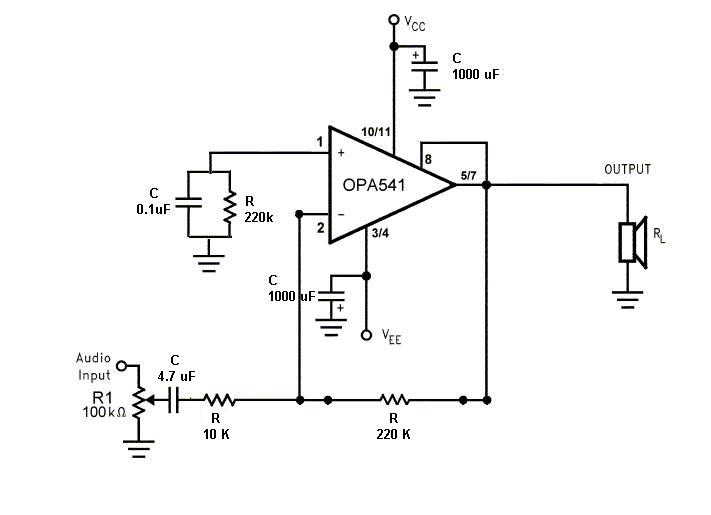

What is your opinion on this schematic for OPA-541
Hi everyone,
What do you think about this sch. ?
It was applied from Inverted LM-3875 sch.

I just tried it out with no Rcl at pin 8 ( not connected, just leave it ) and use 100k pot. 24-0-24 transformer with UR1620/1620R give +/-35 v to the chip.
I'm facing the opposite problem, sound come out too loud.
dont' know why :whazzat:
When listening at volume ~10% I feed lack of bass, need to turn the volume about 25% way to get sufficient bass but over all sound come out too loud.
I'm not sure if the gain is too high or not ?

Here is an app note for OPA541, about how using Current Limit.
http://www.ti.com/sc/docs/psheets/abstract/apps/sboa057.htm
The pin 8, should be conneted to output, if you do not use Rcl, resistor for Current Limit.
If you use 4.7uF - 10 kOhm at input, there shouldnt be a problem with bass.
And gain of 22 should be a very good value with signal from CD-player.
You should add a zoble network from output(pin5+7) to ground.
One resistor 4.7 Ohm (2/5 Watt) in series with 100nF capacitor will be good.
Will make your amp a bit more safe.
And avoid high frequency oscillation, which not always you can discover and know is there.
Looking at THD+noise diagram, and at 1 kHZ
0.07 % at 50 Watt is very good!
0.11 % at 5 Watt is strange, but still okay.
Normally I would expect lower distortion at lower power output.
Maybe somebody can explain ?

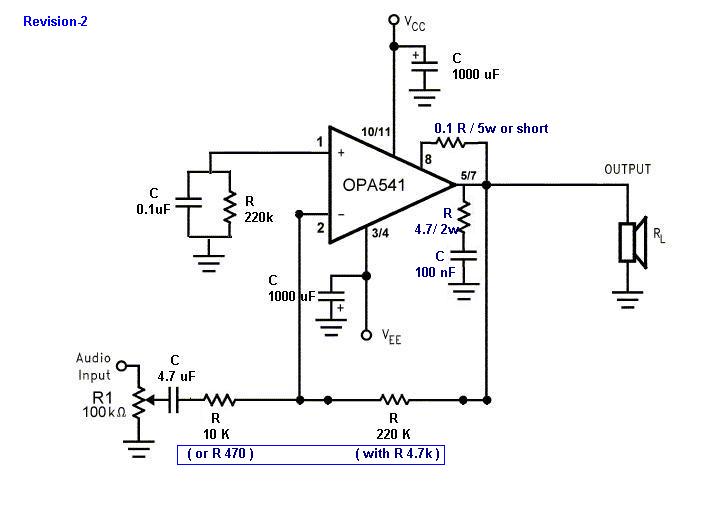

Every one,
thanks for your input. I try to correct my sch. follow your advice, is this seems to be ok ?
After changing from a cheap pot to a stepped atten', output that used to be too loud become normal. I have to turn the volume up to 50-60 % at normal listening level.
I found this opa-541 (20 hrs used ) give a tighter bass but the old 3875 ( 200 hrs used) with a basic sch. as above give better detail. 🙄
What is your experience on this 2 chips ?

The 4.7uF input cap and 10k resistor sets the rolloff of low frequency.
It is a high pass RC filter.
The filter has a roll off frequency, and passes frequencies higher than this roll off frequency.
If we call this freq 'f'
Formula:
f = 1 / (2 x pi x R x C )
pi = 3.14
Using 10k and 4.7uF we get:
R = 10.000
C = 0.0000047
f = 3.38 Hz
At this freq bass is -3dB
10 x 4.7 = 47 (kOhm x uF)
If you keep 4.7uF cap and makes 10k resistor 1k, we get
1 x 4.7 = 4.7 (kOhm x uF)
As this value is 10 times lower, the frequency,
according to formula f will be 10 times higher.
So you get roll off at 33.8 Hz.
This filter will pass frequencies higher than 33.8 HZ
but begin to block lower freq.
I personally can accept a roll off at f=10 Hertz.
If RC =
15k x 1uF = 15 (kOhm x uF)
This makes f = 10 Hz, almost
1.5k x 10uF = 15 gives the same.
To keep your f, now 3.38 Hz
and use 470 Ohm resistor, you will have to increase Cap
to keep RxC the same.
As R is 20 times smaller ( 10.000/470 )
your cap need to be 100uF. (20x 4.7)
This is the drawback of using too small resistor, instead of 10k.
You need a very high value cap.
And as we want to use film cap (polypropylene, 9/10 people agree film cap should be used in input)
this will be a little problem.
10uF you might find (or parallel two 4.7uF) and if you make resistor 1.5k
you will have roll off: f=10 Hz
I would not recommend lower feedback resistors,
than 1k-2.2k and the other 10 times higher
for example 2.2k and 22k
