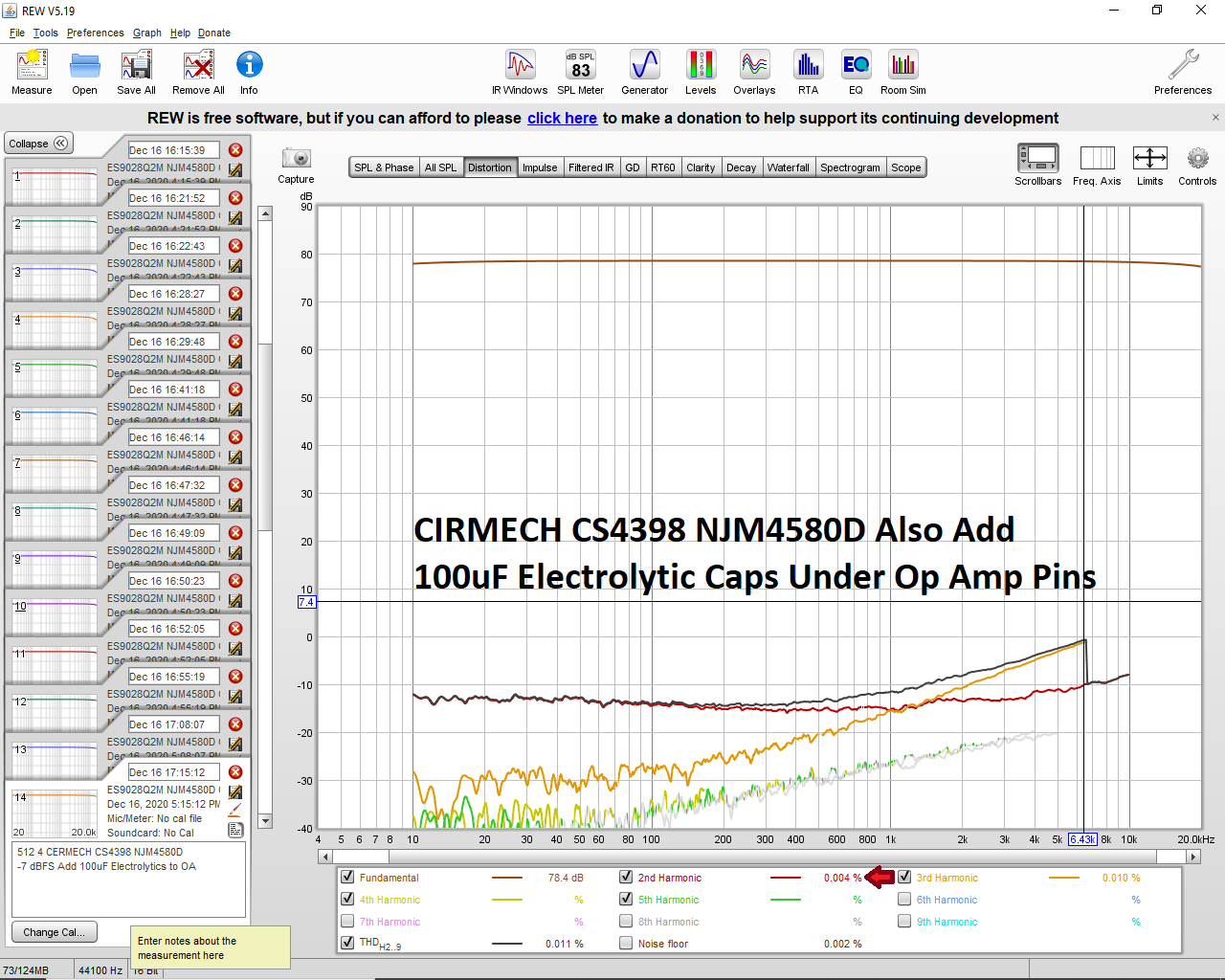

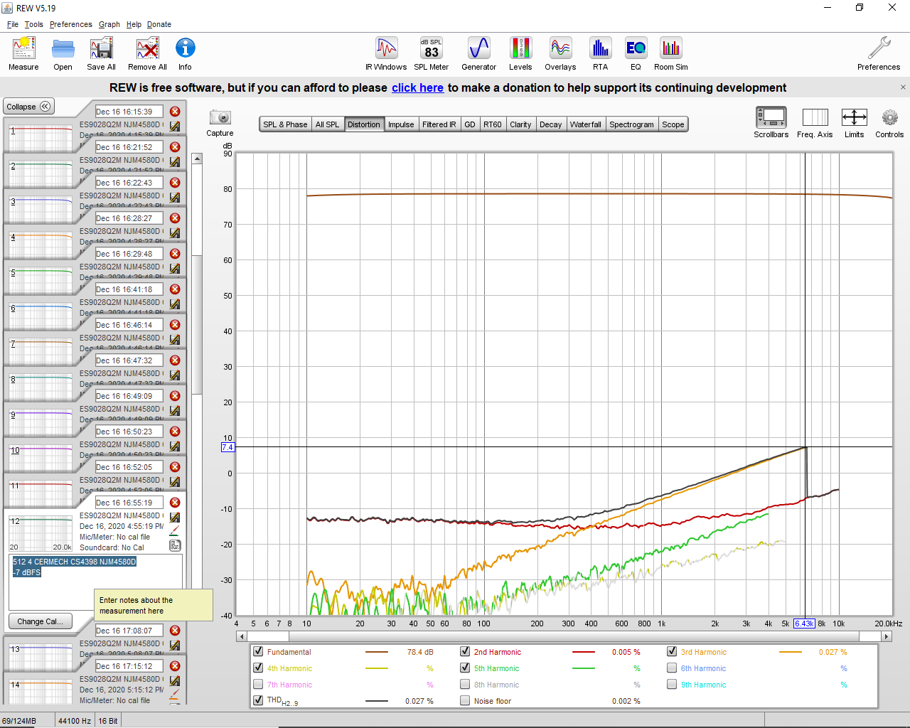

What Is Wrong With This DAC? There is significant distortion and it measures far worse than the LJM CS4398.
Attached Picture: Measurements of CIRMECH CS4398 DAC With NJM4580D.
Does anyone else have this DAC? Has anyone else measured it? FYI: I remeasured my ES9028Q2M to make sure I did not have a problem with my ADC.

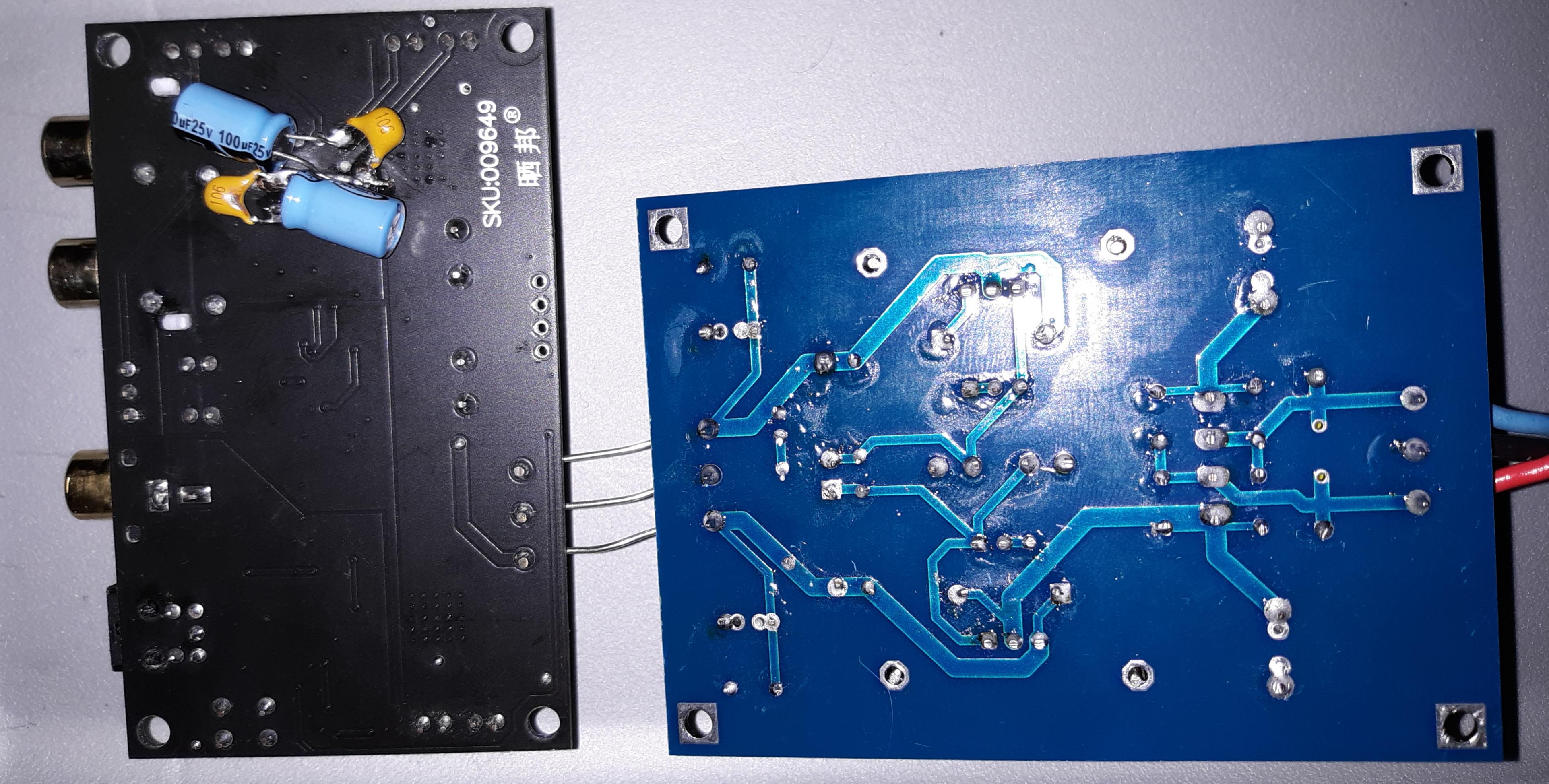

So far I was able to achieve an approximate 10 dB improvement in the harmonic distortion by adding two 10uF monolithic ceramic capacitors directly under the op-amp and soldered to the socket pins. I also bridged the ground plane which was split under the op-amp due to poor layout/routing. It only has 2 layers but the layout could have been much better.
Adding two 100uF electrolytics (next step) improved the second harmonic but no change to the huge 3rd harmonic.

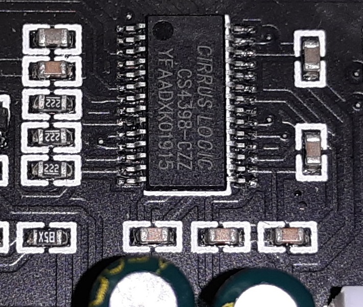

I assume the rest of the problem is related to the terrible bypass capacitor placement, layout and grounding for the CS4398 especially the analog Vcc and related pins on that side of the CS4398.
I am not sure it is worth the effort trying to use copper tape or copper braid and additional capacitors to fix the analog bypassing around the CS4398. It looks like this is a terrible design. I liked the LJM CS4398 and thought this board would make a nice easy way to add coax and optical input to my project amplifiers.
