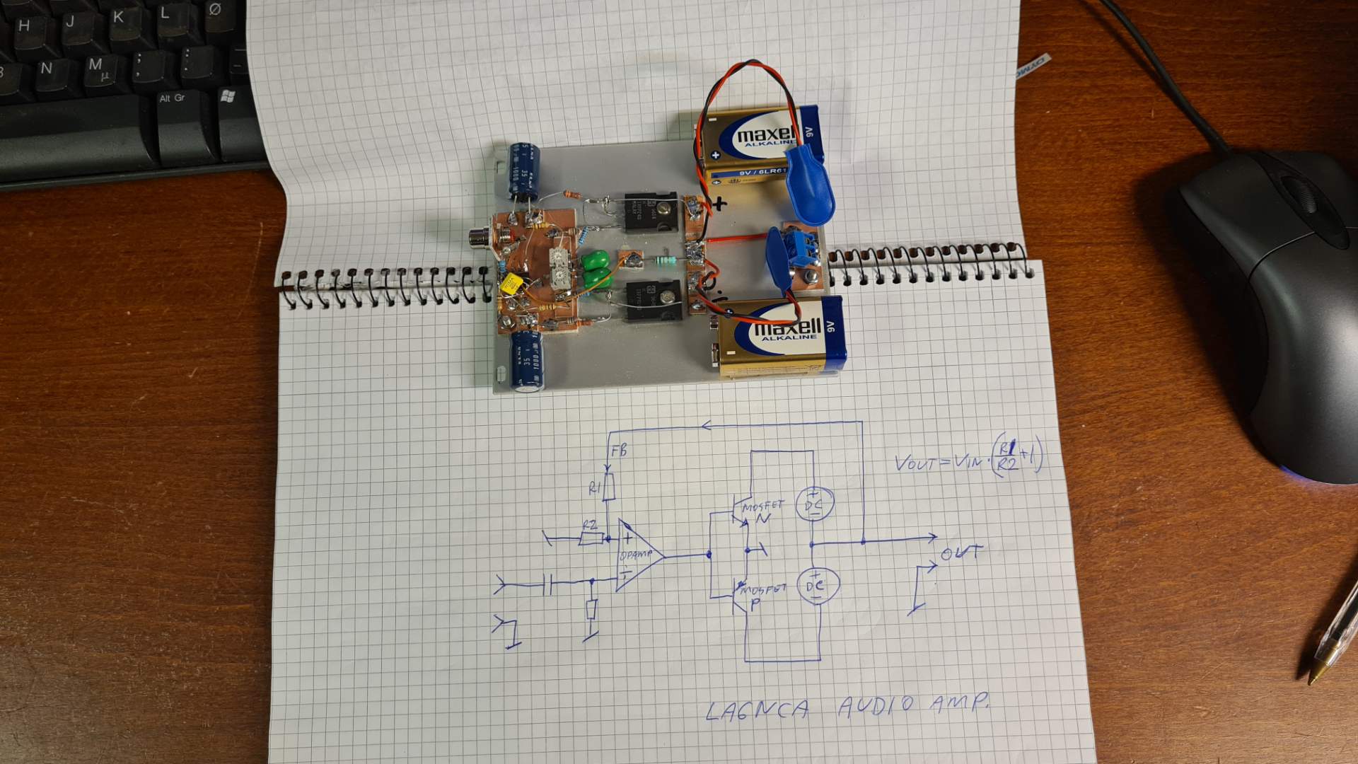

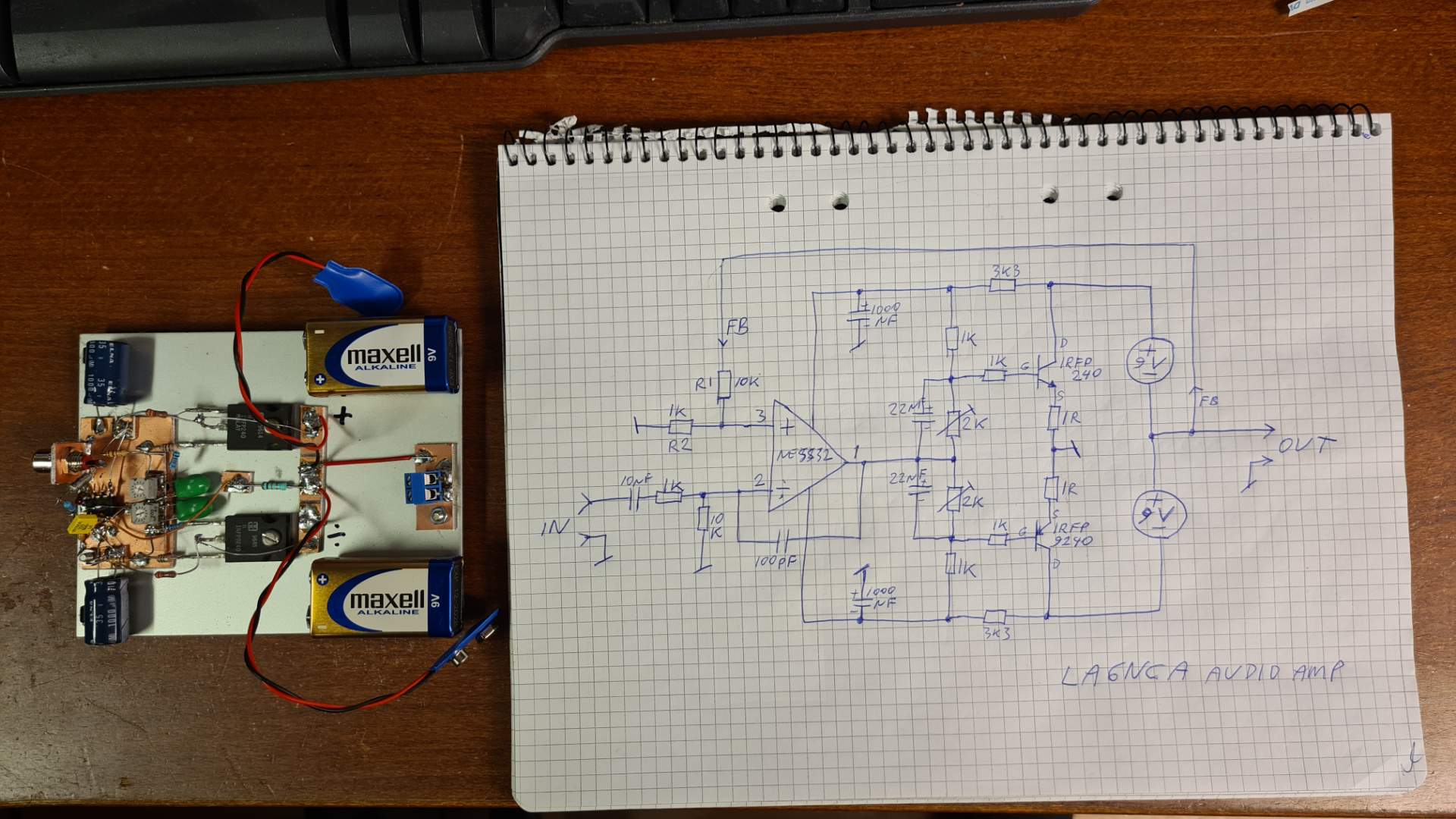

I have a former college that has revived an old amplifier design he thoughts out may, many years ago. The design is highly unusual, where the output stage is "driving the power rails". In the pictures I've posted of this design he is using two 9V batteries as the power source. However, his old design used a +-50 or 60V power supply, and had loads of power. It sounds really good and has very little distortion. I think he's about to make a youtube video about it (the last design he uploaded created some discussion on this forum), so I'll post the video here when it's ready.
I happen to have an old Altec Lansing 9444B power amplifier (manual and schematics here), and I believe this is design around the same principle. It is a two channel amplifier, but it has two secondary transformer windings, two bridge rectifiers and dedicated smoothing capacitors for each amplifier channel. The neat this with this amplifier is that the all the output transistors, both NPN and PNP are connected to the same heatsink without any insulators, and the heatsink is grounded. Apart from this, I don't know why this design is preferred over the more usual ones.

It's a Class AB and I've come across it before. It's really just a matter of moving the reference voltage to a different part of the circuit. Instead of the output swinging in relation to the supply, the supply is swinging in relation to the output. If I remember correctly the advantage is that you can run the rails at a higher voltage than the max voltage the opamp can handle.
It’s called a transnova. It makes a low component count, fairly fault tolerant amplifier. With the only real weakness being the requirement of each channel requiring it’s own power supply, since it floats.

Common source/emitter and has voltage gain, but it biases like an emitter follower or CFP output stage. It just drives the ground node instead, and takes the speaker out from what is normally supposed to be “ground”.

The first amps I saw that used this topology were QSC about ~1980. Two main advantages are:
1. The limited op-amp voltage range is plenty to drive the common emitter outputs, which handle the high voltage supply. This is probably the best op-amp IPS design because you don't have a lot of extra stuff to adapt the op-amp limitations to serious power amp voltages.
2. The power supply has no DC center tap, only two series capacitors which provides DC failure protection with no startup and down DC thumps.
