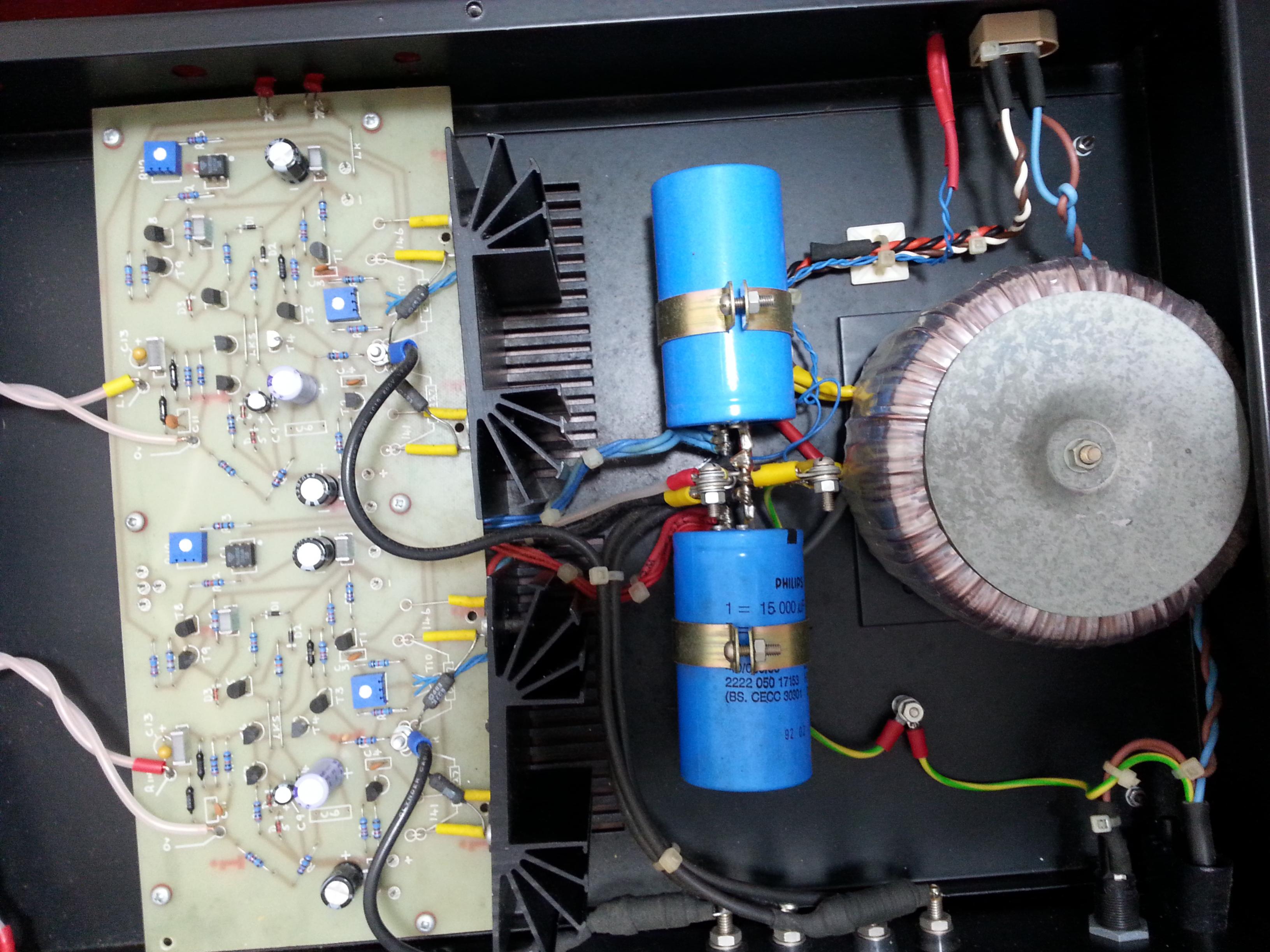

Without saying too much about the make or model, can those in the know say what they think of this power amplifier? I don't know how much you can tell from a picture, but any observations relating to quality and value of the item would be interesting...

Strange choice and use of that heat sink. No apparent
thermal feedback for biasing. Pretty wimpy board
tracks for the high current stuff. No attempt to use
spare board space as a ground or supply plane.
Hard to work out the rectifier arrangements.
Whatever it is I'd say its not mainstream.
Value wise I'd say nothing special, at all.
rgds, sreten.

power wires ditto to bottom side , there is thermal feedback on heatsink (3 blue wires)
though , info about outputs could say more ......
I think there is something interesting , but hard to say more just from pic
and - that's certainly one of wimpy UK amps
Darling-ton
Hi, Yes I missed that looking for traces, rgds, sreten.
Looks like the outputs/drivers are point to point wired direct to the PS (on the
heatsinks.
What's left on the board is apparent , LTP , servo, CCS's , VAS. Don't see the
driver pads , but do see the Vbe out on the twisted triple (3 blue's).
A shot of the other side would confirm.

The heatsinks look to be substitutions since the output darlingtons are wrongly located on those extruded sections and the narrow ventilation slots don't cover them properly for cooling efficiency. Guessing they could be 72 mm high, would give a free air rating of 2.2°K/W or 2.5°K/W if 55mm high. That's not a lot of cooling when the parts are fitted incorrectly in a poorly vented enclosure.
Even though there is a reasonable sized transformer, perhaps the amplifier should only be rated about 30W/ channel? 😀

Looks like a one-off build. For all the previous comments I would have to agree that some parts should be recycled, some shouldn't.
Either that or it's an overbuilt DIY headphone amplifier.

(40W, the bridge rectifier is a KBPC type inbetween the lytic cans, wire links to the capacitor solder lugs above it)
Hi jacco,
Are you telling me this is a production piece? Wow!
This appears to be very high in assembly labour. Not what I expected.

I have never seen that brand on this side of the pond. They really produce this and sell it?? Wow. Is it as bad as it looks?
I see someone asking 300 pounds for that exact model.

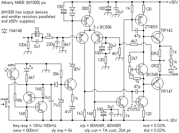

as bad as it looks?
In reality they're even worse than on a picture, imo.
Albarry went bust in the '90s, but relaunched half a decade ago, still the same cheap plastic styling for rather absurd price levels.
The stero power amp is pretty much the integrated (PP1) model of that era, in the same case, minus the preamp hardware (Britannia all the way).
The M408 is half an S508, in a different case.
Folks who love strapped-down electrolytics could have done a whole lot better with an Audiolab 8000 series, imo.
(for cans in bondage plus darlington output stages, Nytech springs to mind)

Looking at the schematic (many thanks), it's like there was an standard design that had changes strapped onto it to make it better. This is an odd amplifier for sure. The Audiolab 8000 is a much better product! I have seen those come across my bench before. Those amps I don't mind at all.
Do you not wonder where the reset button for the muted input stage is ?
