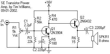

Unless you build something like this... 😉 😎
Tim
Yes, an amp can be made with two transistors. But the one you show will not have sufficient current for normal listening levels nor will it have adequate linearity. These two factors will cause a multiplication in the number of devices.

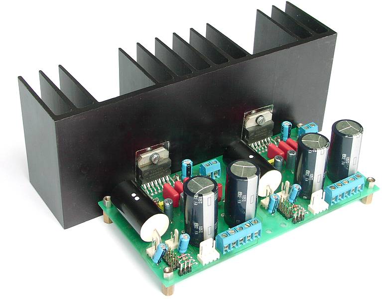

Picture shows an amplifier.

Halo, which amp is that?
It's a lovely looking amplifier, and with the right specs, looks like something I would like to try.
Can you let me know more about it please?
Thanks!
Thanks!
Re: Halo, which amp is that?
Have a look here :
http://www.schuro.de/preisl-hiamp100.htm
The schematic and datasheet is here :
http://www.ub-elektronik.de/download/a100-daten-301.pdf
Jens
It´s an amplifier kit from a germany company called Schuro.lawriebuck said:It's a lovely looking amplifier, and with the right specs, looks like something I would like to try.
Thanks!
Have a look here :
Jens
I just took a random picture. Now I had to serch to find out what it was for amp. I found it in my audio-links favourites.
Endstufe 100
Datenblatt für Rev. 1.10 (789KB) Platine wird nicht mehr ausgeliefert!
Datenblatt für Rev. 1.11 (1,5MB) neueste Auflage
DMOS-Endstufe 100 W (bis 300 W durch Brücke/Parallelschaltung) mit TDA 7293. Gute Meßwerte und Super-Klang. Sehr kompakter Aufbau für vielseitige Anwendung, insbesondere BiAmping und Aktivlautsprecher.
"Endstufe 100" or "end100" is a 100w amp using TDA7293. (Bridged 300w)
Good specs and "Super-sound".
The picture shows a module with 2 amps 100w
good for bi-amping and Active loudspeakers.
Datenblatt= PDF, Rev. 1.11 (1.5MB)
😎 UB Elektronik, Ulrich Böhmke
http://www.ub-elektronik.de/baugr-texte/amp.htm
This is good, because UB Elektronik uses both TDA7293 and TDA7294.
Elkaid has just started a thread about building TDA7294S amplifier.
TDA7294 "Gainclone" 😎
Those TDA7293/7294 are powerful and high performance IC:s.
/halo - just the messenger
Picture shows a 50W module from UB Elektronik, using TDA7294
