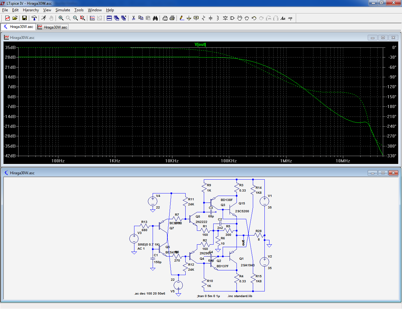

It's a very practical thing to limit bandwith of consumer audio amplifiers. 160 kHz is considered adequate bandwith for "mid fi" gear and in fact there is very little to be gained by extending it. As an audio tweaker, feel free to build a faster circuit and it's OK as long as it's stable in your application.
There's more than one way to address stability in high speed global feedback circuits. Read up on Walt Jung's feedforward compensation. It effectively decreases loop gain at higher frequencies by opening up the feedback loop at higher frequencies while simultaneously reducing loop gain with a zobel snubber on the output. It's tricky (and doesn't always work the way you'd like) but modest increases in speed and reductions in distortion (by virtue of more global feedback /higher loop gain) can sometimes be realized without the usual instability issues of high speed, high loop gain amplifiers.

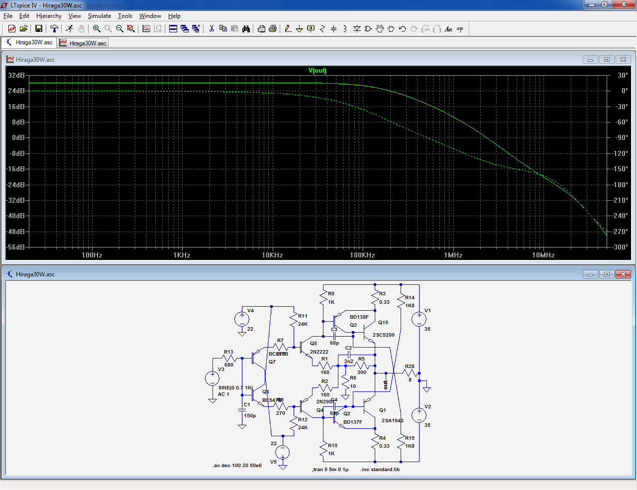

First, a sim without any explicit compensation: nice and regular amplitude & phase response, roll-off begins at ~250KHz.
Second, the 2n2 is added: this predictably creates ugly quirks
Third, all the capacitors in place: the nasty quirk is swept under the carpet, and the roll-off starts at 35KHz.
Demolition job is completed.
If one wishes more roll-off, the good solution is to increase the time constant of the passive input filter, not to mess-up with the loop parameters

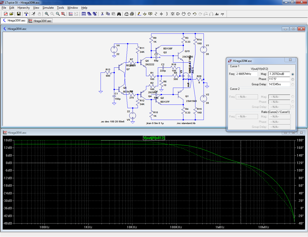

Here is what I mean:
Good work in first round. The ugly quirks will be create through the unity gain character in the upper frequency range (2n2 means a short wire between output and inverted input from a certain frequency).
Second round must be the investigation of this in real live under real conditions.
I guess, no compensation capacitor is necessary (independend of the transistor Ft's), if one replace the Sziklai darlington in the output through a normal darlington, because then only one voltage gain stage is in the global NFB loop (currently there are two voltage gain stages).

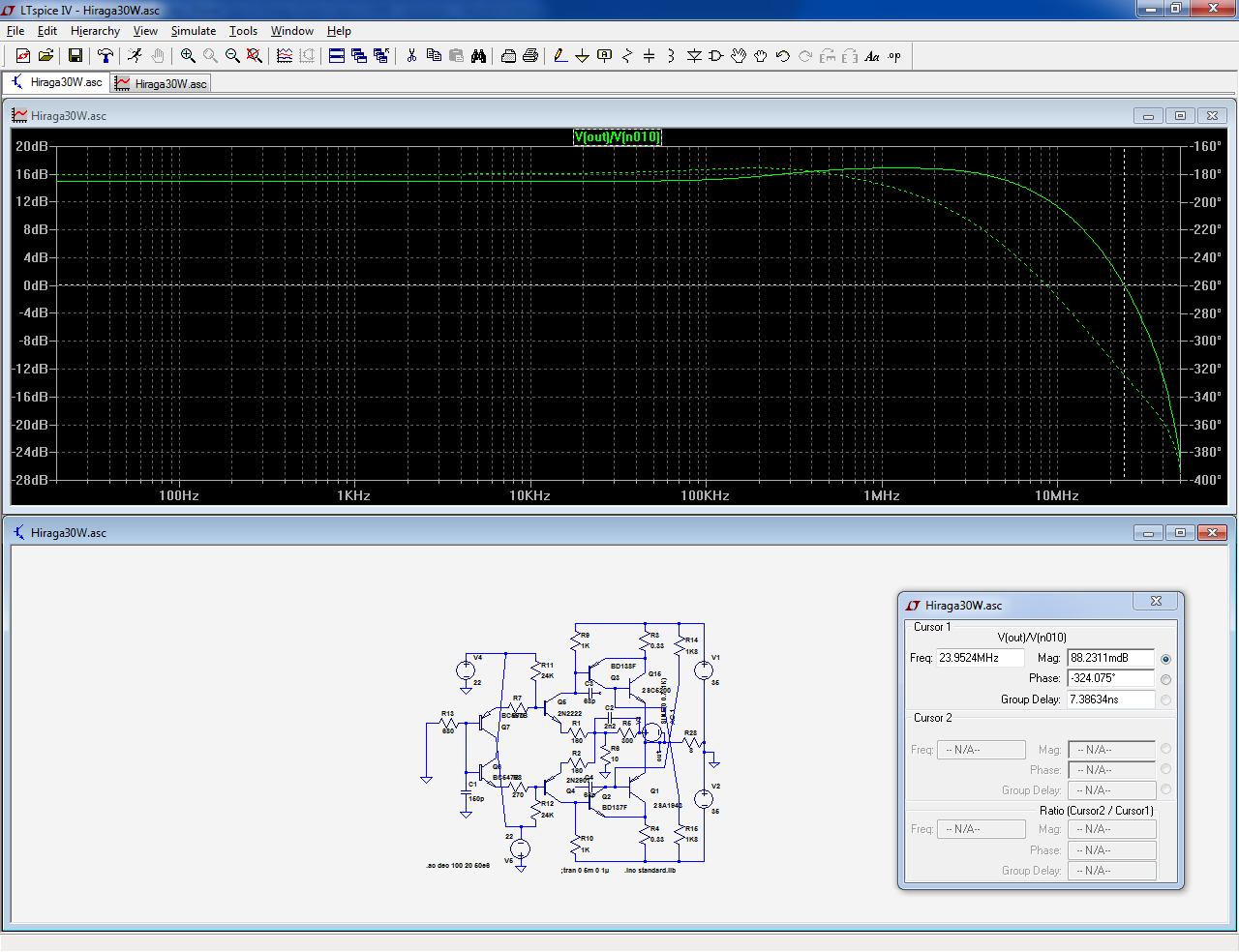

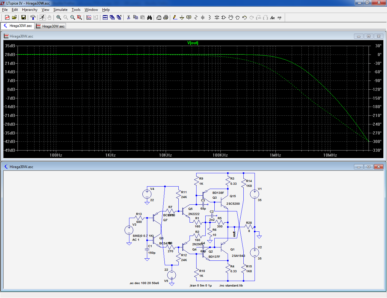

What happened to basic stability issues? First sim show 220 degrees of phase shift at unity (0db) gain frequency. (around 12 mhz) Second is 135 degrees at around 3 mhz. third is 150 degrees around 7 mhz. 2n2 cap is lead compensation, and if done right does work. If sims are right, first amp is an oscillator, I would think.... Also why the big deal about ugly quirks below unity gain frequency and way outside the audio band....My 2 cents.
You cannot draw useful information about loop phase issues from the In-Out phaseshift.What happened to basic stability issues? First sim show 220 degrees of phase shift at unity (0db) gain frequency. (around 12 mhz) Second is 135 degrees at around 3 mhz. third is 150 degrees around 7 mhz. 2n2 cap is lead compensation, and if done right does work. If sims are right, first amp is an oscillator, I would think.... Also why the big deal about ugly quirks below unity gain frequency and way outside the audio band....My 2 cents.

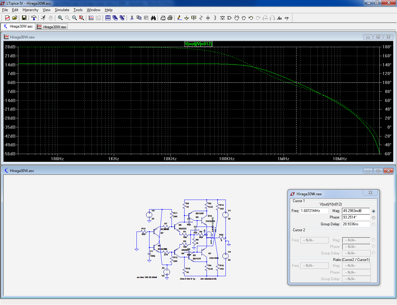

The loop gain has to be measured properly.
With no capacitors at all, the phase margin is 93°, which is excellent.

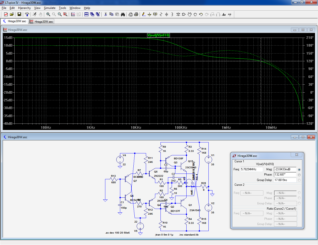

With the 2n2, this is reduced to less than 36°; this is becoming marginal.
With all the caps in place, the margin rises to 133°, which is very good but not particularly useful, and this comes at a cost: the loop gain begins to roll off as early as 15KHz, the phase is not linear, and the slew rate is most probably damaged too.
Thank you for your explanations. My circuit theory stuff is 30 years old and mostly unused (and pre spice) so be patient with me. My only other quibble is that lead compensation is normally added in after miller and other compensations (tweak after feedback has been put in), so (to me) it is somewhat misleading to analyze the circuit with just the 2n2 cap, but would be more correct to have just the 68 pf caps, and then see what corrections the 2n2 cap. (i.e. the 2n2 cap is useless until the other caps are in place).

That's right, but here with such a small loop gain the first thing to do is to check if and how much Miller compensation has to be added, and then add some lead as a finishing.Thank you for your explanations. My circuit theory stuff is 30 years old and mostly unused (and pre spice) so be patient with me. My only other quibble is that lead compensation is normally added in after miller and other compensations (tweak after feedback has been put in), so (to me) it is somewhat misleading to analyze the circuit with just the 2n2 cap, but would be more correct to have just the 68 pf caps, and then see what corrections the 2n2 cap. (i.e. the 2n2 cap is useless until the other caps are in place).
But here, that lead comp is so oversized that it looks like a statement: the expression of an article of faith, an extremism of some kind: there is no way one could arrive at such a value in a normal design process: it has been decided upfront, and then the rest has been made to fit (more or less).
This results in something seriously suboptimal, but the small loop gain is forgiving enough to allow for such oddities.

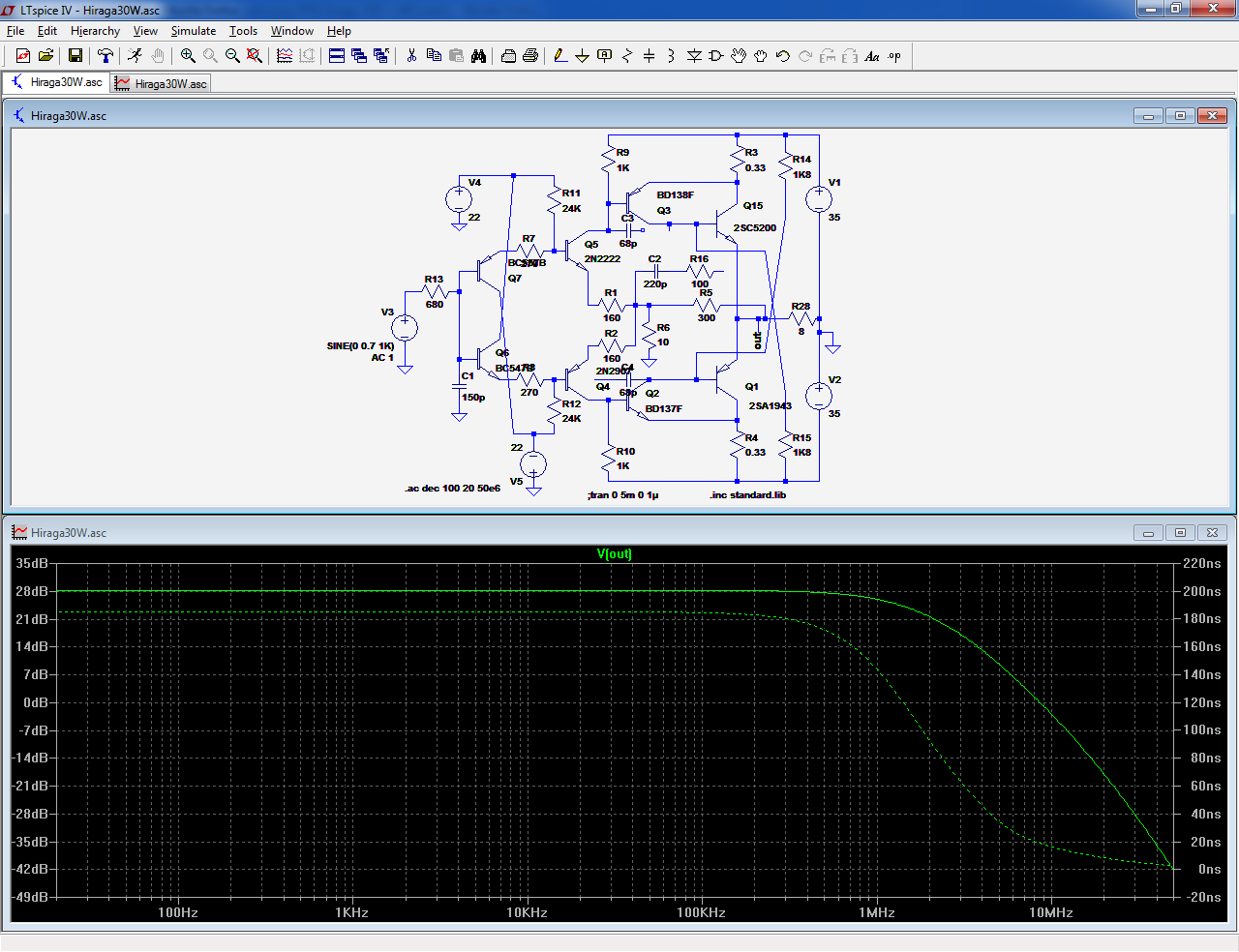

With a lead cap one tenth of the original value and a 100R series resistor, the margin is practically unchanged, but the overall perfs are much improved with the transistors used for the sim.
Here, we begin to be very device specific, and in reality there could be serious variations depending on the actual transistors used, unlike the complete removal of the caps which should be rather device tolerant.
However, if we look at the group delay flatness, the absence of caps remains the best option: up to 200KHz it remains totally flat.

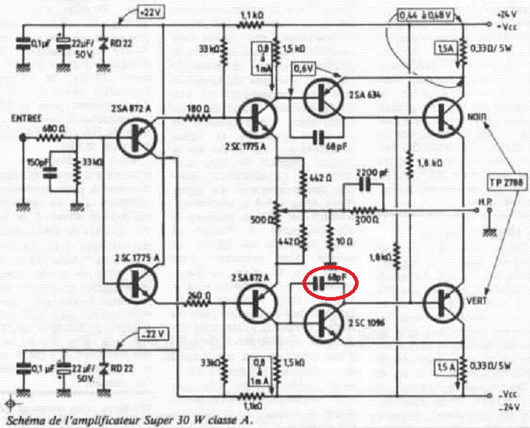

Gave it in #10what about the stability point? when the caps are removed...
I have build this version, And when I plug in the power supply, there's no current flowing through the power transistor. ( Voltage on 0.33R nearly 0V) I thought this layout was running in Class B. But when I remove the 68pf cap at below of schematic, the circuit is working normal in Class A (voltage at 0.33R is ~0.45V)
Is every one tell me why? Was 2SC1096 died?
Thanks.
Thanks.
