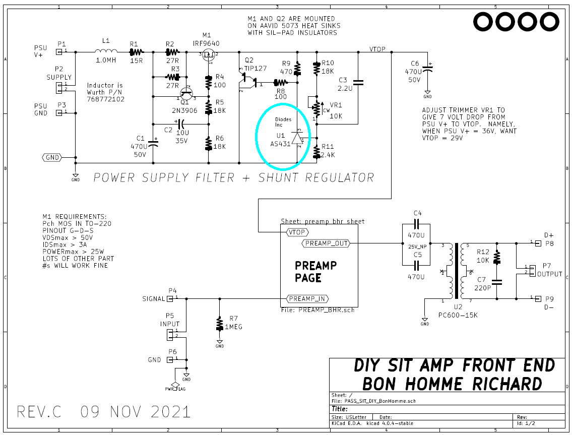

Is that resistor necessary in the Precision Constant-Current Sink example of the TI datasheet of TL431? See p.29, Fig. 10-15 here:
https://www.ti.com/lit/ds/symlink/tl431.pdf
Check out the pin compatible, vastly more stable, version made by Diodes Inc: the AS-431 . I used it in the Bon Homme Richard front end card for VFET/Theseus and had no problems at all. I like to believe the AS in the part number means Augmented Stability.
