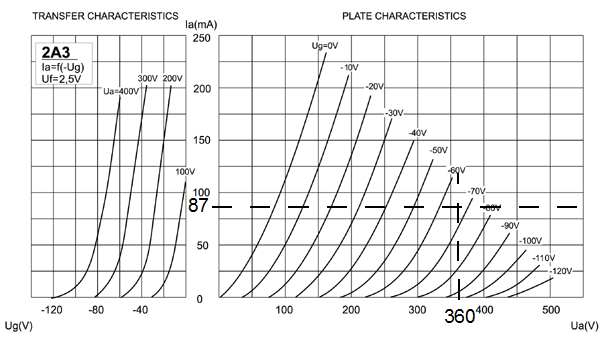

What is the RIGHT way to calculate the Value of the cathode resistor?
Let’s say I want to run my triode (2A3-40) at 360V, -65V, and 87mA.
65V/.087= 747R…. so 750R on the cathode and where good.
BUT this never lines up on the plot sheet.
Given:
Vb=360V
Iq=87mA
U=4.2
Rp=800
Using this formula: Rk = ((Vb/Iq)-Rp) / (u+1)
Rk=641R…. so we use 650R and the plate and grid voltages all line up with the plot sheet, but now there is 100ma flowing through cathode.
So for this example, do we use 750R knowing that where running the valve at 87mA, or 650R to run the valve at the exact plate and grid voltages?

I took your first set of numbers; 360V anode-cathode, -65V and 87mA
and they do look close on the JJ 2A3-40 plate characteristics curve.
That is a valid operating point for the tube, regardless of how it was
chosen. I'd read it as -67V for 87mA and 360V.
Your first method of deriving the 65 volts across a 750R at 87mA is
correct. I don't understand why you say it doesn't line up on the plot
sheet. Did you try it like the attached example?
The other formula is incorrect for deriving the static operating point.
Mu is not a DC parameter, but dynamically derived depending on the
operating point and only assumed constant over a small delta. Same
with Rp, so can not be used to derive the DC conditions relative to zero.
Michael
PS as others have implied, the 360V is cathode-anode. With cathode
bias if 65V the B+ will be 425V

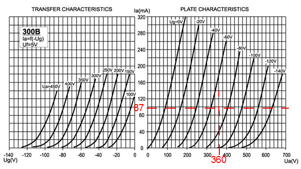

Is a JJ 300b more linear than a JJ 2a3?
Here's the same OP plotted on the JJ 300b curves.
Looks a lot more linear, right?
The JJ 300b and 2a3 do in practice have identical plate characteristics,
just plotted a little differently apparently.
I guess linearity is a function of the load impedance also, but I'm
assuming some load line in the 3K5-5K range.
I guess choice of OP is also determined by the desired power output,
and the higher Va offers more Po, all other factors being equal.
With this OP you could get about 8 watts into 3K5, 6 or 7 watts into 5K.
At 250-300V you would be looking at 4-6 watts and could get nice
low distortion also.
I think another valid direction to go is treat it like a 300b and go
400V/75mA which would enable 10W Po into 3K5 and 8 watts into 5K.
The 5K loads have lower distortion at the higher operating voltages
vs 3K5 or 4K. Some folks go down to 2K5 or 3K which can work well
with some speaker types.
I also use the WE 300a/b chart to evaluate OPs for the JJ tubes.
Michael

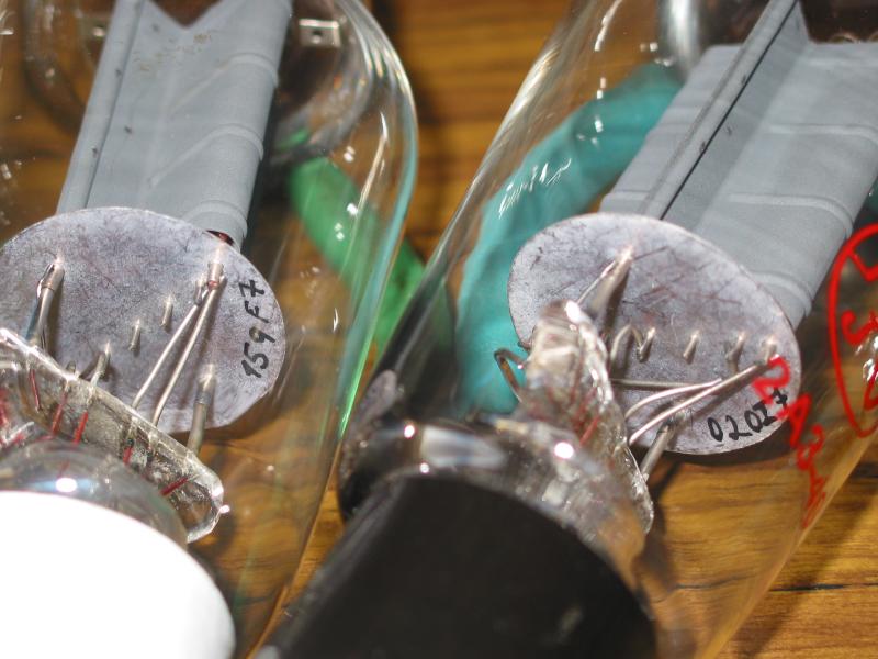

Hi Michael,
Where do you get the figures from😉 ? The 2A3 curves are incomplete at higher voltages so you can not get all answers from them!
Even though, you can definiately see that the 2A3s are worse at higher voltages, check -100/450V and -120V/500V as examples.
300B and 2A3 does not have identical plate characteristics, as I see it. It would have been nice to have one of each and check them in my AVO.
If wanting to go for higher voltages, 300B must be the way to go.
About JJ I would suggest measuring them before adopting them. I can not speak for 300B or their 2A3 but I started out using JJ-tetrodes when building my first series of guitar amps. Had to leave them due to inconsistency! I even ordered matched pairs from the factory but it didn´t help. A total fiasco were 3 out of 5 7591s pairs of where defective.
I get my figures on this from running both "types" in amps. I have
used them interchangeably except for the filament transformer.
I have run both JJ 2a3 and JJ 300b in the same amp at the same OP
(400V, 45-60mA range) and identical results. The samples I have
are identical except for filament voltage. The curves they publish are
different but the tubes are the same. There is a different strapping
of the filament, series in the 300b and parallel in the 2a3. That and
the color of the base...
The consistency of the samples I have (6 300bs and 2 2a3s) is
surprising to me, but then there is one bad 300b with an intermittent
anode connection. I would not hesitate to run push-pull with a 300b
on one side and a 2a3 on the other, they are even consistent across
tube number ;-)

I use the JJ300B (8yrs so far) and have encountered the JJ 2A3 which JJ bills as a 2A3 but clearly states has higher voltage and dissipation ratings than a standard 2A3 - and here is the clincher IMO it works as well or better than most 2A3 in circuits designed for the 2A3.
One thing to be aware of is that the JJ300B has a filament current requirement of 1.5A which is significantly more than the standard 300B 1.2A requirement, this would I suspect also be true of the JJ2A3 which probably requires 3A versus a usual 2A3 which requires about 2.5A. (I have not measured the JJ 2A3 filament current, but if as Michael says the difference is in filament configuration that would be the case.)
FWIW I suspect the original mono-plate 2A3 probably had plate curves that were very similar to the 300A/B. (I haven't checked)
Kevin,
I haven't measured them but the JJ spec sheets say 1.2A for the
300B and 2.5A for the 2a3. I have been running he 2a3 filaments
from 2.5V/3A hammond transformers with no heat, no buzz.
I think the actual devices are closer to the 300B, but there isn't
a lot of difference between the 300B and 2A3 characteristics in the
first place. Some time ago I went over the STC 300b curves and the
old Radiotron 2a3 curves and found only small differences. Was the
300B built to be an industrial strength 2a3 work-alike for telephony?
