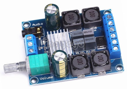

You see it in most amplifier boards - 2 big capacitors:
I am curious to understand: what do they do?

They act like filters for the supply rails (positive and negative) and as energy storage. So if the amplifier needs energy immediately (such as in transients), it does not have to get it from the power supply, which can be further away.

They store charge to produce the power supply voltages, which the amp needs
to function. All amplifiers need some kind of power supply such as this.
As the capacitors are drained by the amplifier, they are recharged by the
transformer and rectifier, which source power from the AC line.
Two batteries of suitable voltage and capacity could be substituted for them,
but this is usually impractical.

the amplifier in the image above, is TPA3116-D2.
The amplifier here, is TDA7297:
And for some reason, it has 1 big capacitor..
Why 1 and not 2 like in most amplifier boards?

That chip uses a single rail supply. It's a good idea to look up the data sheets when you know the chips
Because it is a bridged amplifier. Esentially two amplifiers that tackle each half of the audio signal (the positive and negative) and the speaker is connected between them, so it only needs one supply rail, hence one decoupling capacitor.
