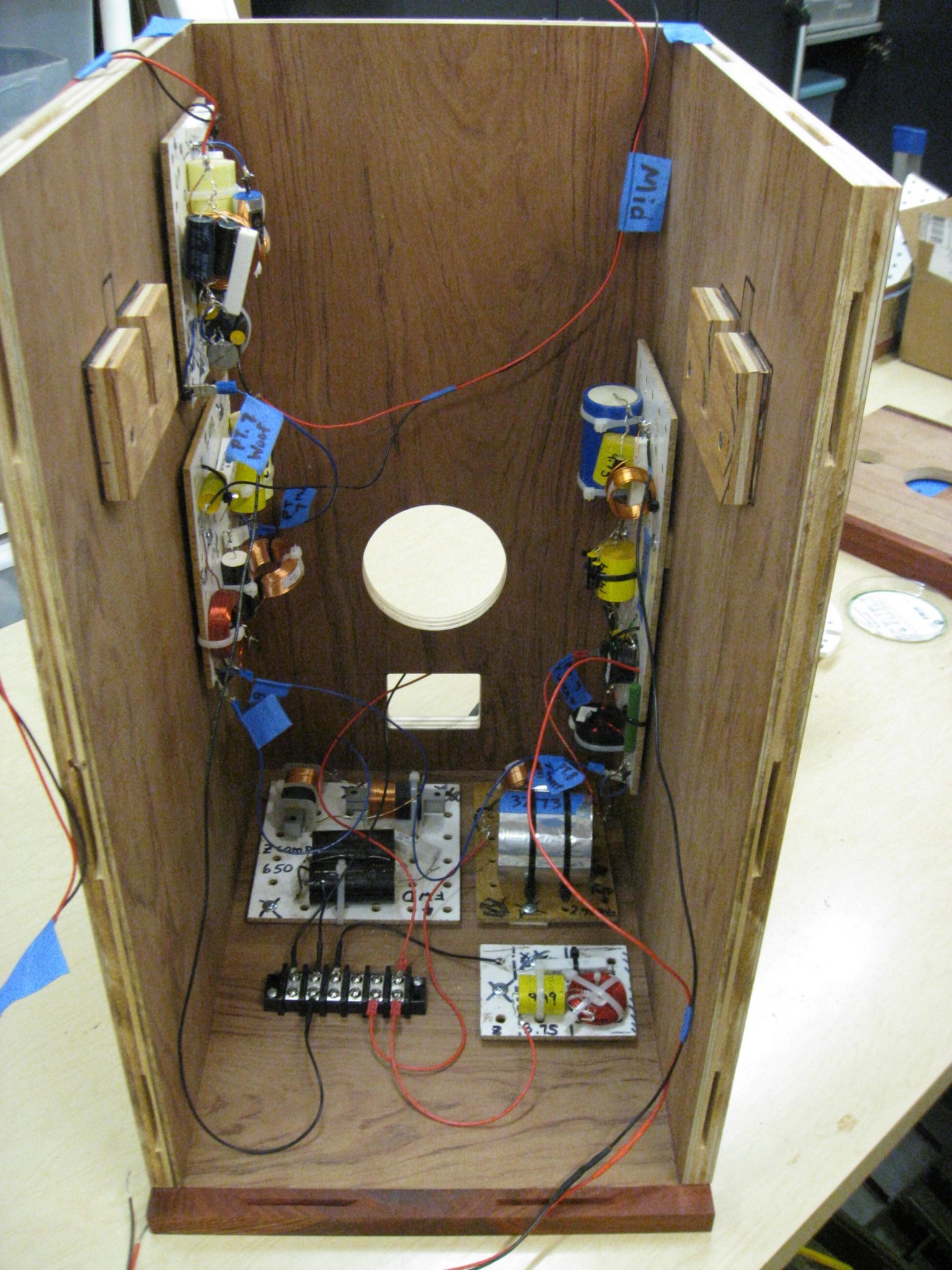

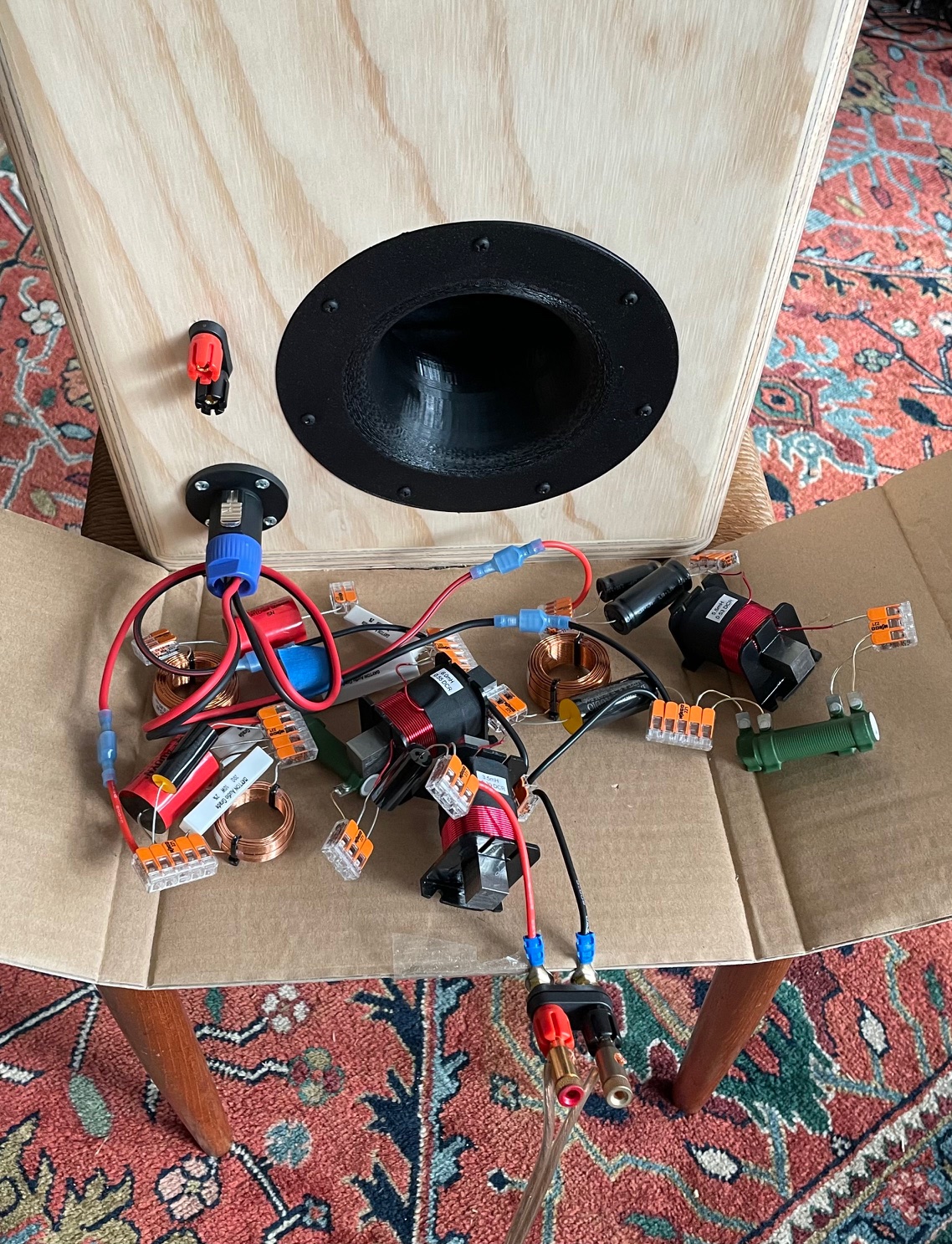

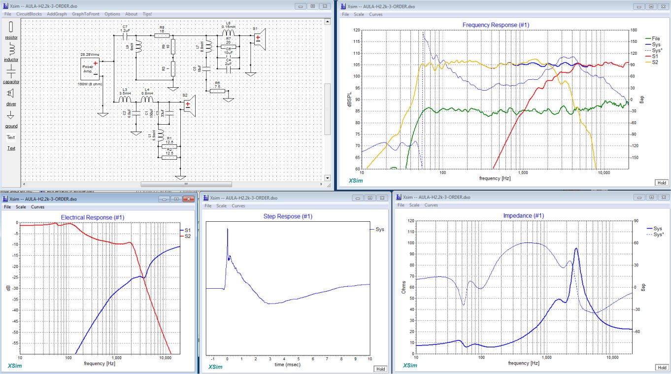

So I'm making these speakers. And I'm going for this Harsch XO style. And by the time I get it set up it's gotten a little crazy. And it makes me think let's talk about complex crossover designs.
Thank goodness for wagos!
But then I think - ya know? I bet someone on DIYAudio has something way crazier than this. I mean, you could make a passive 4-way, do it 4th order, that'll be like 10,000 components NP. But a complicated 2 way gets respect also, I think. Total complexity, or complexity per band. You know what I mean. But implemented designs only! "I designed something but then didn't build it b/c it was insane" doesn't count. And also, passive - anyone can put 45 biquads in DSP if they wanna. If you actually built something crazy, why did you feel like it was worth it to go the extra mile?
Also, I was thinking about the possibility to build something like this before electrical simulation and measurement software were as good as they are today. So I welcome discussion of crossover complexity today vs. back in history. And, hobbyists may choose to pursue designs that wouldn't make sense commercially, so discussion about commercial XO's vs hobbyist decisions WRT complexity and motivation are also on-topic.
Who has some interesting stories?

I had a 2-way with very smooth drivers that I still ended up with probably 16 parts in the x-over. That was 24 years ago, and I was using filtered pink noise and measuring. Several experts of that time were telling me I was doing it wrong, however, it was well received at a speaker get together with about 40 attendees in a large room..The mentioned expert liked it.
I later removed the x-over, and looking at it, I couldn't even follow it. I could probably do that same x-over now with half that many parts.
I use only gated measurements these days. It looks like you are not.
Reactions: AdamThorne
I've assembled, and measured a 3-way with probably over 30 components using jumpers. I bailed on it after considering the work that would be involved assembling it. So as you say, it doesn't count.
Oh, by the way, both x-overs were done by trial and error without any sims. The 3-way using HOLM to measure. Now I use REW. Same results I think, but less mouse clicks are needed.
If you want to post nice clean gated files, I like to play.
Can you give a quick explanation of the Harsch xo? You combine a steep filters on the woofer, and a shallow on the tweeter. Is there a specific slope, and offset involved? Is it 18dB, and 30dB slopes? I may have done something remotely similar by accident, but likely thought matching slopes were better, and I was compromising doing it otherwise. I have seen a pretty flat phase response a couple of times on my speakers. I just recently discovered how to look at the impulse in REW.

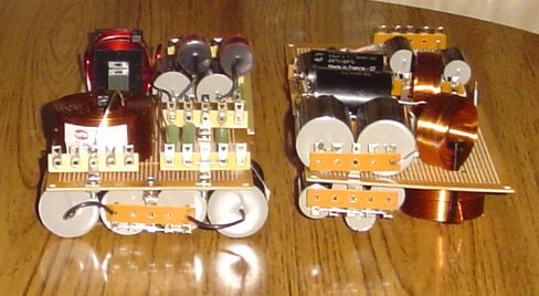

I have 25 parts in my Attitudes 3ways.
IIRC, I have 21 in the Cecropia Supreme 2 ways.
Of both above, it does not count the many superfluous parts I've been able to switch out within the circuits. I was testing audibility of the caps in the Attitudes and coils in the Cecropia Supreme via heavy duty toggle switches. They both were experiments that were well worth it.
14 in Monoculus 3ways.
20 on my Missing Links project 2way.
15 in my Pangolins 10" DVC 2way wired as 2.5way.
16 parts in my Bottleships micro 3way.
15 parts in my Purveyor small 3ways.
22 in my MAX 2ways.
Yeah, heavy parts count does happen!

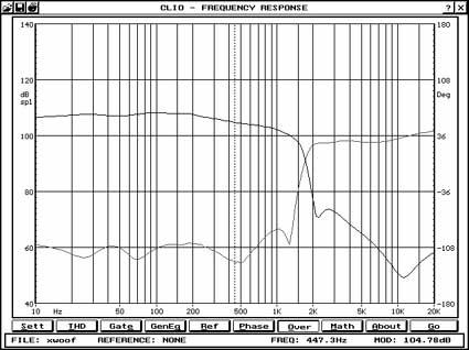

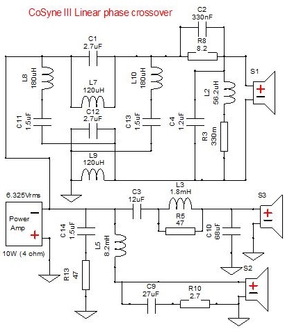

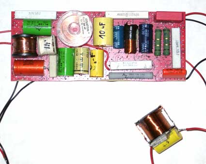

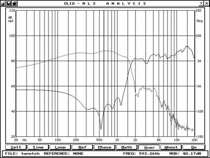

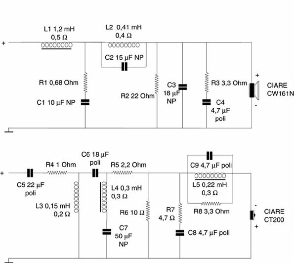

Once upon a time I build this (pictures)
I was reading the Jason Cuadra paper about the extreme slope xover, and wanted to give it a try.
It worked as intended.

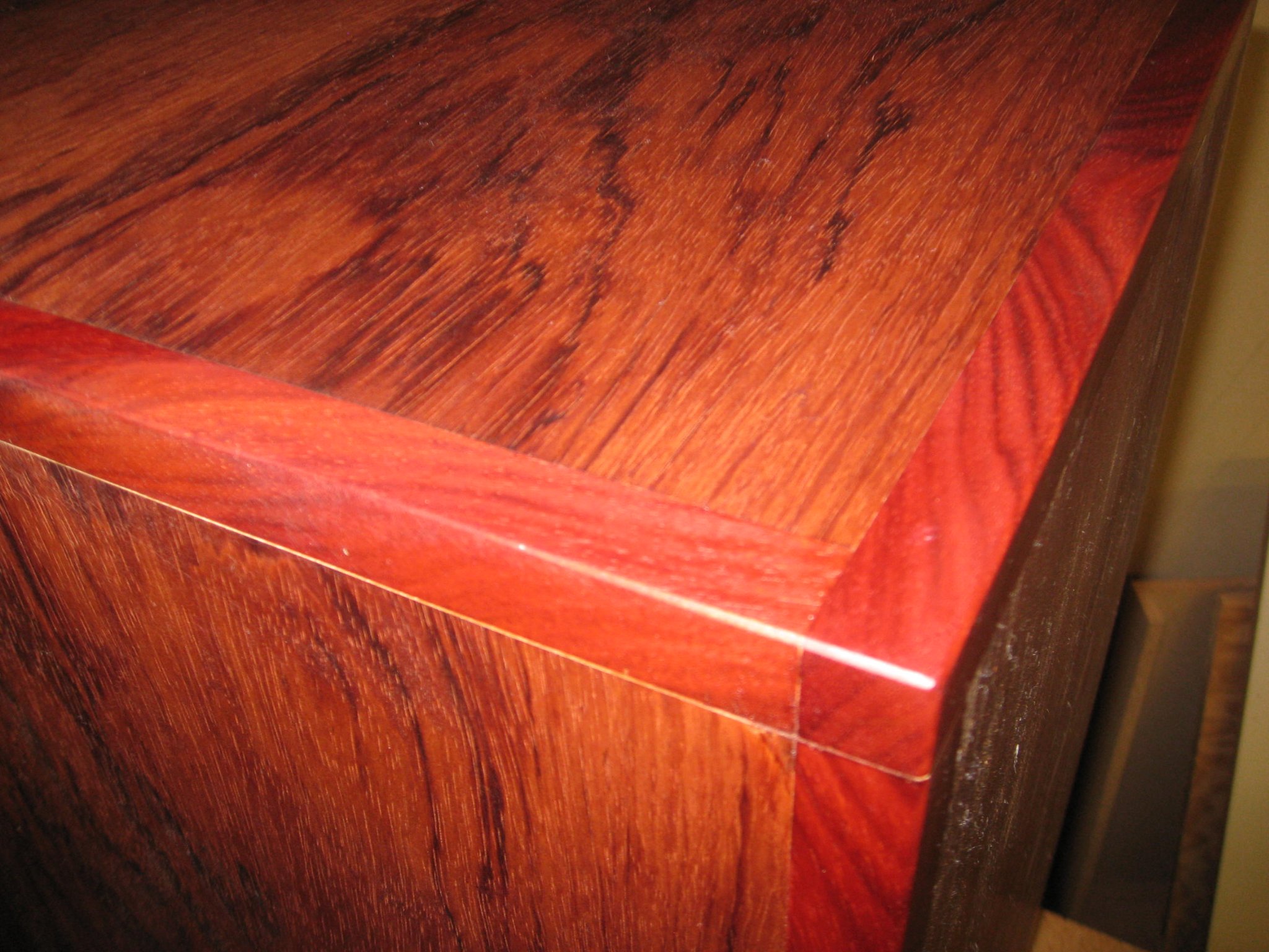

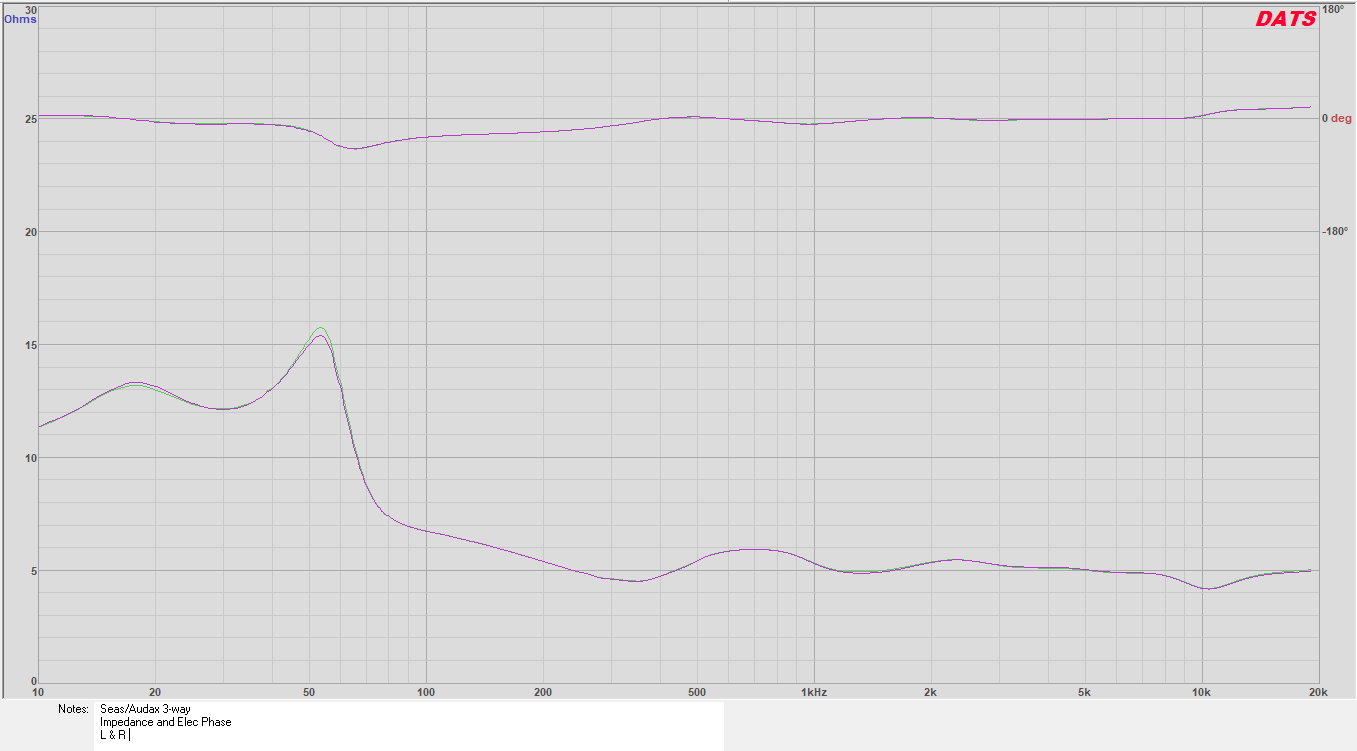

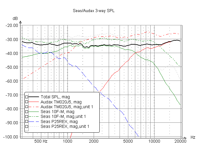

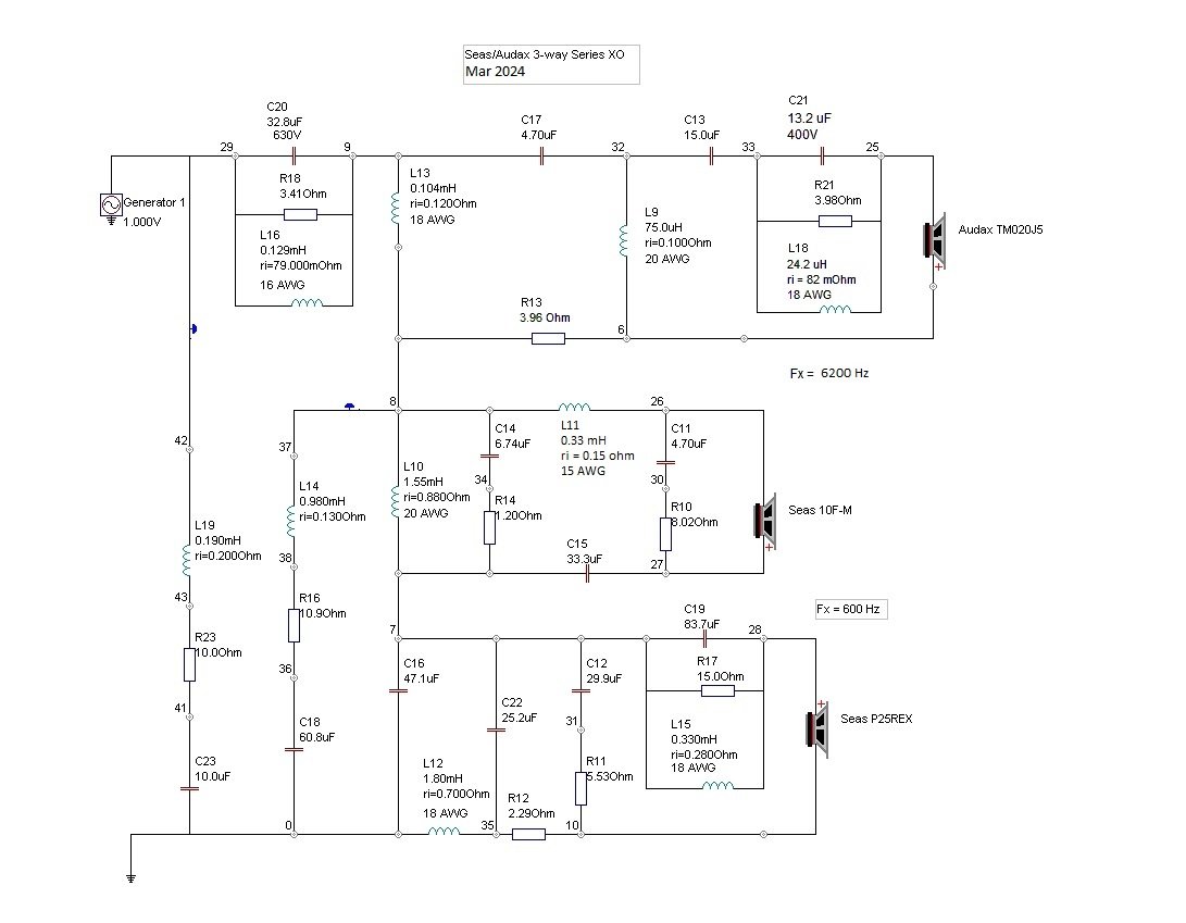

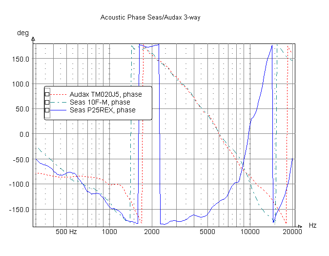

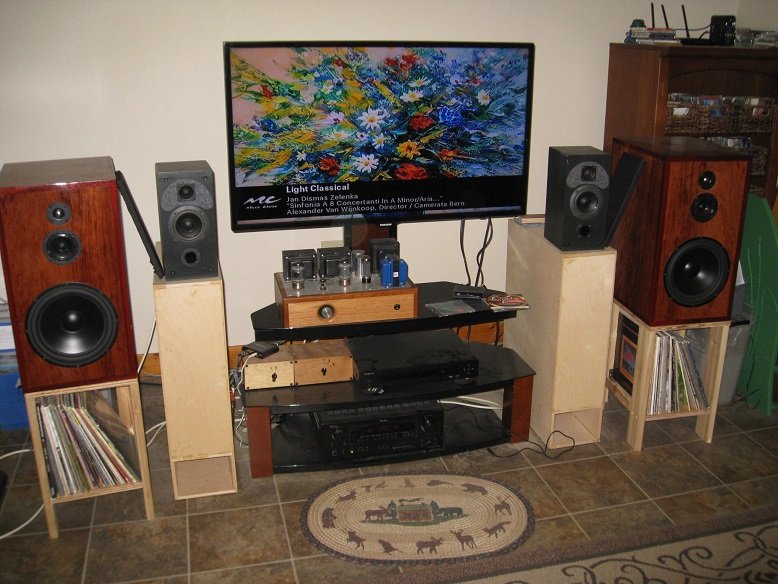

I finished a 3-way series last year with 28 components.
It was an exercise in using up some old stock in my stash. A few resonances needed taming.
Rear port was stuffed to alleviate the woofer's boominess.
With some impedance compensation, the load above 100 Hz is nearly resistive. Acoustic phase is excellent.
Bubinga ply with cocobolo edges. Pleasing to the ears and eyes.
ooo, also a link? I found reference to his name, but not the paper.

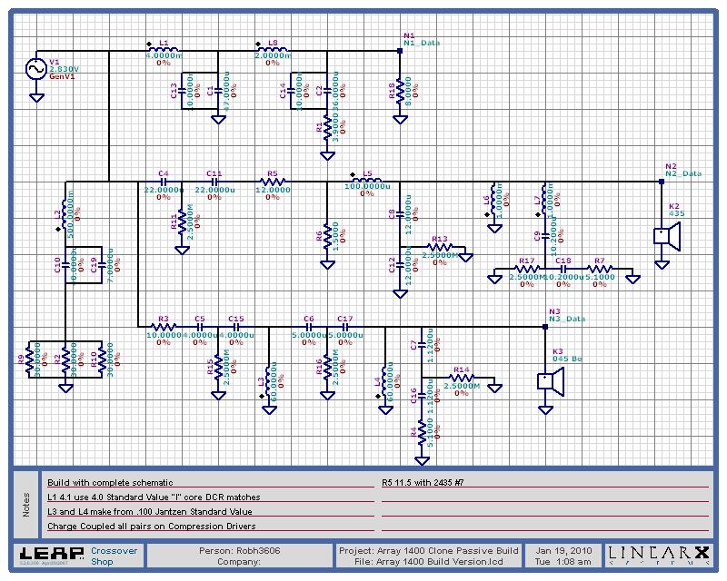

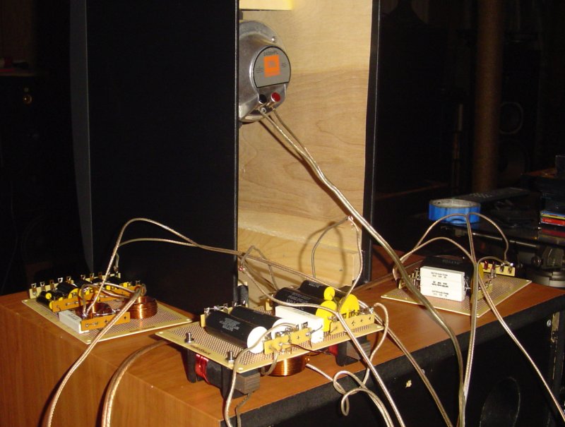

the horn itself was decently linear phase except the tweeter, had to hold it back somehow
Seeing a big part count / schematic is impressive, but a bit of understanding about why it got so complicated is the interesting part! Thx for the additional comment.

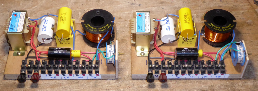

Series! Bravo, sir. I will have to play with a series XO at some point. That plywood sure looks the biz also.

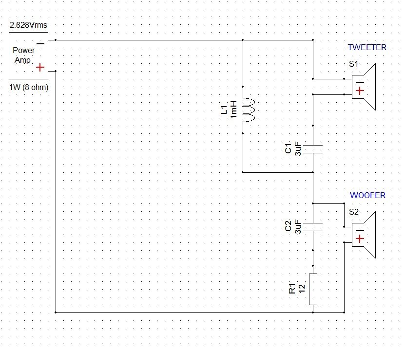

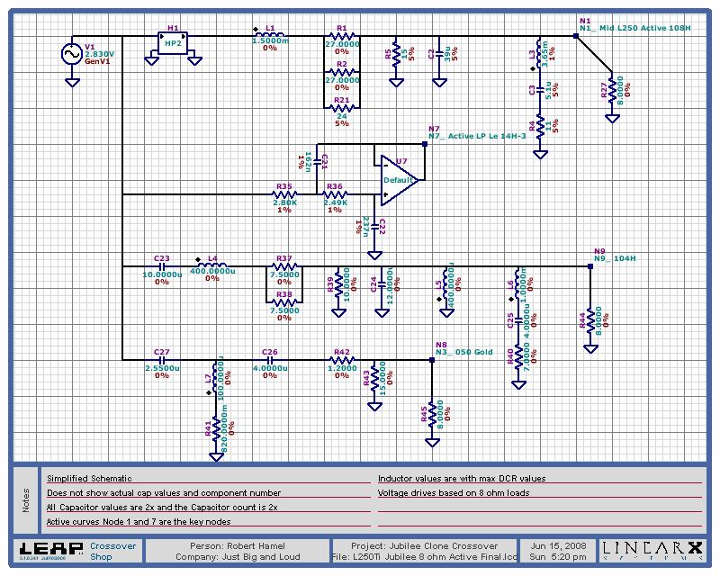

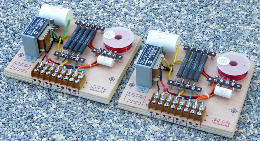

Aw, sorry - I thought it was the most simplistic you implemented... 🙄😉

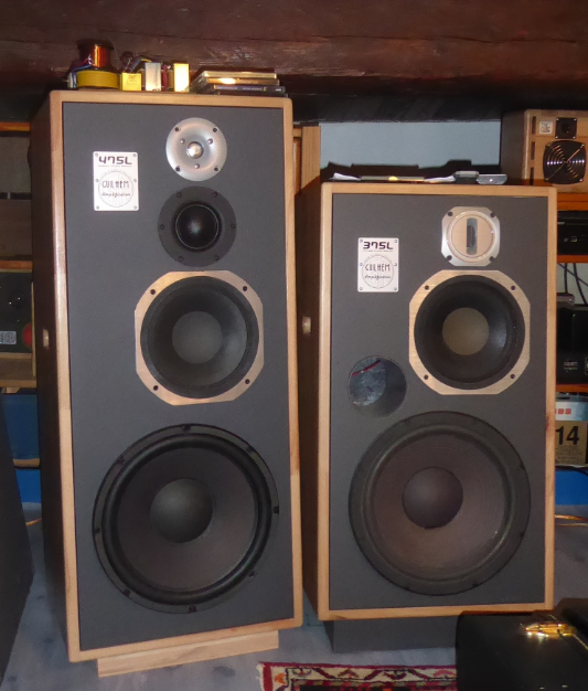

I always admired the complexity of this one...
Is that FOUR ways crossover with so little components????!!!!
Oi! You minimalists get your own thread! 🤣😆🤣😆
