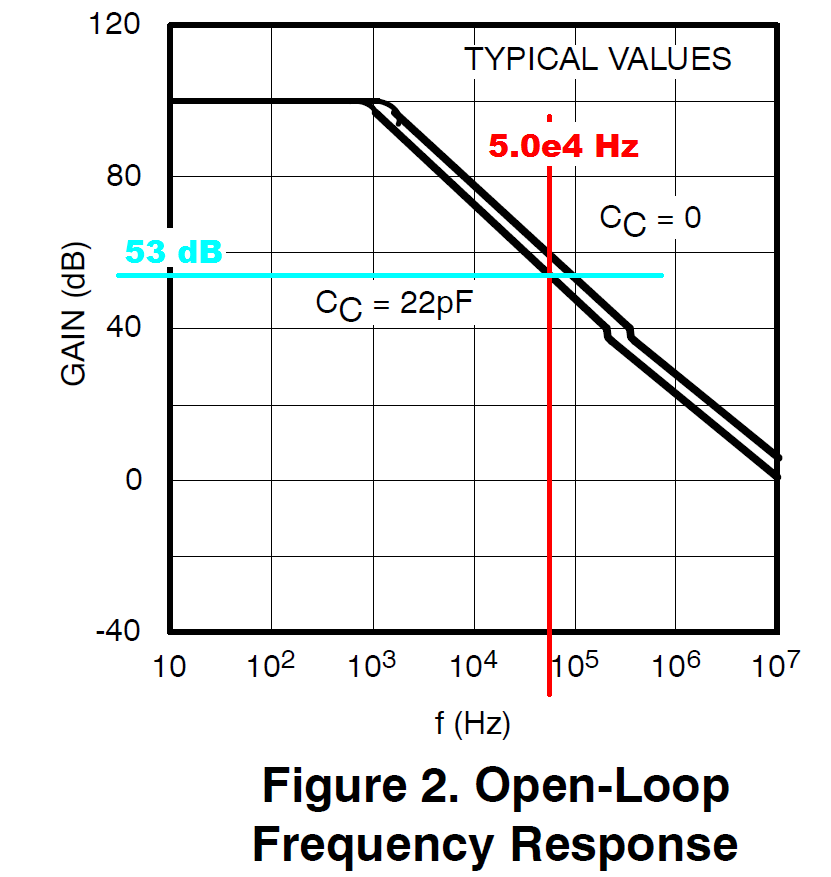

What should I look at to determine the maximum gain without losing anything in the audio bandwidth for1 stage of gain?
Would there be lower noise or less THD if instead of pushing 1 gain stage close to it's max, you used 2 stages of half of the gain to sum to the same level?

Unfortunately that Texas Instruments datasheet does not contain a plot of open loop gain versus frequency.
However, the NE5534A datasheet from On Semiconductor, does contain this plot. I copied it below.
In my opinion, one way to estimate the maximum gain is to take out the plot of open loop gain vs frequency, and draw a vertical red line at 50,000 Hertz (5.0e4 Hz). Wherever the red line intersects the open loop gain curve, that gain is the maximum you can possibly expect to get.
In the case of the NE5534, that's 53dB (blue line). Which is a voltage gain of 446x.
you really need geometric mean gain in 2 series amps to get the same final gain
noise doesn't change enough to worry about if the total closed loop gain is >10 but is in principle a little worse in the series lower gain amps scenario
audio THD, closed loop bandwidth improve with the series lower individual gain feedback amps
you can do even better by using as much of both amp's gain as possible inside a common global feedback loop
but stability concerns with the 2 op amps inside a common global feedback loop make more complicated multiloop feedback necessary
While it is theoretically to have all the gain in one OP-amp I never go over 100x with a single device and usually try to keep it 10x to 30x.
