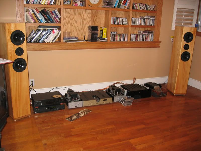

Thanks for the reply. The current volume is about 45 liters.
I am using MTM configuration with two Vifa PL18 6.5in. drivers. I guess what I want is a slightly warmer sound.
Here a pic 🙂

pjpoes said:They are sealed or ported?
They are ported. The port length is around 4in.
Warmth is a subjective term, and its often hard to know for sure what it is people want. Now the way its used in speaker design with regard to total Q is a raise in Q and thus the steeper roll off.
Please excuse the quality of the image, my normal computer is in the shop, so to speak.
Anyway, the yellow line represents your box. Its basically a critical Q box, with roughly a .5 Q. On the positive side it has a nice group delay, smooth transfer function phase, and the most extended usable response. On the negative it offers the least driver control, and so with no eq, and fed a pink noise signal, it could only handle roughly 20 watts before reaching xmax. Of course real world music doesn't contain that much even low frequency energy, but basically beyond that, say with 50 watts, then you are well beyond the speakers xmax from 50hz on down. On the other hand, from 50hz on up you are at 103 db's or so with 20 watts, which is very loud.
The Red line is with a Q of .581 and is for a 25 liter box filled with polyfill roughly 75% of the way. As you can see, this made a pretty minor change, but required reducing your box volume by over double what you want to do. You do get a little more power handling now when the speaker are fed with this unrealistic signal. It moves to 30 watts before breaking xmax, and with 100 watts, the point of breaching xmax is now more like 45hz or so.
Ok the green line represents an equal ripple alignment of roughly Q=.8 and is achieved in an 11 liter box filled 50% with fill. This is the change I would recomend in order to achieve the warmer sound you want. I think that any other change is going to be trivial at best, and this is just the nature of that vifa driver (lower driver Qts). I know this probably isn't what you wanted to hear, as it means a massive reduction in volume, but I do see it as the only solution best I can tell. Now, to achieve this without a permanent change, I would recomend cutting a solid wood brace, of sorts, that fits inside the box (if possible) and temporarily secure it so as to reduce the volume the desired amount. You could try to find extremely dense foam, such as dense cushion foam, and see if it gives the effect, but since its still a type of open cell, I think it will do the opposite.
I tried modeling the box as if the air basically was the opposite of having polyfill added, and see if that would mimic adding dense foam, but could only raise the Q to .559, which isn't enough to warm up the sound much I don't think.
Basically to reduce the volume you need to fill up the box with solid objects as much as possible, to consume some of that volume. For testing purposes, anything solid will work. Try plastic bags of sand maybe instead of fabric (maybe air won't pass through the grains of sand).

Doh should have waited for your response. Ok hold on, basically what I said was true, but the graphs are wrong and the size change may also change. Ok hold on, I will get you new numbers.
Ok well now the changes are going to be different, as the system Q changes in response to the port and box volume change. Ok now I would say reduce box volume by 17 liters or so, get it down to say 28 liters and retune to 50hz. Then fill with roughly 60-70% polyfill. This will reduce overall bass extension, but bring about roughly 2-3db's more energy in the 100hz range. Warmth is in the 100-400hz area I would argue, and we are having no impact on the response above 100hz, so if doing this doesn't fix it, you need to change crossover values.

That would imply roughly a 45hz tuning, so yeah, to increase the energy in that range that I discussed, you need to reduce volume a lot, say 15-20 liters, and increase the tuning to roughly 50hz. This is my suggestion anyway. Simply reducing the volume reduces extension, but does nothing to increase output in that range about the tuning frequency.
