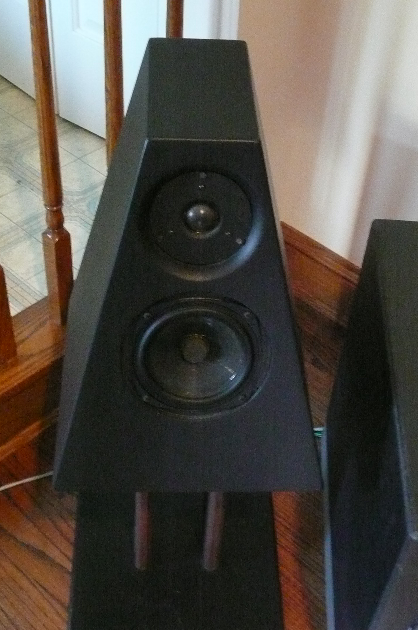

Don't build "monkey coffins". Angle sides, use braces and use multi-layer construction. Try not to create multiple resonances at similar frequencies. I've never heard one, but remember the sand filled walls of some speaker from the 1950s or 60s? Be careful of port sizes so you don't get port noises. Get damping just right!
Angles, yes of course, small front/baffle board also; stands are important.
Pic ~ I made about 20 of these, using Peerless 1591, morel tweeter and a simple 6 db crossover. They sound great, bass is awesome. Not only are the sides angled the walls are lined with lead. If they look a bit old, you’re right, about 20+ years, still sound great!
The 5 ¼” Peerless woofer was ideal, wow what a lot of bass; too bad they discontinued them long time ago.
*Back then, we used to pull the dust covers and insert foam plug(s), “opens” them up quite a bit.
