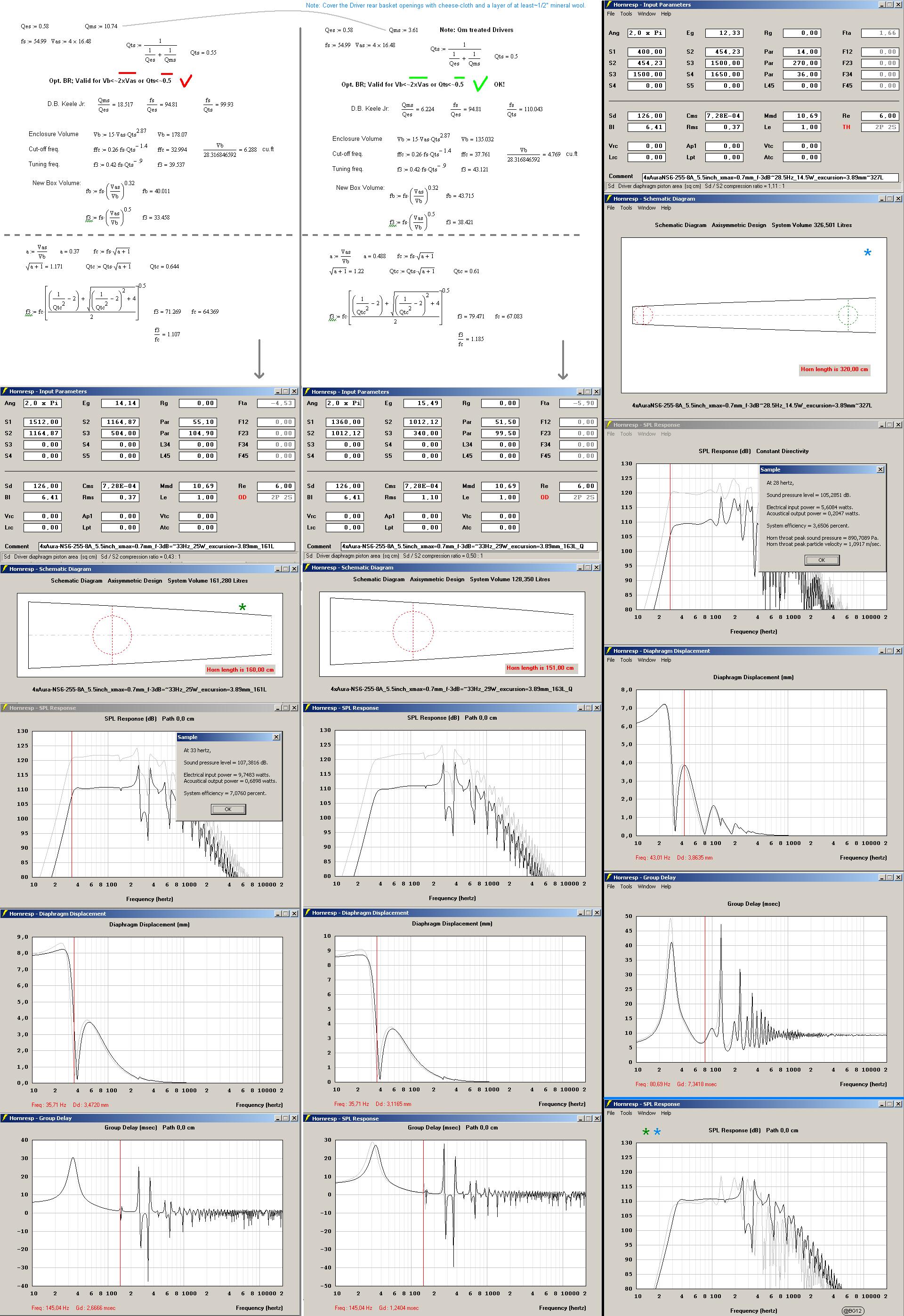

I have four ns6 and four T-amps. This is strictly going to be a two channel stereo low budget project. I will use two ns6 as in OB and two will be used as LF production. The apartment living room measure about 11'x10'. So space wise, it's a small room after the new couch are delivered. I noticed most enclosures currently proposed or suggested for the ns6 including bass reflex cab are tune to about the mid 40 or so. I haven't seen any other cab design that can further lower LF response. Do you by any chance encounter such cab as BHL or similar in design that can produce near the low 30hz range?

I was wondering- will these work in a tapped horn? Just curious.

Hi Deon,
Here are suggestions that can be scaled down(the CSA:s) if using fewer drivers:
b 🙂
Hi Deon
Are you planning on using four ns6, cause I only plan on using one per channel in a slimmest cab possible tuck away in corner of my living. Could you may be kind enough to simplify from the simulation and post the dimensions require for one ns6?
