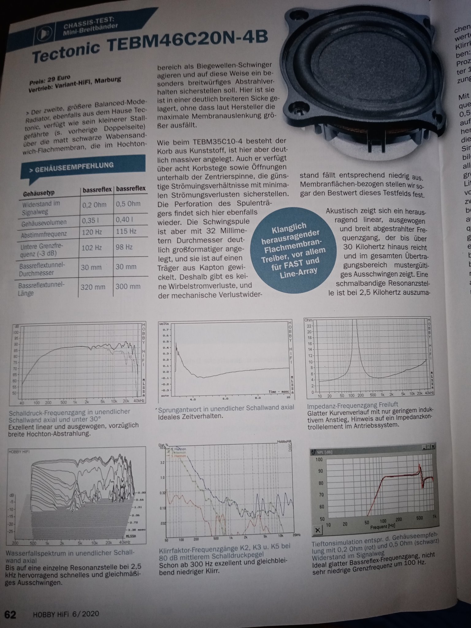

Tectonic tebm 46 c20n 4b
Is one of the best. Perfect measurements
