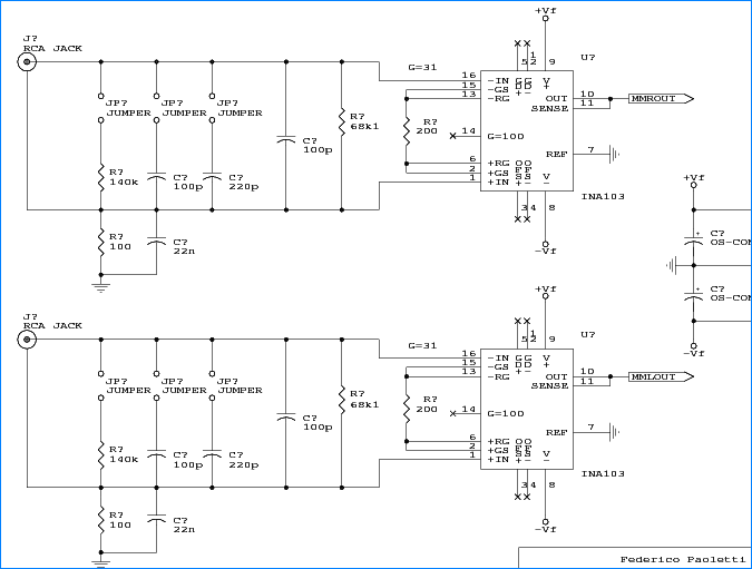

On a different note a very good and simple phono stage, working with both MM and MC carts can be build using the ancient INA103.
I've had good experience with this circuit
this circuit
More amplifiers from Federico Paoletti
.. Bellini Puccini Donizetti .. all amplifiers of brand Audio Analogue
Here are some more ideas and circuits from him, at his projects page:
http://www.pi.infn.it/~federico/further.htm
I have attached the Paoletti INA103 MM-phono circuit.
lineup
lineup
This is only the linear input stage. It's followed by a passive network and an opamp.
